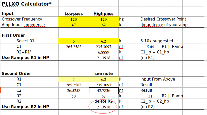

Old thread but it seemed better to add here than start a new one. Using the PLLXO calc spreadsheet to do a 2nd order high pass filter at 120Hz into 62k amp impedance here is what I get(screenshot attached).
R1 = 6.2k
R2 = 62k
C1 = 235nf
However I am unsure on the value for C2, is it 42nf or 21nf with Ramp as R2? Looks like 21nf with just Ramp but don't see C2 called out specifically on that row.

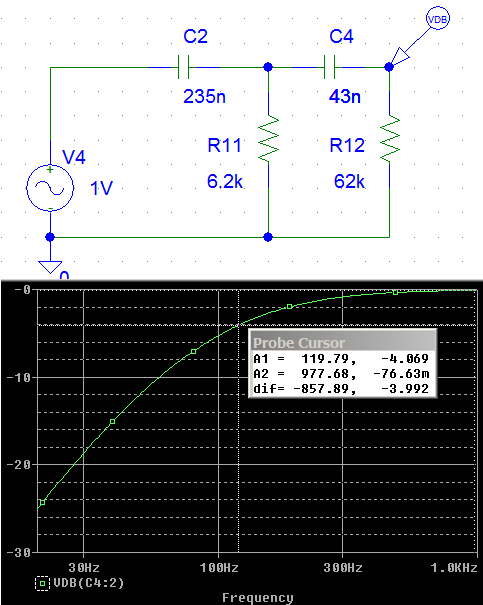

It appears to be:
preamp
235nF series
6.2k shunt
43nF series
62k shunt (amplifier Zin)
However this sims as -4dB @120Hz. And you would expect a 10-fold relation between caps. (Making the first cap 430n gives -3dB @ 100Hz.)

Thank you for the sim. Any reason not to follow the 10-fold rule? My target was 120Hz for the highpass.

Not sure if that reply was for me. I am using the spreadsheet to calculate a 2nd order PLLXO using Ramp as the total value for R2. Goal is to rolloff a fullrange speaker to integrate with a sub at 120Hz. Just was not sure how to read the spreadsheet to get the value of C2 for R2 = Ramp.

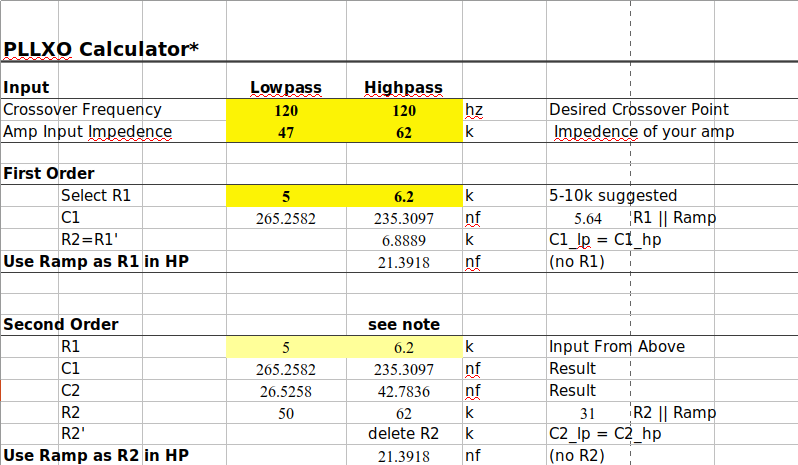

Yes, 4" mains supplemented by a 12" sub. I have a 1st order PLLXO now at 120Hz before an ACA for the FF105WKs. Going to build a different amp with higher input impedance so I thought I would try a 2nd order PLLXO to see how it works, ideally I wanted to combine that with a BSC at line level if possible. It's a move from 8 watts to 27 watts so nothing crazy and even with 8 watts I don't lack for volume.
Ultimately this is DIY so I guess I might as well have fun and spend the $10 to try both a 1st and 2nd order PLLXO along with a BSC. Still curious how to read that spreadsheet. If the calculated value for C2 is 43nf when using Ramp as R2 then what is the row labeled "Use Ramp as R2 in HP" with a value of 21nf telling me?
