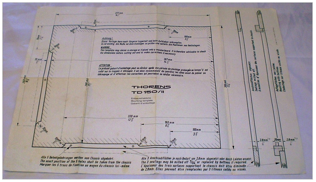

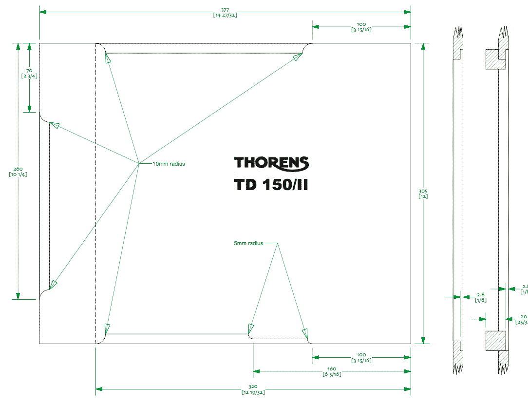

...someone else will need to translate the relavent German notes....
It is a Rosetta Stone. Same words in different languages. Here's the English for your copy/paste. (Of course if you can bind titus2002's image into your PDF, French and Germans can squint their words.)
WARNING
This template may shrink in storage or if glued onto a wooden board. It is therefore advisable to check the dimensions before cutting out and to make corrections if necessary.
THORENS
TD150/II
Mounting template
The exact position of the 5 holes shall be taken from the chassis
The 3 seatings may be milled off 7/64" (2,8mm) or replaced by battens if required.
(sideways)
Seatings milled off.
Mounting with battens.
