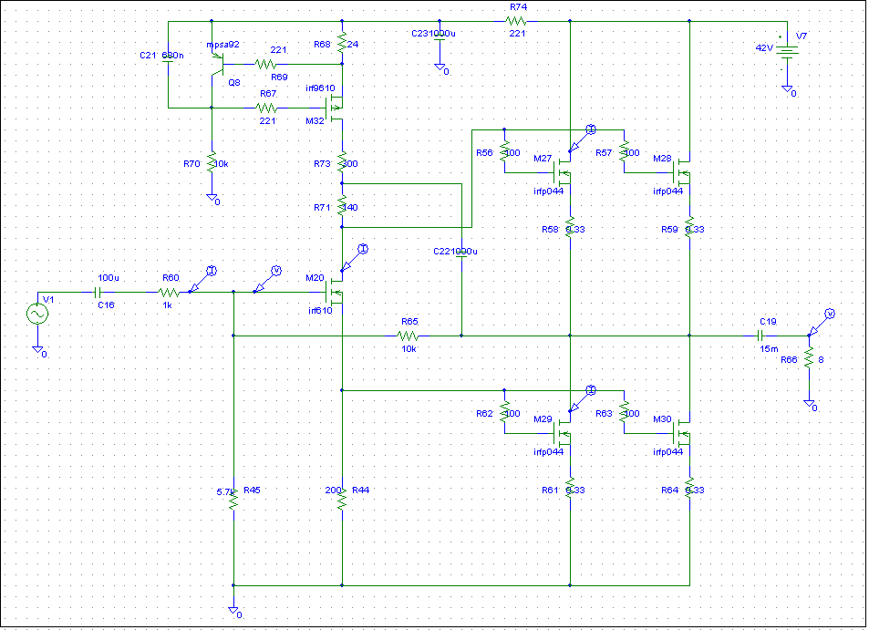

So, I gave the CCS a shot...
Would something like this work?
(Bias current 1.4A, DF=4.3, Bias current through Q1 (Nelsons schematic) = 21mA)
Any feedback much appreciated!
/Niclas

I dont think you need R71, R73 and C22.
That is the parts that create the bootstraping in order to make the resistors behave more like a CCS.
Since you have a true CCS you can safely do without them.
To me it seem like a sound circuit.🙂
I hope Mr Pass approves it to.
Cheers, Johannes.

Thanks for the comments Johannes!
I thought about removal of the bootstrap and its resistors, but this left me with no option of altering the gain ratio of the power MOSFETs (as per Nelsons article). Also, some resistance is necessary above Q1 in order to bring the quintesent voltage at the output to something approching 21V (42V rail in my case). Do you have any other solution to how this can be done?
Seeing as how we live in the same city... How about you build a JFET version and we can compare results?!
You can simply connect the Drain of Q1 to the output through
the capacitor and a potentiometer (or fixed resistor).
There is only one drawback to the CCS on this circuit without
a bootstrap, and that is that the bootstrap can be made to
swing beyond the rail, driving the + transistor to saturation.
In this way you can typically pick 6 volts or so of swing.
It's not trivial to use the CCS and bootstrap together, because
your typical CCS will distort when the bootstrap drives it to within
a volt or two of the positive rail.
Thanks Nelson, I'll try the cap and pot!

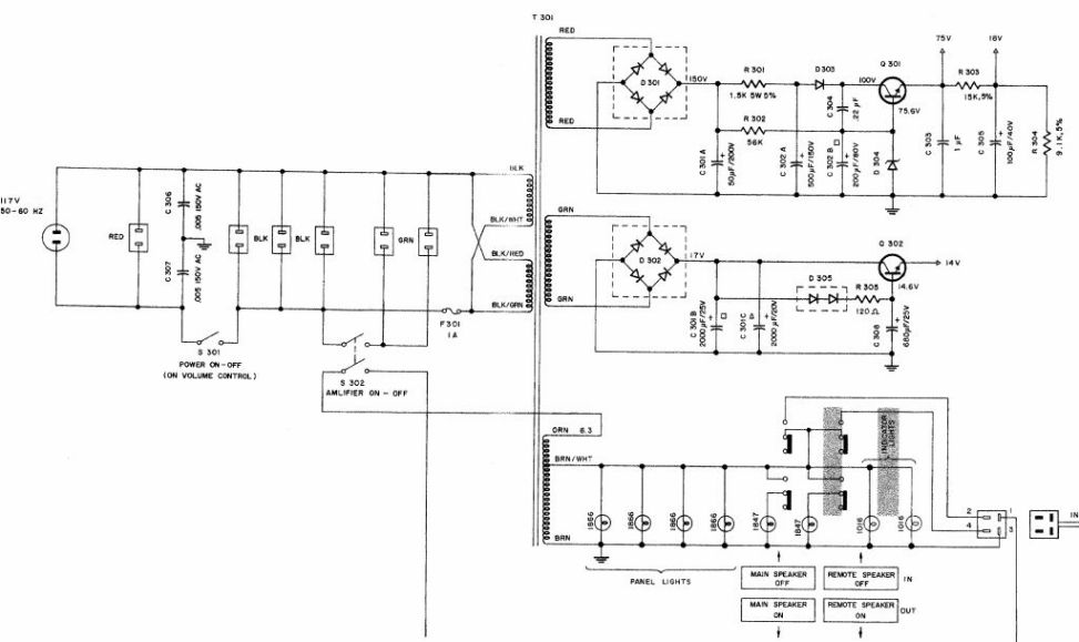

PLH with bipolar tr
hi Nelson and all,
I am half way modifying my Mcintosh C-28 head phone amplifier to drive Altec 755A. With all capacitors replace esp the input cap using the Russian green PIO, removing the regulated power supply to have a B+ of 17V etc, the sound is decent, though I still prefer my ECC803S-2A3C amp.
The circuit is PNP input driving a darlington NPN with an NPN TO220 output. DIagram attached.
Is it possible to have the PLH in bipolar equivelent? perhaps with less then 1A bias and a PS of 17V. My speakers could play v loud as it is with the mere 3 W or so and I need to run it cool as in the morning my room is quite hot with Singaporean sun shine...!
Tks and best rgds
William Lee

C 28 regulated PS
The Mac C 28 P transformer is robust and could supply lots of power... I might eventually add the 12V secondary for the head phone amp with the 6.3V secondary for the lamp to get bigger output, but of course I need to use TO 3 bipolar such as MJ 15003 with heat sink.... I suspect the 13.5V winding is good for 5 A though only rated for 2A, while the 6.3 V is rated for 4.5A but definately more, as after long use the PT is barely warm...
Best rgds
William Lee
