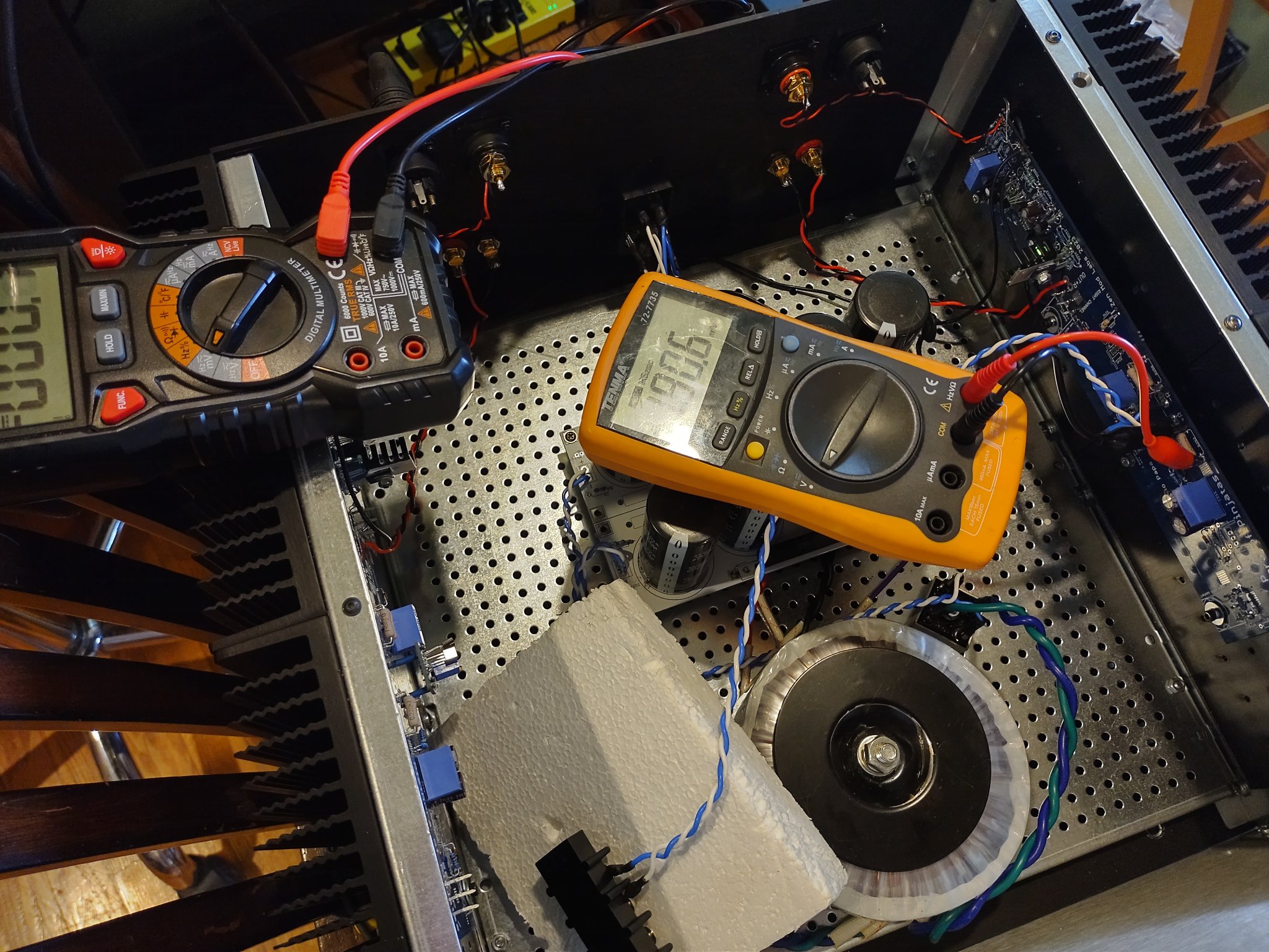

Whoa. When closed JP, offset jumped from 15 mV to 150mV! At 2.8mV right now, little more warming, Open JP, hopefully nothing untoward happens!
Remove JP all is good bias to 172mV, offset .3 mV. Go full bias in few moments, on to channel 2. More coffee.
same as with XA 252, checking offset with jumper open; practically you can't even influence (significantly) offset when jumper is open
when everything is in ballpark, close jumper, set DC Offset, and that's it
Playing music. Left channel will only bias to 181 mV and I am out of pot turns. Other channel is at 189, I think it will go higher.
Do I need new pot on low channel? Resistor change?
Guess I could have misinstalled a resistor, but both channel appear to be the same part location wise. Sounds fine, want to bias to max of 198 mV!
replace R126/226 with 1K2
or just solder 5K6 or 6K2 on top of existing (1K5) ones

btw. you'll not hear difference between 180mV and 198mV; that's damn Pure Square Law OS

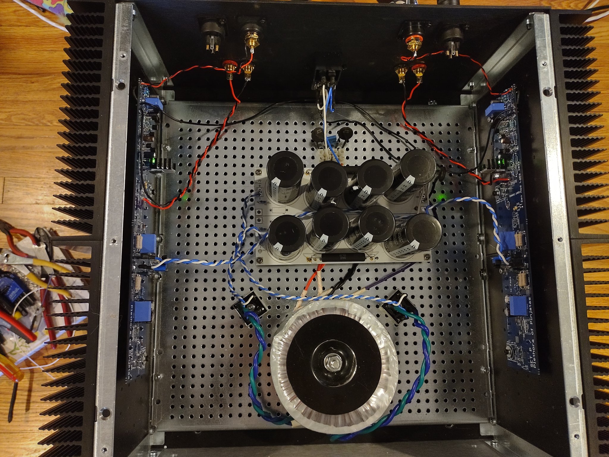

Mild hickup, hooked up to XSD speaker, playing fine, then cut off. No smoke or stink.
Leds on boards off. Switched amp off, unplugged, check source, pre etc. plugged power amp back in, turns on led both lit, but a bit paranoid to proceed without asking: What was that?

Both channels. Common ps, lone 300VA. No speaker protection. Fired up, no with music turned off, just amp idling. Offset and bias seem ok
if both channels died, and sole common thing is PSU, go figure
either cable, or IEC, or switch, or fuse, or soft start
that it happened after speaker change, sheer coincidence
So one of those things, didn't know if there was protection circuit or no....soft start is cobbled together, but seems solid.
Odd, it turned back on fine and has been running since
