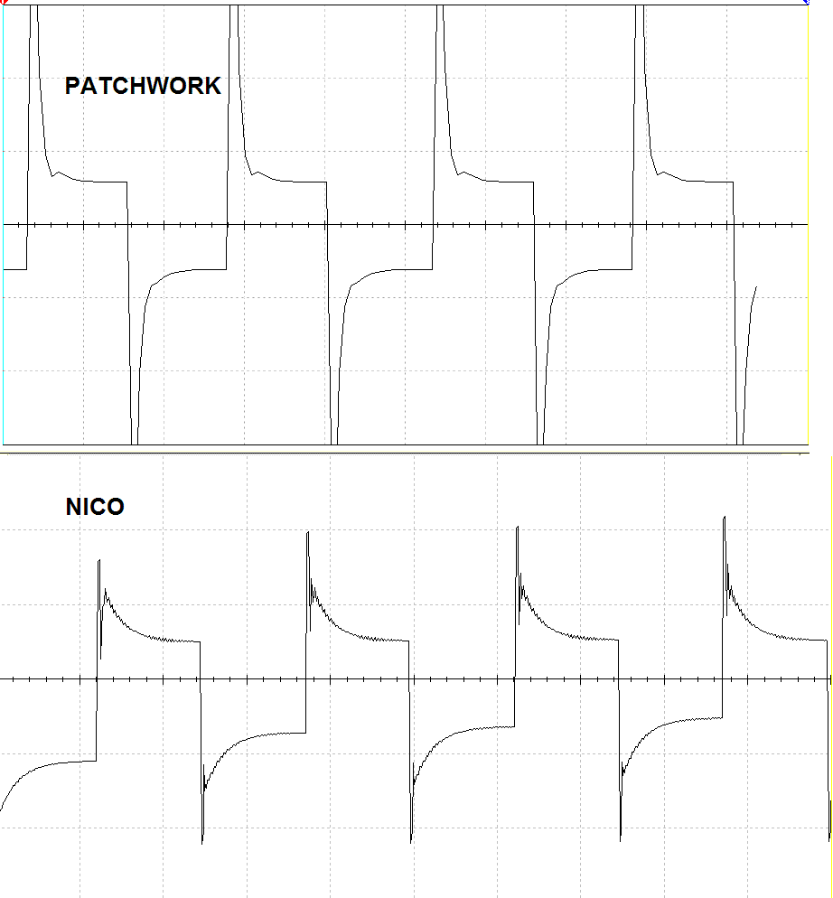

It would appear as if c3 = 15p is optimal and 100pF causes slew limiting. With 15p I get about 20V/uS
Hi Nico,
I didn't see a big decrease in slew rate for that change. I did see better stability through the VAS.
Below, I've attached a shot of an amp I'm working on. This is the output from the LTP with a square wave input at 20KHz. Beneath that is this headphone amp design , with the 15p Miller.
I'm no expert (heck, half the time I don't know what I'm doing), but I have simmed quite a few amps and the better ones show good stability here. I don't know that it makes even a slight difference to the final outcome. I do know that it has no effect on the distortion readings in the sim.

Hi John,
I use silver mica cap for Miller and NFB, it does not have the ringing on the oscilloscope trace as indicated in the graph.

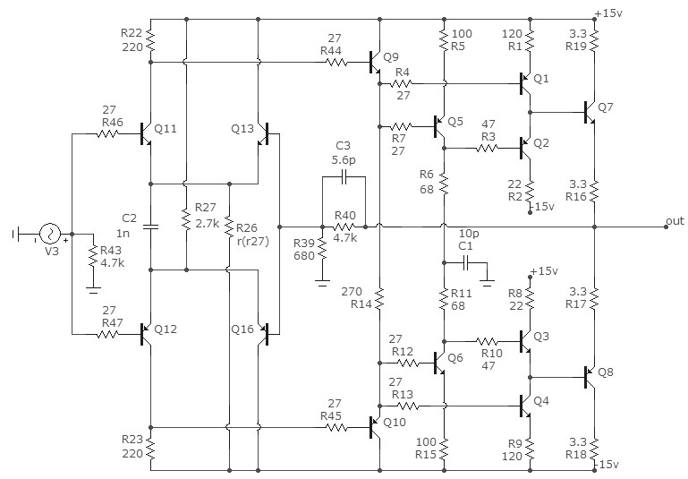

just fooling around a little, it is possible to produce very linear amps.
This one is good for about 2MHz with THD at 1MHz <.001%. Phase linearity is <6 degrees DC - 2 MHz. Amplitude linearity is better than 0.025 dB from DC to 1MHz.
I have some HP transistors with FT=2GHz, that I kept for a really super amp one day. Maybe it is time that I get stuck into it.
The only problem with making super linear amps is that layout becomes critical.

Hi Nico, I'm working on something similar right now, but using a National LME opamp for the front end, and a MOSFET output. Have you tried different current sinks on the output? I'm debating the merits of various designs- something like yours, or just putting a stable 431 regulated voltage on the gate of a MOSFET, or using the 431 for feedback off the sense resistor per the TI app note, or using an opamp to monitor and feed back off the sense resistor. Right now my simple "voltage on a FET" method is good for about 0.3% current change during operation (simulated). Do you have any thoughts as to how good the current sink needs to be, and what method might cause the least degradation? Also, what's the thinking behind your C16?
edit- I like your last posted design. I've made bad sounding amps with a Cdom cap, and try to stay with C across the feedback if at all possible, just as you've done. IMO, if the distortion of all types is low enough, it doesn't matter, but I don't always achieve that ;-)

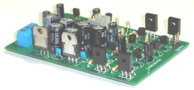

Nico Ras said:
If anyone is interested I will post the PCB Gerber plots.
Hi Nico,
Looking good! You work fast!
Looks like a nice , compact board. I would like the Gerber's, if you don't mind. I would be making my own board for this, and might end up building a couple.
Once again, a beautiful job.
