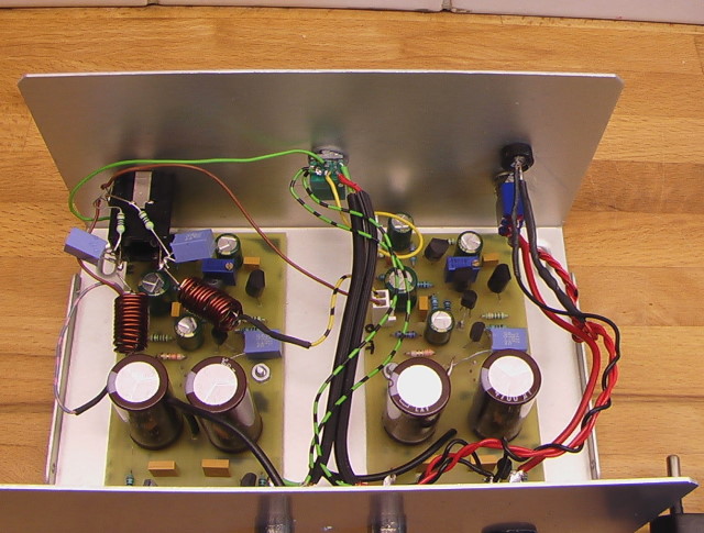

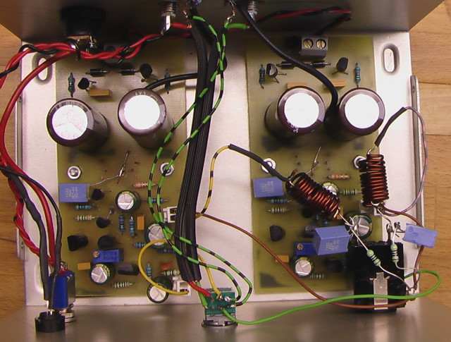

Me and Nico have had a nice conversation offline and he has done a PCB layout just for me. Very very generous :hbeat:
A single side mono version where the BD139's is attached on the solderside with their metalcase in such way that you should mount the card on the bottom of your box, or on the sides. The box could be the heatzink :) (Se pictures further down this post.)

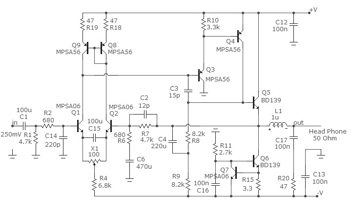

This is the more basic design without the current mirror in the first post. It uses a single supply of 12 V with a virtual earth. Both 32 ohm and 300 ohm phones could be driven.
Nico's Class A rev.7 with virtual earth
I have done some small changes from the schematic.
For 2SC2240 and 2SA970 I use 2SC2632 and 2SA1124. The last two have the data 120V, 0,1A, 0,3W, 100Mhz
For MPSA06 and MPSA56 I use BC639 and BC640.
I didn’t have any 12pF miller caps so I use 10pF. Amp is stable anyway.
I have upped the LTP current a tad. I use 5.6k for R5 and 2.7k for R1.
There was some huge space on the card for C19 and C20 so I upped the lyth's to 4700uF Elna's :)
I have also put C17 back as decoupling for the current source as of the schematic on the first post in this thread.
I have done a fast job with a cheapy, but enough, box for a first attempt to make myself a "Reference 1 unit". :angel:
Here are some pictures to cheer this text mass up a bit :hphones:
The output coil is a DIY coil measured 1.4uH, parallelled with 3.9ohm. The zobel is 470 ohm in serial with 100nF.
The volume knob was in the "knob box" and the volumepot is from a slaughtered carradio (An ALPS pot)

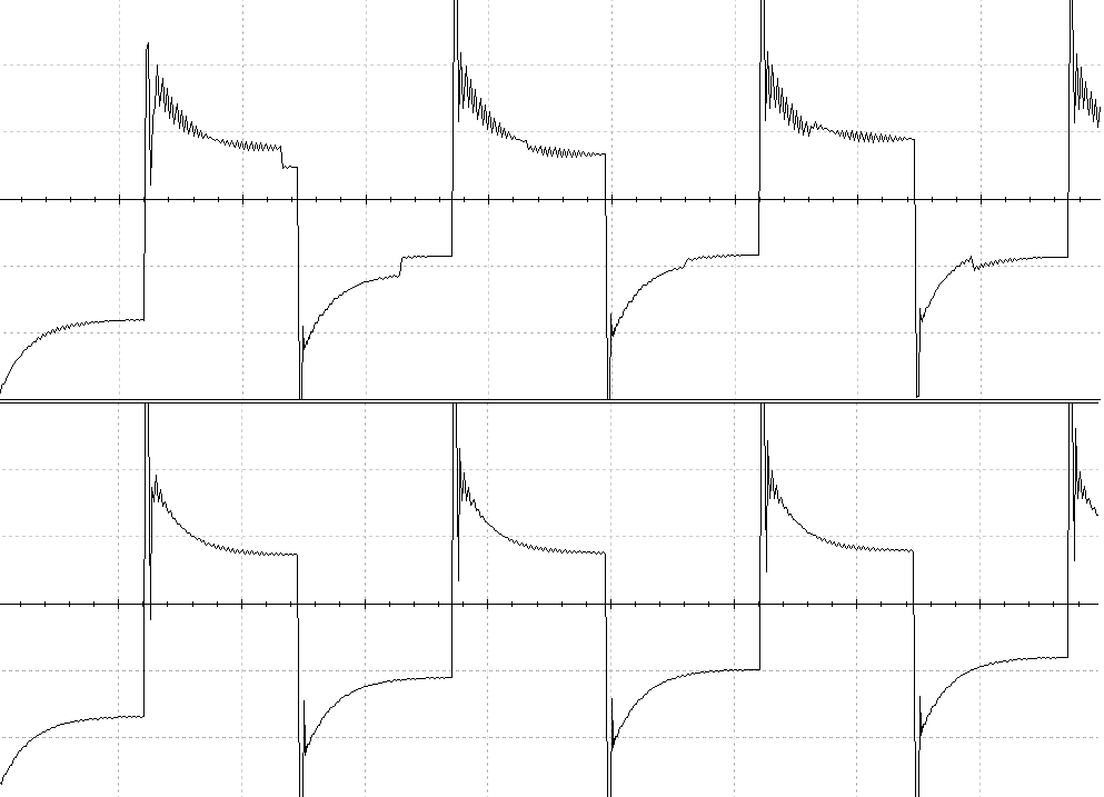

In the simulator (Multisim 10) I have done some measuring though.
3Volt rpm out with 300 ohm load is about 0.045% THD up to 20khhz. At -0.2 dB 100kHz there is 0.1% THD.
The -3dB point (~2.15 VAC RPM) is at 420kHz and gives 1% THD.
Squarevawe at 100kHz looks about the same as in the real world on my old Tectronix 912. :cool:
I gave wrong numbers from the simulator. The THD values above was with the miller cap and feedbackcap at 47pF. I actually have just 10pF so the THD at 100khz is the same as 10khz in the simulator, around 0.044% ! I get the minus 1dB at 260kHz and 0.1% THD !
I will test the -3dB powerbandwith live and also do some RMAA software/PC cardstest. The live THD figures would be great fun to measure.
I will also change the decoupling caps I used. It's nothing I can hear but I have measured them with my new hefty LCR meter and they are not the best ones. Higher inductance and losses if I compare with others I have at hand. I'll change it so that I can sleep well and get that trifle out of my system :cloud9:
As for the schematic I will not change it. I have just used other transistors because I couldn't get Nico's variant easy. I don't think it does that much. The only change is the two resistor values around the diffamp. I just had to test slightly better slewrate and also, I don't like when transistors starve current, under 1mA each.
From the beginning I had to small resistor in the zobel (only 10 ohm instead of 470, which I have now) I got ugly unsymetric squarewaves at 10kHz with that low value. Maybe I sneaked at a poweramps zobel :xeye:
