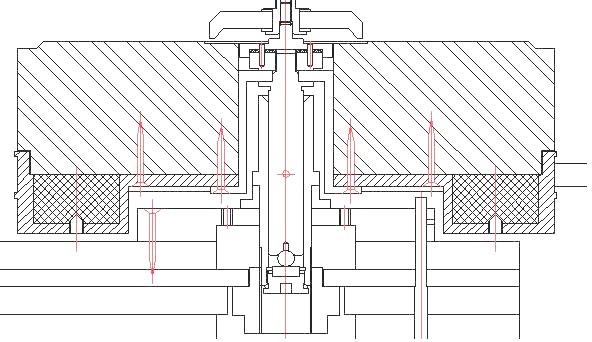

I don't have a means to machine acrylic. I know acrylic needs to be machined with diamond bits and I don't have access to them.harwoodspark said:I was faced with this dilemma I would machine the base from aluminium and the platter from acrylic. Just clamp the record straight to the acrylic and away you go. This is only my personal opinion. I feel that acrylic has a good synergy (for want of a better word) with vinyl.

kilowattski said:I don't have a means to machine acrylic. I know acrylic needs to be machined with diamond bits and I don't have access to them.
Why can't you use the Haas mill mentioned in post #11, acrylic isn't hard to machine.

It's not that simple. I could have gotten a piece of Acrylic for much cheaper than the aluminum. The problem is heat. The vinyl will not machine well with normal machine bits plus it not my shop. My neighbor owns the shop and he frowned at machining plastic.

kilowattski said:The problem is heat. The vinyl will not machine well with normal machine bits plus it not my shop. My neighbor owns the shop and he frowned at machining plastic.
It sounds like he doesn't use coolant. This might explain his reluctance to machine plastics.

Of the materials you've mentioned so far Corian seems to have the most interesting properties. Corian is basically a mineral filled acrylic, it's between vinyl and aluminium in density and in stiffness (though its stiffness is much closer to vinyl than aluminium).

Yes I have and I am serious considering making the doughnut out of Corian. I don't have to machine it. I can do it with a router. I only need material 1/2" thick. It only acts as an interface between the aluminum and the LP. Thanks Jeff.

Platter stability
What Cris Brady's platter/bearing design is trying to achieve is placing the platter CofG closer to the bearing midpoint, i.e. geometrical center of the journal bearing. This is the only way to minimize adverse effect of the belt tension and platter rocking. It is completely irrelevant, where the ball is located (conventional or inverted bearing).
Teres design moves the bearing center closer to the platter CofG, but the ultimate goal (both of them are in the same point) is still not achived. I just want to note, that it is not feasible for single-material platter. If you want to keep reasonable platter thickness, you have to make the lower part of the platter much heavier, than the upper part (or use short bearing - no go). Put your ballast under waterline, just as shipbuilders do.
I'm currently working on wooden top and lead shot loaded Alu bottom platter, which has the bearing center, platter CofG and belt plane perfectly coinscided.

Since you got the Teres bearing, you should work from your bearing up. Use the KISS principle. There is so much documentation on the Teres. The bearing is the heart of your TT. They have a recommended lube. The lube will work best with certain range loads and temps. Too heavy/light a platter will cause you problems. The aluminum will suck the heat out of the bearing. But, that should be within the range of the lube. Then again, worth checking out. Just in case there is a "magic" temp or weight. IIRC they use arcylic and Cocobolo. Bearing break-in is crucial, I'd find out what the Teres guys do. The lead shot should be loaded from the bottom of the platter, just like the Teres. Did I say you should make a Teres?😉. Other than that, I don't know nuttin', don't have a Teres.

Actually Secips has a point there.
Teres does load the shot from the bottom - maybe to help keep the CoG lower. I can't see it making that much difference in the overall scheme of things.
Dexron II is what Teres recommends I think. Having said that I have some 5W30 in mine at the mo.

Thats pretty much what I did do. I am a novice and going into this did a bunch of research. I felt real comfortable with aluminum because the Redpoint bearing is very similar to the Teres bearing and almost interchangeable with the Teres bearing. The reason I chose to model mine after Redpoint is because of the similarities between the Teres and Redpoint. As a matter of fact Peter Clark the Redpoint Turntable Designer was a participant in the original Teres Build. Another reason I chose to model mine after Redpoint is because I have no experience building a suspension so I decided on a High Mass design. I would bet that the Teres Platter has the shot loaded from the bottom is because they want a flat and solid surface for the vinyl to contact instead of having unsightly screw-in plugs face the top. I hope to have multiple arms and by using multiple well damped arm pods, I can easily achieve that. Once the table is built, I can also experiment with different platter designs with too much trouble because the rest of the table does not have to change.
