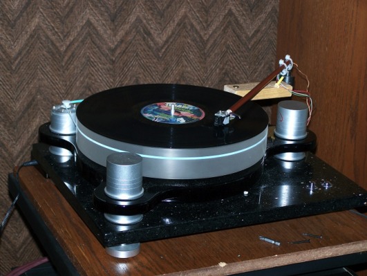

Please review my design
kilowattski said:
Thanks guys for your comments.
Vinyl Addict:
It is funny how a number of responders have opposing view points. You think it will be like a bell and Mark Kelly thinks it will be too dead. I am modeling my turntable after a successful commercial table, the Redpoint Model D. I have auditioned one of them and to my ears it is audio nirvana. If you get a chance go to their page at http://redpoint-audio-design.com/index.html. Peter Clark the designer of the Redpoint was an original Teres Builder and went on to refine the design and started Redpoint. The Model D is $19,500 and I don't have that type of scratch so I am building one.
I should clarify that aluminum by itself (without damping) will ring. I'm not sure what you're referring to.
I met Peter in California a few years ago when he was basically touring with his turntable. He showed up at a local audio club and I spoke with him and also listened to his turntable.
kilowattski said:
I read quite the opposite and I guess Fran did also. We read there was very little wear after a year of use with the Teres bearing. The bearing shaft is case hardened steel. I don't know where you got your info from.
I will find the webpage of the person who did an extensive inspection of his Teres bearing. Anyway, the Teres website states that the bearing is machined from stainless steel and I do not believe the shaft is hardened.

Machining wheels on a vertical mill is something quite different than turning the O.D. of a platter where the surface is super sensitive to "roundness and concentricity, at least that is my belief.
kilowattski said:
I tried machining a Plinth on my first attempt with normal machine bits and had melting problems with the plastic because of the heat. When I tried coolant, it discolored the acrylic. I would love to see how you do it.
It's simple, believe me. As I said, I machine acrylic and many other performance plastics on a consistent basis, Delrin, ABS, Polyimide, etc. It's a large part of my business.
Have your machinist friend show you. 😉
On some points we will agree to disagree. I had always planned on turning the outside of the turntable but only after the machining is done. I don't understand why you put down a proven design like the Redpoint. I don't want to build anything that will require a suspension so I have ruled out a lightweight mass design. I have done alot of research on this. The proof is in the sound. If you lived close to Long Island I would invite you over for a couple beers and a listen.
As I said my first attempt at this was maching a block of acrylic on my home milling machine using a rotary table, maybe it was not the right way to do things but at the time thats all I had at my disposal. I will take your word on this as you are a machinist and I am only a amatuer.
I already have the Teres bearing so I will use it. If it fails I will look to maybe get a Sheu Bearing. I do stand corrected though. It is stainless not hardened. You are absolutely right.

I would like to balance the platter some how when it is done. I could add shot in some spots and take away in others. Do you have any suggestions on balancing the platter.
Balancing is relatively easy:
Machine out the holes equally around the platter. Drill each one to the same depth. Then fill one with the lead shot - leaving enough room for the teflon etc to go on top. Then take out the lead shot and weigh it. Add the same amount +/- 1g for each of the other holes.
If you then want to be super precise and balance it further, I would imagine you would need some kind of jig to hold the platter but yet allow it to turn very freely. Give it a spin then let it settle. A small amount can be removed by drilling say a 6mm rebate at the heavy side.
In reality though, if the block is machined true on a lathe, and you add the same amount +/- 1g I think it would be good enough.
Remember - Teres does this but using wood which does vary somewhat in density (although cocobolo doesn't vary that much). A couple of grams here or there isn't going to make that much difference.
Fran
platter balance.
1) A method which we have used to good effect is to make a plug for the centre hole in the platter and accurately drill that plug with a small dia. drill. then suspend the platter on about 3' of chord (which attaches at the dead centre!) In your case you could hang the platter upside down and simply add/subtract lead until the platter hangs horizontal in all planes.
2) for a record interface mat we have tried everything possible and found that - in our opinion - the purest fine grain graphite is without doubt the best material. In fact we have built TTs using this material for the entire platter ( excluding a brass drive rim.) The deeper the carbon the better. I am talking pure graphite - not a graphite based composite.
