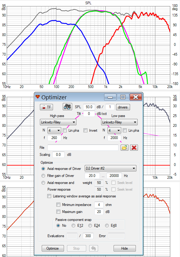

Vituixcad has a target slope tool. It is difficult to learn but it is useful.
