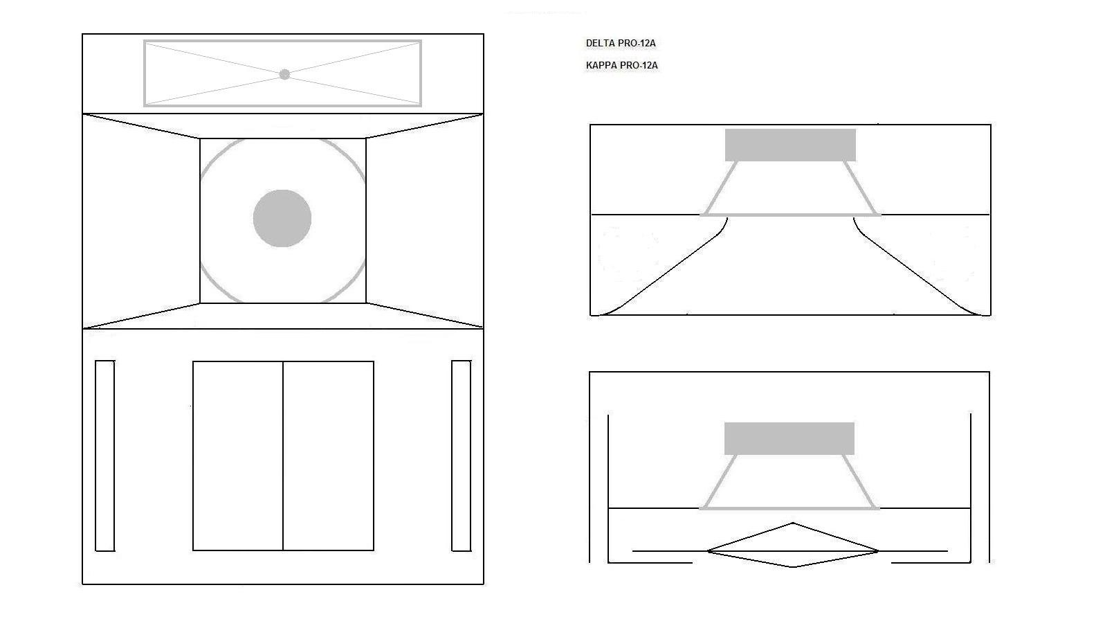

This is so far just mindwork, and not tested
it is calculated tho, and matches drivers
its relatively cheap
though intended for bass guitar, I thought with a tweeter horn on top it might be a nice PA/party speaker too

Yeah, that is a nice one. I don't mind a complicated build as I have a CNC router.
Budget is pretty open, but I would lean towards lowest possible. I mostly enjoy the building.
Ah, of course you have the CNC so that top cab build will be a lot simpler for you. Also, the slightly elevated 60-150Hz band of that design should be appealing for your music tastes, but it really will be massively over $1000 now I think about it.
