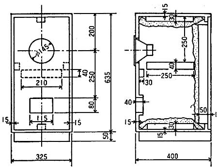

With your initial requirement of 40 l maximum, I think you will be limited to one driver per enclosure. There are two versions of this 6.5" ferrite magnet driver offered, plus one more (at least) in alnico. These drivers have moderate in between specifications, and could potentially be used in a bass reflex, TQWT or ML-TL. As you get closer to choosing, I'm sure someone could help you with a cabinet design.
i'm adding myself to the group advicing L.Cao F6.
recently i finished a pair of them in a big BR box, the old plan suggested for their predecessors Diatone P610. I built them for a friend, reading good things about the drivers.. i'm not a fan of bassreflex enclosures but it was a simple and well known construction.. and in the end i liked it much more than i expected. i used very little damping combined with a 'tozawa resonator' hanging in the center-axis, thanks to the bigger dimensions the sound wasn't choked and because of minimal damping (but more diffusion) bass wasn't muddy. the drivers are small but don't force them into a smaller enclosure, they shine when they have a space to breath in.
