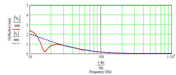

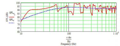

Thank you so much, that last chart explains a lot. It shows exactly what I am hearing, right down to the EXACT location of the peaks and nulls. It shows very clearly that just a bit of stuffing would even out the response to almost perfectly flat up to around 100 hz. It shows why my crossover point at 40 hz clears up the first problem peak, and why the peak just after 100 hz is so hard to tame, no matter where the crossover is set.
There is a surprise for me too. I was completely expecting to see a nice bump around the tuning frequency, which is clearly not there in the graph. The only way I can reconcile the graph and what I hear is this explanation. I set up the sub position and listening position to boost 16 hz as much as possible. There are other spots in the room that are much louder higher in the audio spectrum but my whole setup is based on getting the most out of the bottom end.
So now the question is this. Is the couple of extra hz extention in the bottom end worth the couple of db loss? (By changing the design to tapered.) I really don't know. But it did seem to tame the upper harmonics nicely (on paper at least).
And the other question would be - Did the transflex/Danley loading method help? Without an SPL meter or previous tl experience I can't answer that one either. Sorry.

EDIT TO THE ABOVE POST (it won't let me edit this one for some reason).
"It shows very clearly that just a bit of stuffing would even out the response to almost perfectly flat up to around 100 hz." - WITH ROOM GAIN AND CORNER LOADING TAKEN INTO CONSIDERATION.
There's not much truth to that statement the way it was UNLESS room gain and corner loading are added to the sub's response.

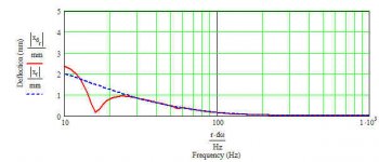

I've been wondering for days now if my excursion problem is to be expected or if something has gone wrong somewhere. After all, I am blasting a 16 hz sinewave with only one driver with 10 mil xmax (and exceeding xmax with under 100 watts).
So can someone answer this one for me? Have I messed something up or is low power handling to be expected at these frequencies?

On the other hand you are pushing 110dB at 16Hz with a single 15" driver! Possibly your movie was giving you significant sub 16Hz energy. The modeling that I have done indicates that driver excursion increases dramatically below the line's -3dB point. A possible approach would be to lengthen the line, increase the taper (or a little of both) to trade off some efficiency in the upper part of the passband for more damping at the extreme low end allowing you to use more power below 16Hz. Yust a thought. Or Just build another one.

16 hz is inside my passband of usable frequencies and as such, I kind of expected it to handle at least a bit closer to the driver's rated power handling. It is plenty loud enough in the medium/small room that it is in - but - the TOP can handle gobs more power and the tuning frequency is not that much higher than mine. I just wonder if this is normal operating procedure for a tl of this size and tuning. Maybe it is pointless to expect any more with only 10 mil xmax.
My options do not include changing the pipe length or taper, those are fixed. I can, however, mass load to get lower. But that will afford me even less sensitivity and even larger xmax problems down lower I think. The other option is to reverse the taper by opening the closed end and closing the open end. I believe this option would increase sensitivity to about 95 db and reduce excursion, as the tuning would change to around 22 or 23 hz. Unfortunately, this would end it's short career as an HT sub and turn it into a music sub that is much louder than I need it to be.
So I guess what I am asking is a two part question.
1. If you look at the last graph GM posted above and keep in mind that it is excursion limited at under 100 watts at 16 hz, is it decent, mediocre, or just plain bad performance for a tl? Comparing to the TOP mine doesn't seem too special, but then the TOP is not your typical tl either. I've seen lots of tl FR charts, but have no idea what to expect as far as excursion goes.
2. Any suggestions on where I should or could go from here? Or maybe leave it alone? Mike, those are good suggestions but neither is possible. The line length and geometry can't be changed. The driver offset is fixed at 25% but could be traditionally loaded outside the box on either side, depending if I keep the decreasing taper or reverse it. Mass loading is a complete unknown for me, other than I know it will lower tuning. I tried searching on the subject and gets loads of info but none of it has anything to do with tl's.
Just looking for ideas or opinions, thanks guys.

To get the most out of the bottom end requires the vent to load a corner's apex, though down really low, most room's construction become increasingly house shaking transparent with decreasing frequency instead of increasing gain, hence the low power handling at Fp and below.
FWIW, if I have a clue, the driver is at the wrong point along the pipe for max benefit from TOP loading and reverse tapering (mass loading) such an acoustically 'skinny' pipe ~defeats most/all of the loading gain due to port compression. It's a given that port area needs to be at least = Sd.
The driver will be too close to the terminus if you swap ends. A lower Q driver will have more peaking at Fp to offset the room's apparent lack of gain, but the octave above it will suffer even more from lack of pipe gain than it already does.
I have issues with Hornresp also, though it's great for folks who know little/nothing about horns since it has a pretty decent designer. MJK's WSs OTOH are as easy as falling off a log and his Classic TL tables are good enough that many folks will be pleased with their performance without further tweaking.

You can easily change your taper. Just block the terminus and open up the larger side, then flip the polarity on your connection to the amp. Then you have a tapped horn, which I don't think you have with your current decreasing CSA. That may also help your excursion problem to some extent, and at least you'll be alot closer to the Tower Of Power (TOP) design of Danley.

Excursion increases 4x/octave with decreasing frequency, so you run out of excursion quickly with increasing power down low if there's not much room gain. At/around Fb though, power handling is a function of how well the driver is damped by the cab:

GM - I'm not familiar with graphs displaying this information, I've probably seen lots of them but paid little attention because I didn't know what they were trying to tell me. That being said, I assume the blue line is regular excursion and the red is the box's influence on excursion. If this is true, it would seem to me that the box is providing plenty of damping to the driver at 16 hz, but without anything to compare it to I don't know if it is as good as it seems.
Also, I got a hint of this with your second last post, and the idea was cemented in my head with this one. I had always thought in terms of how a driver was loading a room, but it never occurred to me to think about how the room loads the driver. So the answer to all my problems may not be anything to do with the box - it may be my lack of 1 foot thick cement lining in my room. It is fascinating to think that the concrete corner is not only a better amplifier, but also loads the driver to afford higher power handling. I wonder how that bit of interior decorating will go over...
So in retrospect it looks like my amp is lying to me, and it appears that even with my last minute changes in design I have come up with a tl with decent specs, although it is not lucky enough to have gained any of the benefits of a tapped horn. I will be reversing the taper sooner or later, to see if I can gain the tapped advantages, and also so I can stand it up again. It did not sound good with the terminus firing into the ceiling 4 inches overhead so I had to lay it down. If I port through the front instead of the end, I can stand it up and fire into the floor corner instead.
But before I do that I want to watch some more movies. Also I will experiment with mass loading a bit to see how low it goes before radically raising the tuning with the reverse taper. Thanks again.
The idea that the LED's themselves might be rolling off prematurely. This is something I never thought of but makes perfect sense too. This may explain my previous comments that it appears that 25 hz is getting 10x more power than 16 hz. This is probably why I thought my "as built" graph would have a large spike at tuning, and it clearly did not. I was wondering how 10x could even be possible, but if the source AND the amp's output AND the LED's are all starting to roll off around 30 hz it may explain the LED's visual drop in power while audible output does not drop much, if at all, on the way down to 16 hz.
just a guy said:It is plenty loud enough in the medium/small room that it is in - but - the TOP can handle gobs more power and the tuning frequency is not that much higher than mine.

To compete with the TOP will either require a special driver or multiple sub drivers to increase efficiency/power handling.
1) Down low it's on a par with an equivalent EBS alignment and the latter is smoother higher up and easier to build, so I'm not impressed.
2) Well, heavily mass loading the driver looks promising in general, but will make it work much harder.
Mass loading the cab means to add a vent, which lowers Fp, or add weight to the driver's moving mass (diaphragm), which lowers its efficiency, but not Fp. Anyway, here it is with an added 200 gr (~68.5% increase), which lowers Fs to ~16.2 Hz:

GM, I completely understand what you are saying. I threw my driver into WINISD EBS -3 alignment sim again and (without a meter) can see that it is very close to the performance I am getting in a box the same size (or very close). But like you said, the EBS has much more usable bandwidth, and while it is 6 db quieter with 1w, the extra power handling makes up for that at higher levels of volume/power.
From the last graph, it does not appear that adding weight is something that is going to benefit the low end much, although it is amazing how it smooths everything else out, especially the peaks, but also the gradual boost between 25 and 40 hz. And while "heavily mass loading the driver looks promising in general" it appears that my room is not capable of backing up the sub when tuned that low.
