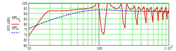

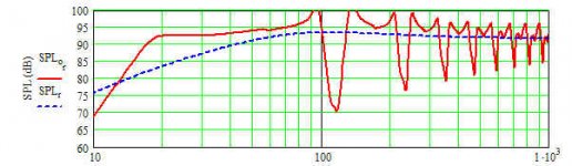

just a guy said:Opinions?
Greets!
Apparently, you've 'fallen through the cracks' since I get 0.88213 and this plot with 0.1 lbs/ft^3 stuffing density:
GM
Thanks for the charts, they are very informative and the Quatro in particular looks very intriguing. Just to be clear, those were both done with a 20 hz line with CSA = 0.88213 x Sd, right?
If this is the case I really need to brush up on my math skills, but at least I was really close on the Quatro.
In any case, the CSA listed above is almost exactly what I had planned and even had the wood cut. The wood got a bit wet but it might be salvaged yet...

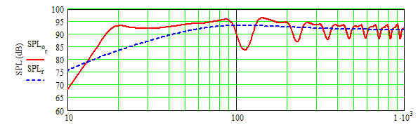

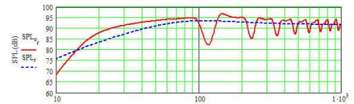

You posted that last graph while I was typing, lol. I like the first Quatro graph a bit better, it extends down to 20 hz a bit more gracefully. So comparing the 2 Quatro graphs, it looks like slightly larger CSA helps out the bottom of the FR graph.
Regarding the second graph, which is the first Quatro graph - corner loading would keep this response flat down to about 18 hz, yes no?
I wasn't expecting 95 db sensitivity from a straight line. I might taper it a bit to mass load and hit 15 hz flat, I can afford to lose a couple db's.

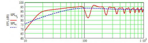

Greets, part deux!
Actually, it looks marginally better at both ends before the 3rd harmonic dip and increasing CSA will increase gain up to a point of diminishing returns. At 2x the S2's alignment CSA, there's considerable gain down low where its needed if the room's construction is 'leaky', like mine.
Boundary loading is room layout, construction dependent, so without actual measurements about all I can say is that typically you get 3-4 dB extra down low instead of the theoretical 6 dB.
Yeah, the driver's high inductance puts a pretty big hump in the midbass and mass loading will lower Fb, but this compromises excursion higher up where you need it more, so 'robbing Peter to pay Paul' might bite you WRT SQ and maybe even driver damage.

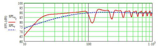

Your interest in my humble project is appreciated. Wow, that last FR chart looks really good, it is very similar to the Dayton Classic 4 Ohm I had modelled for me awhile ago in this line, exept the Classic line was about 6 db down.
I know this is kind of backwards, but I selected my form factor before driver selection. Since the wood is already cut I can't change much but my line is very slightly different than what you modelled. My line is actually 171 inches, not 168 and CSA is about 128 sq inches, or about .97 x Sd. I do not plan to add any stuffing at all. This sub will be crossed over between around 50 - 80 hz so I don't care much about the top end.
I am mainly concerned with LF extension that is at least flat to 20 hz in my room, preferable 3 - 6 db louder at 20 than 80 without equalization.
The slight differences in my line vs what you modelled would probably help the bottom end a bit but probably not enough to satisfy my FR curve desires based on your estimate of 3 or 4 db corner loading and room gain.
I don't really want to start at the beginning and make a box twice as big to accomodate your last FR graph but I also don't want to lose 6 db with the Classic.
It's the old SPL vs LF extension dilemma.
