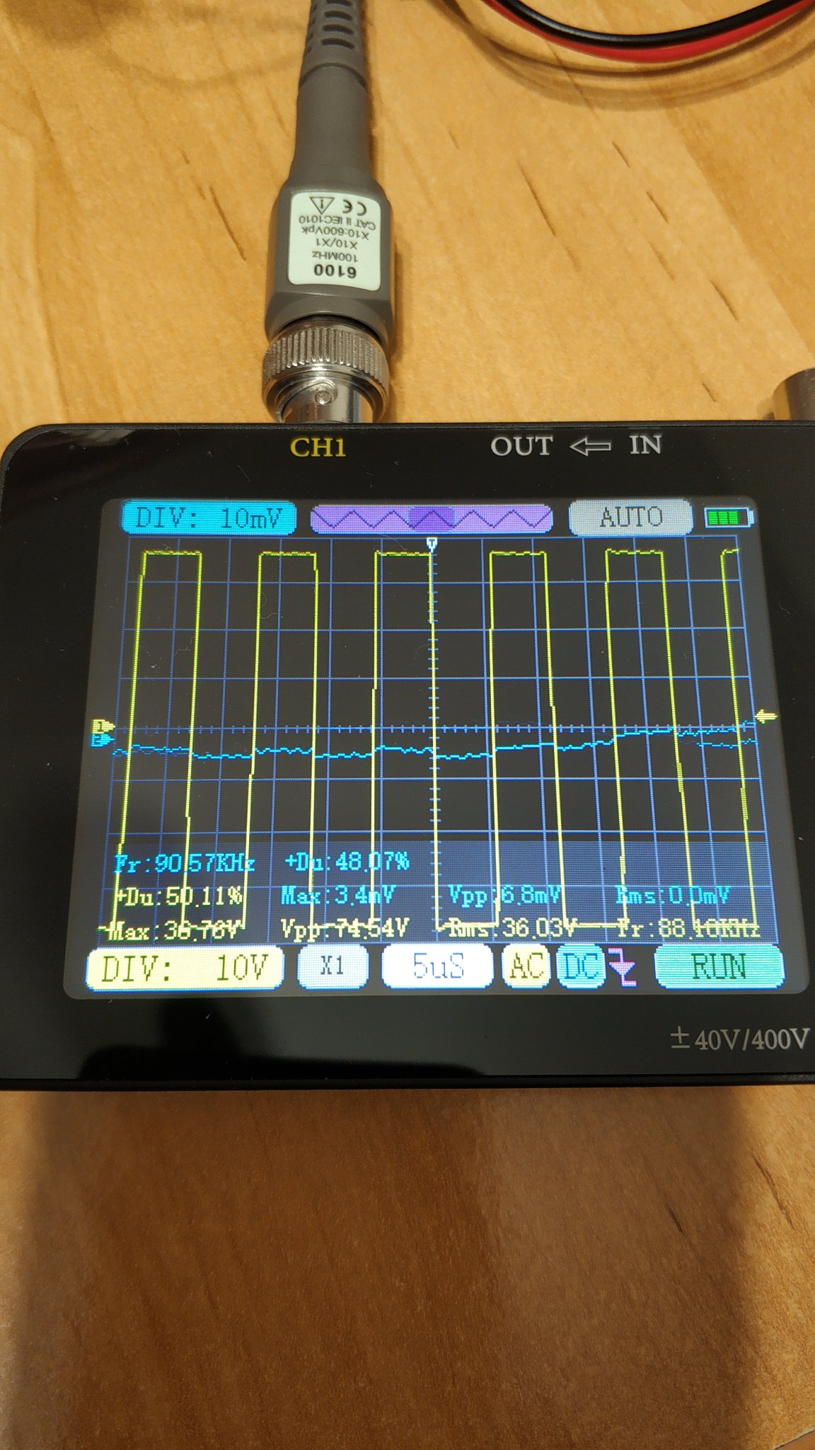

Great! It's not dead anymore but you could still have a power problem. If you have that scope handy, then can we see the Drain voltages of Q208 and Q209? With no input signal, they should be square waves and have amplitudes equal to the rail voltage and be inverses of each other. When you apply an input, the duty cycle should change and the two drains should remain an inverse of each. If they look good at all power levels then the problem is likely somewhere else.

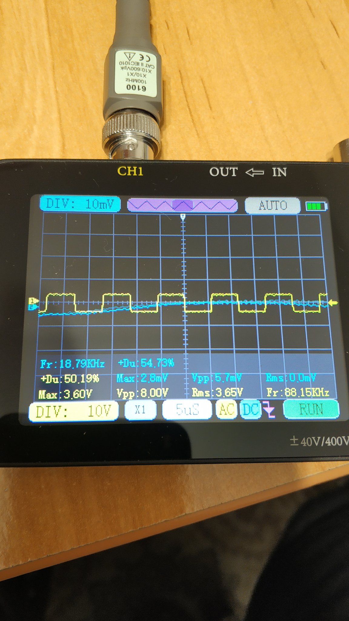

I tested the drain with the oscilloscope, it comes out as a square wave, 10x and 1x images. I didn't understand about the reverse signal, is it necessary to use two tips? this oscilloscope only comes with one tip, but I can get another one.

No. You don''t need to bother with another probe. The drain that you plotted looks fine. If the other drain looks like this drain meaning 50% duty cycle and the same amplitude then your power stage looks good. If you have significant volume then the output stage is working.
I was not able to distinguish between the two drains so I thought I was doing something wrong. The power with the radio module is good.
