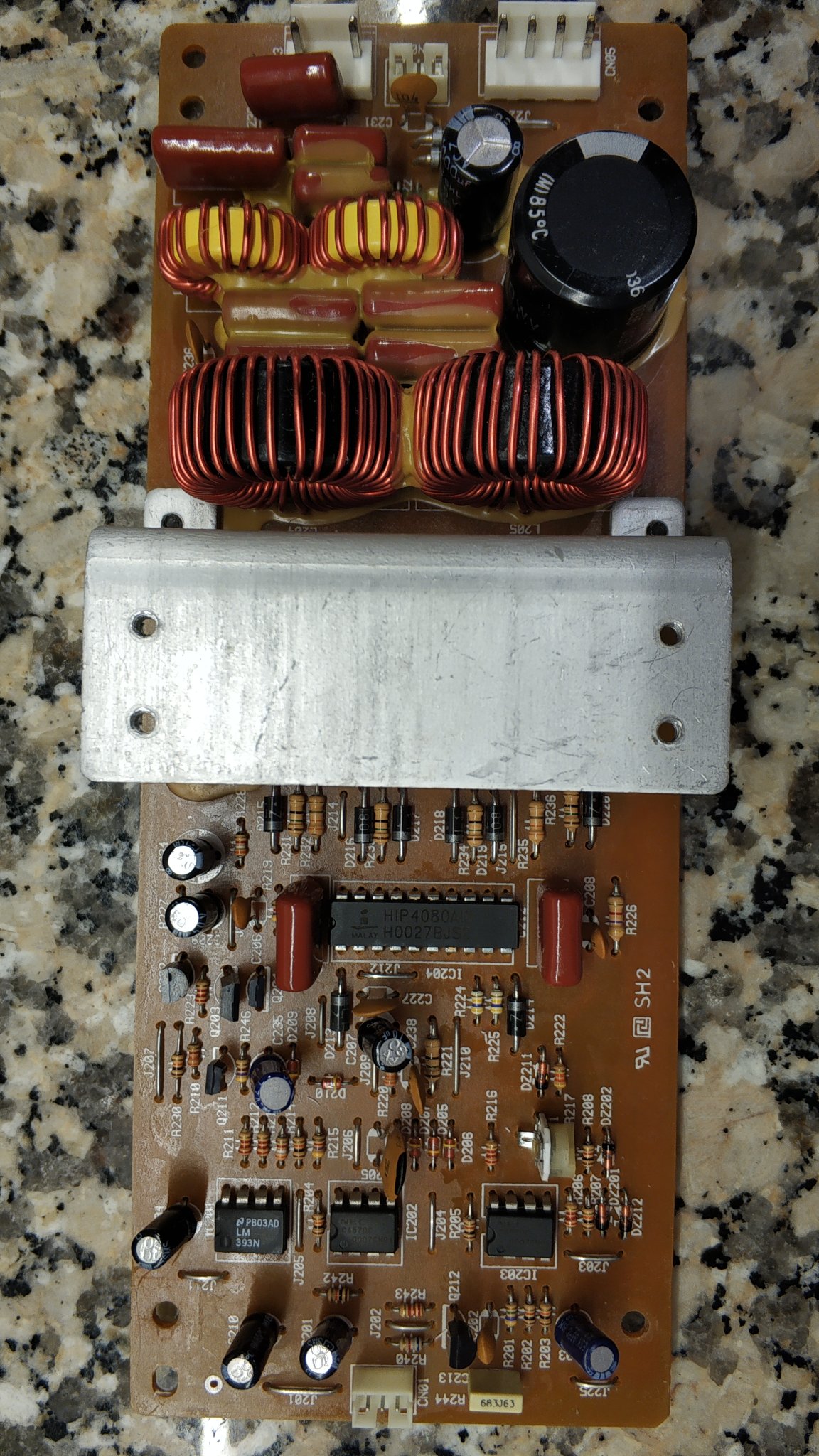

Hi, I've been tinkering with this subwoofer for over a month, and I can't get it to sound right.
I have desoldered about half of the components of the boards and I can not detect what is happening....
It is a Kenwood SW-505D subwoofer. It sounds very distorted, you have to select near full the volume to make it sound something low like a trapped fly...prf prf prf prf prf prf prf
I'm just an amateur without much knowledge, but I think I put my heart into it. I think, that the failure is in this board... any help will be appreciated, thank you!

I would suspect the output FETs or the 4080 driver chip or a component in the output stage. Sound is getting through but it is not being amplified. High voltage and high current components usually fail first. If would be useful to have an oscilloscope to monitor the gate drive of each FET and the drain of each FET. There should be a square wave on each gate and each drain at a high frequency like 100 Khz or higher. You could check the output FETs for shorts with an ohm meter but it is more likely that one or two of the output FETS are open circuited. The switching circuit is part of a feedback loop and that loop can be broken by a support component like a capacitor or a resistor. It may oscillate at a very low or a very high frequency or not at all depending on which component/s have failed.
I was mistaken about all the drains having a square wave on then since this is an all N-channel output stage and some drains are tied to a supply.
Many thanks James, I changed all the mosfets but no noticeable changes, the older seems OK on the handy tester. At night take readings for each pin on them. Will try to order a HIP4080 to try other driver and see what happens, although if it were possible to rule out that this one doesn't work... it would be great

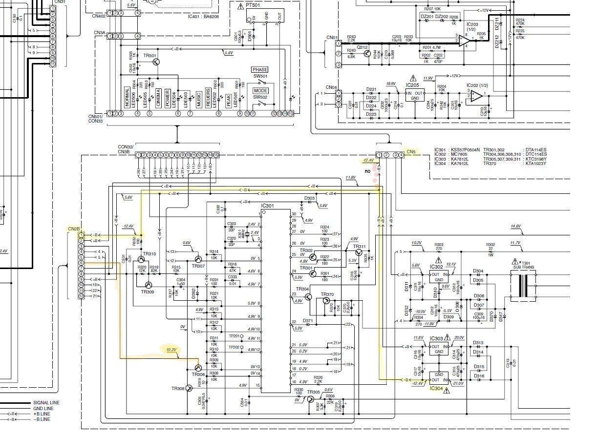

In the other hand, could some one point me to find where is the -12,4v line lost? I don't understand if the -12v is generated at the power supply board or if it comes from the hip8040 board, since there is a power transistor Q203 (KTA1023Y on schema A1275 in place).
On the power supply board appear that the -12,4v goes from the IC304 to the PIN1 of the CN2B and there is -12,4 and also there is a joint that goes to the PIN 1 of CN5, but there isn't, seems to reach Q204 but there are 0v. Also there isn't the 10,2v on the TR306 line, there are around 3,6v... I'm quite lost
Thanks all guys for the answers. The -12v issue... it should be on the pin 4 of the CN5 of the board, and should reach the Q204 (DTA124ES) but there is nothing, it should come from the TR310 (DTC114ES) of the power supply mainboard, there is 0,003v base, 4,987v collector and 0,003v emitter.
On the IC303 I have Input 21,42v, Gate 0v, output 12,11v.
On the IC304 I have Input -21,36v, Gate 0v, output -12,10v.

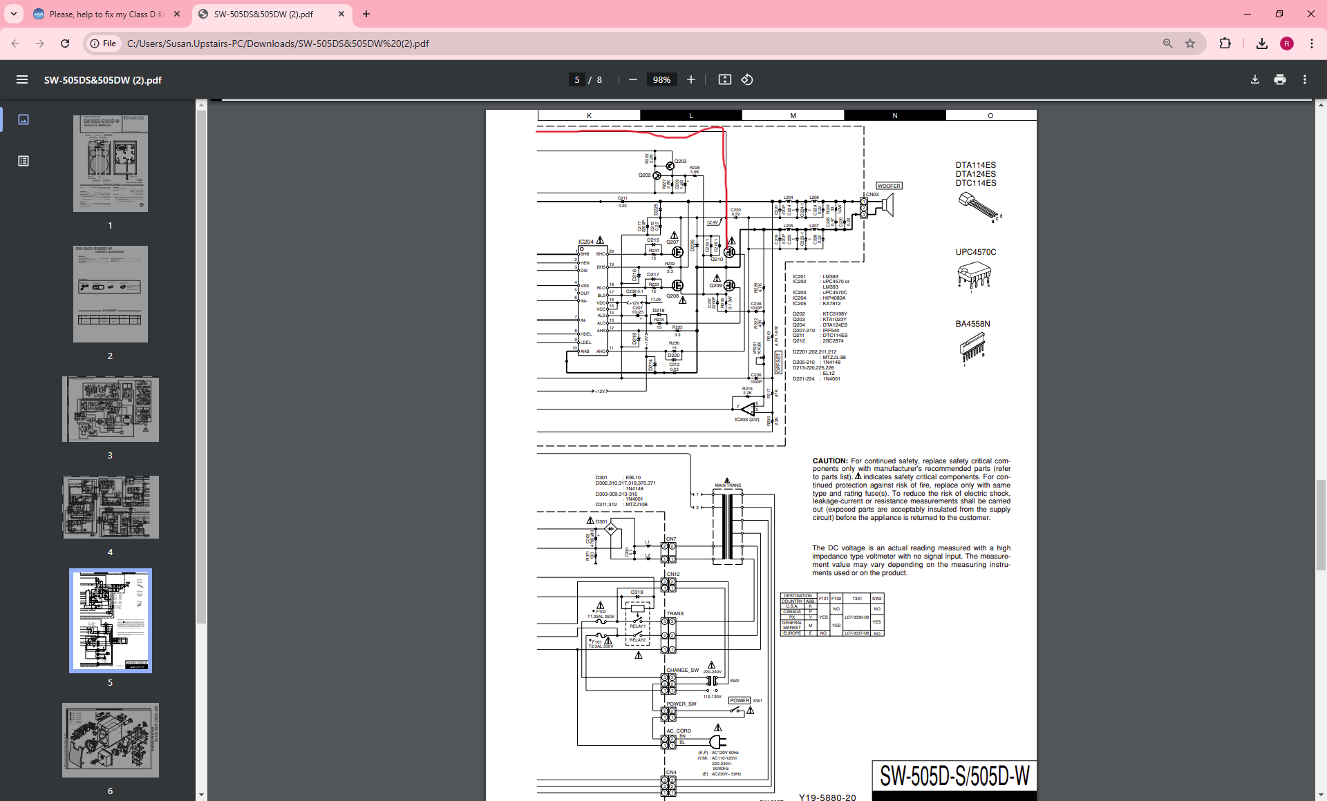

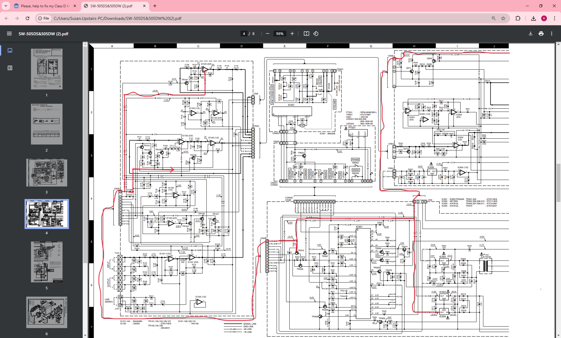

Take a look at the board view schematic at the top of the manual. All chips starting with 2 are on the amplifier/output board. All chips starting with 3 are on the main board. CN5 you have highlighted on your picture is a connector, follow it up to the output board. That is showing, more than likely, a ribbon cable. A lot of the chips want +-12V. Also looks like 2 of the output MOSFET's should be getting -12V, the other two +12V.
See the attached for my partial trace of -12V routes.
