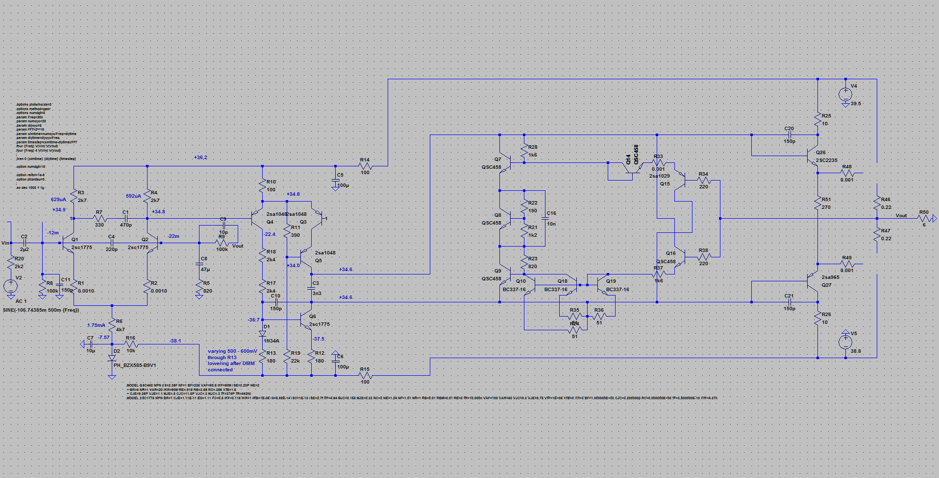

I checked inside, and right OP transistors were burnt. I mounted A1943/C5200 instead but in both channels this time. After powering up I checked the voltage at OP trans bases, it was OK, I set the bias and let it warmed. After 15 minutes I connected the speakers and heard good quality sound of music. Until the first louder drum kick… then the amp smoked right channel OP and drivers trans this time. The left channel remained OK.
The picture from ltspice shows real measured voltages and some calculated currents.
The problems is, that I have +34.6V DC at the bases of the drivers.
I checked all of the parts on the pcb with the probe and it seems that the transistors were OK.
It looks like the current through Q4 is too small.
When measuring the voltages at the basis of Q1, Q2 and Q6 after connecting DVM it slowly lowered what was a bit strange because of high input impedance of DVM...
After some time those fluctuations were visible at right channel amp’s power indicator (-40 dB blinking) what was another mystery without OP transistors mounted…
Do you know what part is suspicious looking at the schematic?

that ltspice sch is not completed. but then again what is inside the super A bias part?
yes, it shows the actual situation, C5200/A1943 are not connected.
good, left channel measures +-1.7 V DC to the drivers while the broken channel +34.6 V DC to both of the drivers

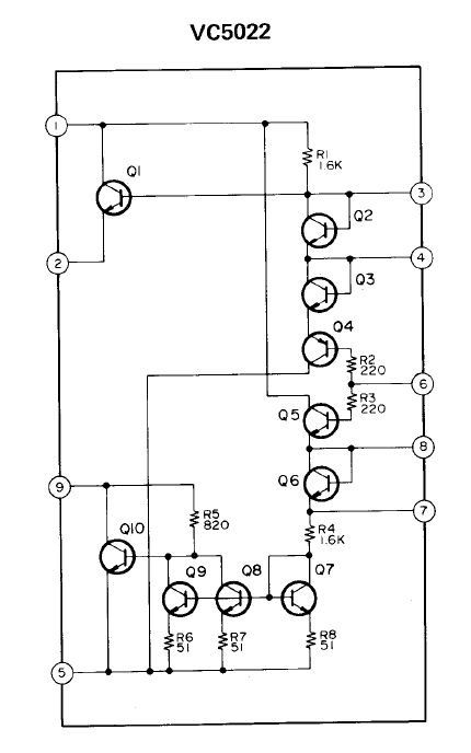

Your schematic for VC5022 is not correct one, it looks like a mix of VC5022 and VC5022-2. Hence, below is a complete VC5022 schematic for your reference.🙂
thank you very much for it!

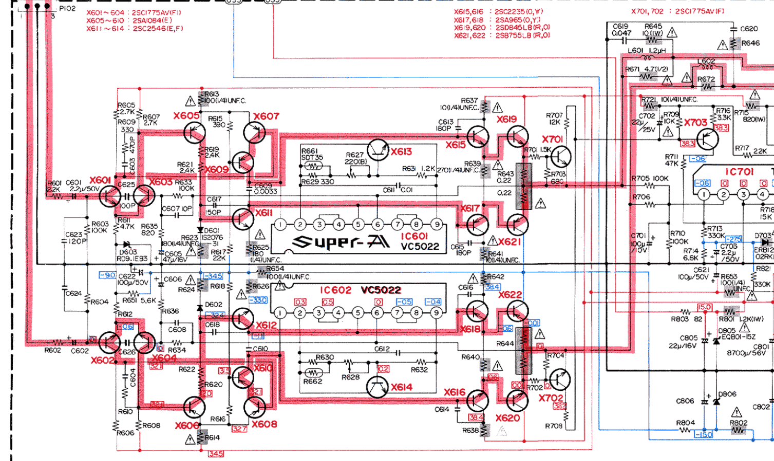

however the manual JVC M-10 gives this (attached), even when I switch it off I cannot find broken part:

Partial incomplete LTSpice circuit was only to show actual measured voltages.
Attach is schematic for VC5022-2🙂

I'd check those two 180R flameproof resistors (R12/13 in your sim). If those measure OK, I'd say Q4 is toast.
R12/13 are OK,
Q4 desoldered measured well
but I agree it is main suspicion, when powered with higher voltages than hfe DM it might leakage/open, I will change it!
there is not possible to set the bias <6A even with shorted bias multiplier with the "right" version of VC5022, asc attached
Delete Q18 and R34 connect Q17 collector to Q7 collector...
no 😉
VC5022 sch sent by you http://www.diyaudio.com/forums/solid-state/300164-please-help-repair-jvc-x2.html#post4905558 contains the error, Q4 on that schematic should be NPN type, not PNP, and this I changed in attached asc,
now the sim is OK,
and in this way the amp should behave,
but it is not😱
Q4 on my sim/X605 in original sch is OK, checked😕
Spot on, Eagle Aye😉...But as I have suggested in the previous versions with a single transistor constant current sink/source for the upper and lower branch of variable bias circuit will work as intended. In your version (which is probably more accurate than mine), you effectively replaced one transistor for CFP-Compound Feedback Pair (aka Sziklai pair). May I suggest to put another resistor (value from 1k2-3k9) from Q17 collector/Q18 base junction to Q7 collector in order to avoid possible oscillation in CFP...do the same for upper and lower branch.🙂

found!
Hi guys!
VC5022 is shorted/open between some pins compared to the one in good channel, and this was the reason for getting strange voltages at the drivers.
I ordered already new one and will let you know about further repair progress!
