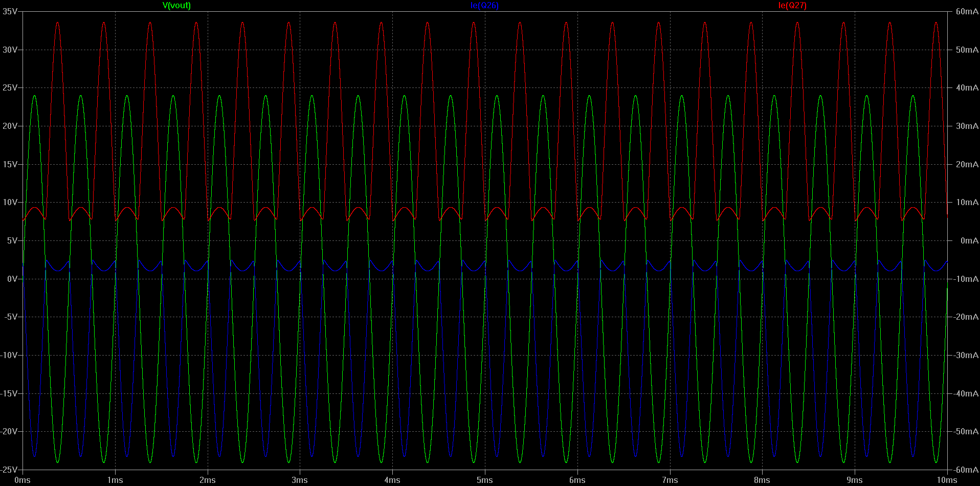

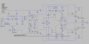

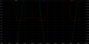

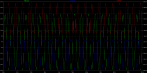

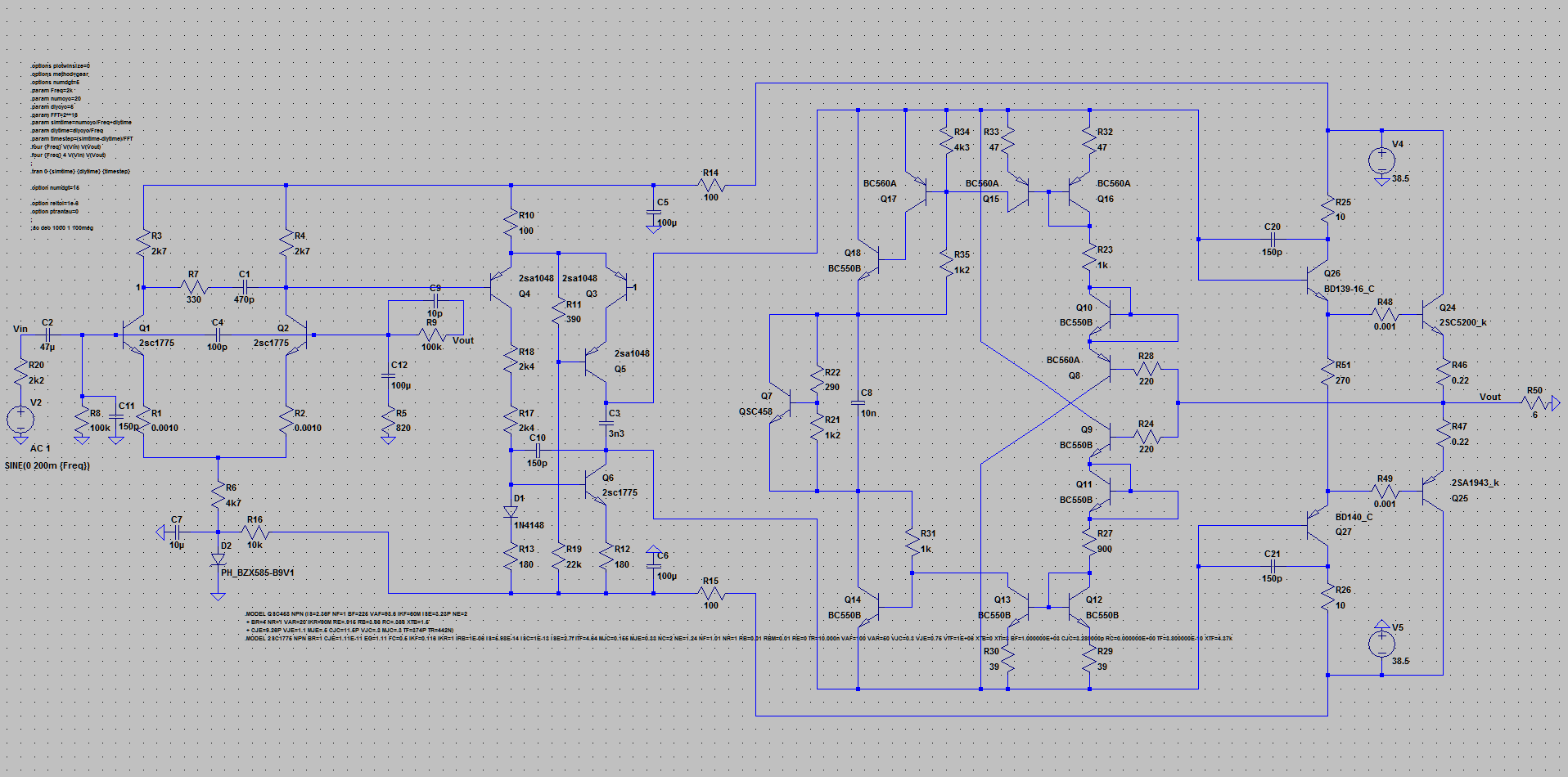

Hi!
For last few days the amp was working with higher than recommended in SM bias current (90vs45mA) but I am thinking to lower it according to SM.
Not because of the heat but designer's intention.
In meantime I checked the way of working of Super-A circuit in simulation and it looked like it worked a bit from hard clipping, not soft big radius rounds, only sharp corners were rounded up.
What do you think, is such behaving acceptable for nonswitching circuit?
