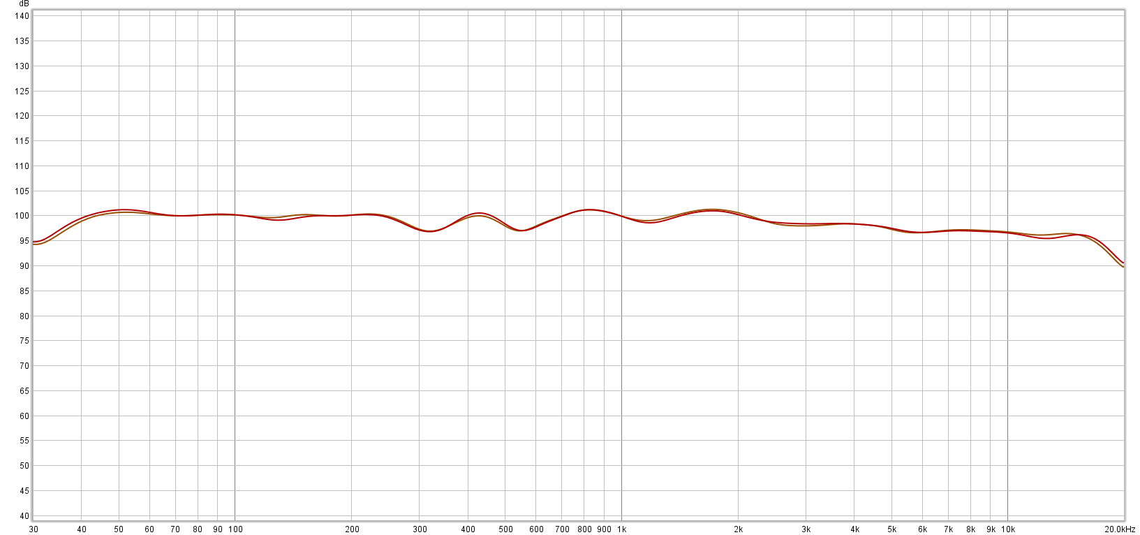

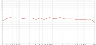

I attached the frequency response of that 2-way here. It is graph show how L/R channel is matched in the room.

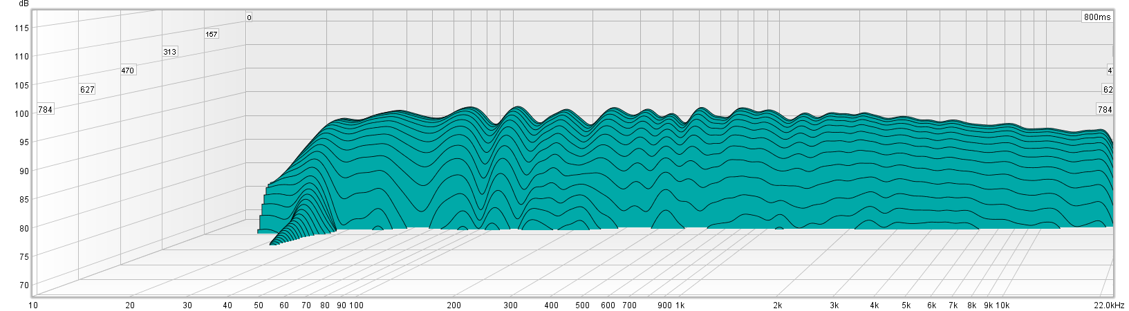

I also attached the waterfall of the room. That graph is when subwoofer (2x12 LAB12) play with the 2-way main, crossed at 80Hz LR4. The THD graph is measured at 100dB @1m.
LAB12 cannot play well above 150Hz. However, I believe a 15" midbass can play nicely upto 500-700Hz. The reason I want to go 3-way instead of 2-way 1x15" is that I want to try the midrange of a true midrange driver to see if it is better than 2-way 1x15" config.
Actually, I already really happy with my 2-way 1x12" speaker. However, it is addictive to try new things 😀

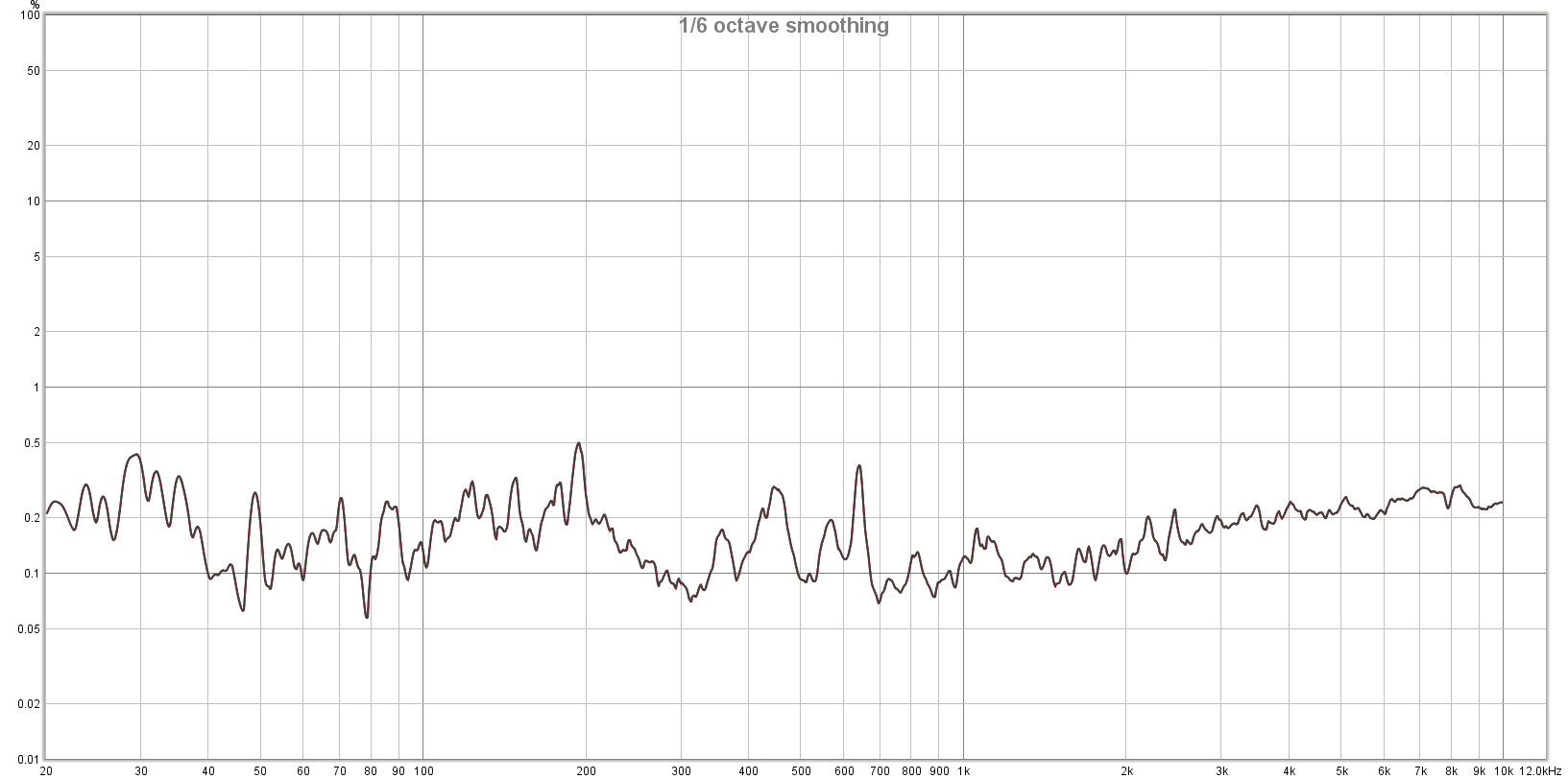

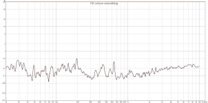

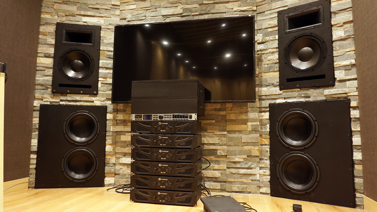

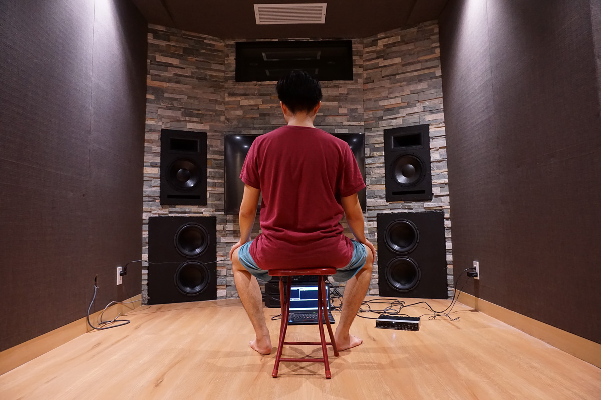

I attached the picture of my previous system with 2-way main (B&C drivers) and sub (LAB12).
https://www.diyaudio.com/forums/attachment.php?attachmentid=843002&stc=1&d=1589193581
https://www.diyaudio.com/forums/attachment.php?attachmentid=843003&stc=1&d=1589193581
