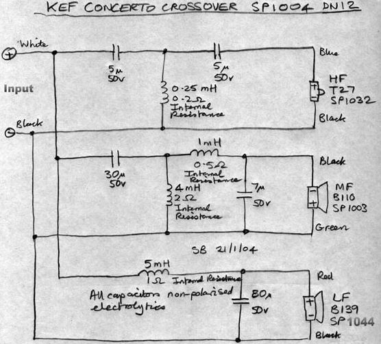

tsnell said:
Enclosures will be separate TLs for left and right, along the lines of
planet10 (post 21). But undecided on the B110 and T27 arrangement.
Sreten can you please elaborate on “Mounting all drivers on a wider
baffle and a higher crossover frequency increases the nominal
sensitivity”, aren’t there major drawbacks for wide baffles
for high/mid freq drivers (baffle step etc)?
If you look at the concerto crossover the T27 is run unattenuated.
If you look at the CS1A crossover you will see its run at ~ - 3dB.
The 3-way is ~ 3dB more sensitive than the 2way .....
Which should mean you cannot passively c/o the B139 low
to the CS1A as a subwoofer as it will be ~ 3dB too loud.
Unless of course you go isobaric (a la Linn) for the sub ....
A Plate amplifier for the subwoofer is the most flexible.
Passive subwoofer crossovers are a minefield.
Unless your friend is a bass freak I would steer away from a
massive bass enclosure, its unlikely to appreciated long term.
Making a good performing small box is a lot easier than a big
one, IMO the CS1A will surprisingly adequate on its own.
I would build a simple sealed isobaric subwoofer. I would
then try a stereo series 1st order crossover for each B139
and sattelite (sounds strange for isobaric but should work).
AFAICT this might work quite well for a passive arrangement.
If it does not work well then the subwoofer needs to go active.
There are all sorts of possibilities if you are capable of buiding
the preamplifier and power amplifiers, active also means any
subwoofer approach can be taken.

My suggestion is to go for original KEF recomended enclosure:
KEFKITs and DIY Designs
You should take a look @ this enclosure:
Anatomy of the Kef Concerto
This is cabinet specs:
