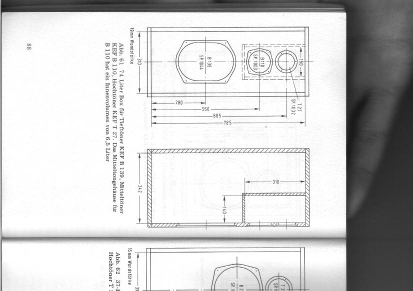

Great so it sounds like a transmission line is the way to go. I’ve attached a photo of the folded horn article (sorry I don’t have a scanner, I can scan it on Monday at work if anybody wants a better look) and some photos of the drivers themselves. There is some discolouration on the B139s, not sure if this will have an effect on sound, the rubber surrounds and everything look in great condition though.
The folded horn (TL?) in the article is interesting looking. It has the B139 mounted on the top of the enclosure. I am completely open to suggestions though and the satellite and TL woofer enclosure does sound very interesting (I may be biased though; my speakers are Edgar eve-II f in a similar configuration). Bi-amping will also be an option, we have a few old amps floating around now, the Yamaha A-700 and a Teac BX-300 are sitting in front of me right now.

Those articles are the 2 Bailey articles that got things rolling, spawning Radford, IMF and TDL.
Modern TL simulation software lets us get closer to optimum, althou ny the time the later lines came along, so many had been prototyped they were getting pretty good.
If you can go active, a 100-250 Hz XO between the B139 & the B110 is suggested. Depends on the filam configuration.

I agree with the dual woofers vs combined sub, would like to keep them separate. So it looks like the way to go is:
• A TL for the B139 like Planet10 suggested (or like the 3rd link I put above)
• The B110 and T27 on top in a separate enclosure (passive XO, plus another B110 for MTM if I can find one)
• Bi-amped with the Amp 9B
Alright, looks like I am starting to get a plan together. Can anybody recommend some good (free) TL modelling software?

tsnell said:Here are two other TLs I have found:
The 1st is the one is the one i posted above... you would rejig the 2nd to use the same line as in the triangulated one... bascally you start wth a closed end area, a terminus area, a legth and a driver position... that can then be bent up (or not) in many ways.
dave

Have a look at Wireless World
I remember this KEF-based design...I believe it was originally published in Wireless World, and was a transmission line design with two diagonal partitions inside a rectangular box, resulting in a triangular transmission line that reduced as it progressed towards the port.
I built a variant using the KEF B200 and the T27. I don't have the speakers any more, unfortunately, but they were my first foray into speaker-building.
I built them from the second article shown above: "The Transmission-Line Loudspeaker Enclosure." The triangular internal structure is shown on the second page of the article, which can be found here:
http://www.hifiloudspeakers.info/Anatomy/Articles/ArticlesGallery/Bailey/BaileyWWW1972/pages/ww72b2.htm
