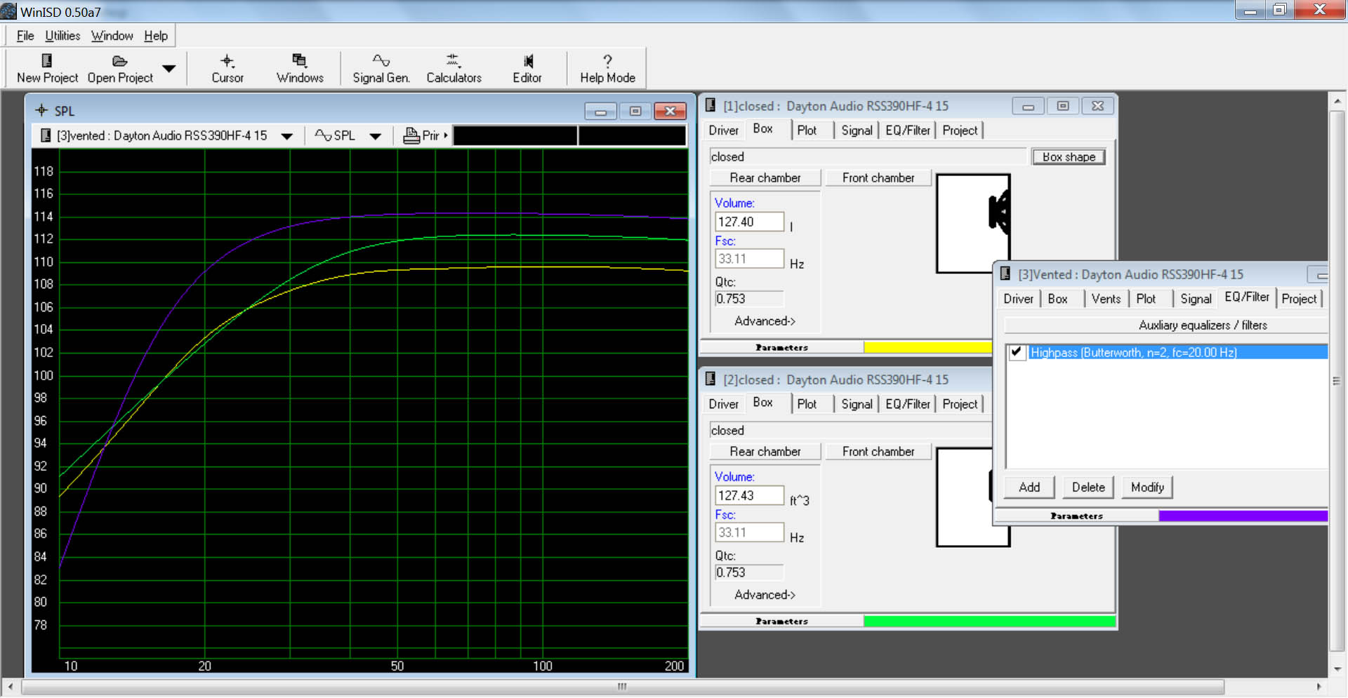

Here are the plots of the HF in ported (250L), sealed (125L) and sealed (125L) with eq applied (3.25db at 20Hz). All modeled with a single driver
Without a highpass filter the ported HF has amazing extension, but no protection and has the same output (xmax + about 10% limited) as the sealed version. With the HPF in place at 20Hz, which is what the NU3000dsp can do, the output is a good few db higher, but the response is pretty close to that of a the sealed HF with eq.
So the decision seems to be between:
HF vented-HPF @20Hz. More output with the same extension as sealed, Large box and I may not be able to add a second one due to size constraints.
HF vented-no HPF. More extension, but same output as sealed. Large box and no protection on the woofer.
HF sealed no eq. Smaller box, multiple subs possible. About the same output, but with much less extension than vented with no HPF
HF sealed with EQ. About the same extension, but less output than the ported box with the HPF. Smaller box.

If I follow correctly, here is the plot of output adjusted to xmax, which is what we should be concerned with:
This looks like the ported is 6db more output at 20hz to me. To get the same with sealed, you will need two together in the same location. Two sealed in separate locations will give 3db more than one. While it may be a similar response curve, having the 6db more headroom will give you much more to work with when EQ'ing to flatten things out.
Keep in mind that's a 2nd order highpass, the inuke DSP can go up to a 8th order, which is much more abrupt. How this interacts with the roll off at port tuning should be considered. The 17hz tuning combined with the 8th order butterworth at 20hz should give very strong response to the low 20's, while the 2nd order will give a longer milder rolloff with more extension. You can try various highpass orders to find the right mix of extension vs. output around the highpass point.
Overall, I would try the ported box next to your listening location, with the inuke in bridged mode into the 4 ohm sub. Delay, highpass, lowpass, and EQ as needed, it should sound excellent, assuming a correctly designed and constructed box.
