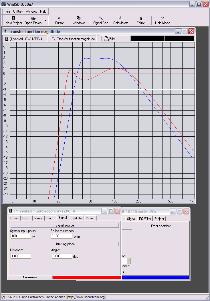

I've modeled all of them in winisd and unibox, but I'm having a hard time understanding how these will translate to sound quality. I've used these before, but not for subwoofers.
I'm not sure how to post Winisd graphs here or I would. If someone would let me know that might be a big help.

There’s programs that allow you to highlight/copy/save stuff on your screen and I’ve been told that saving them as gifs is best, then use the ‘manage attachments’ feature to add them to your post. Don’t know if there’s any freeware available anymore though, mine’s from 2000 and can’t find it in a quick search except as a much more elaborate program for a fee.
I guess some folks still just use the ‘print screen’ key to capture whole screen and use PAINT or similar to ‘erase’ what they don’t want.

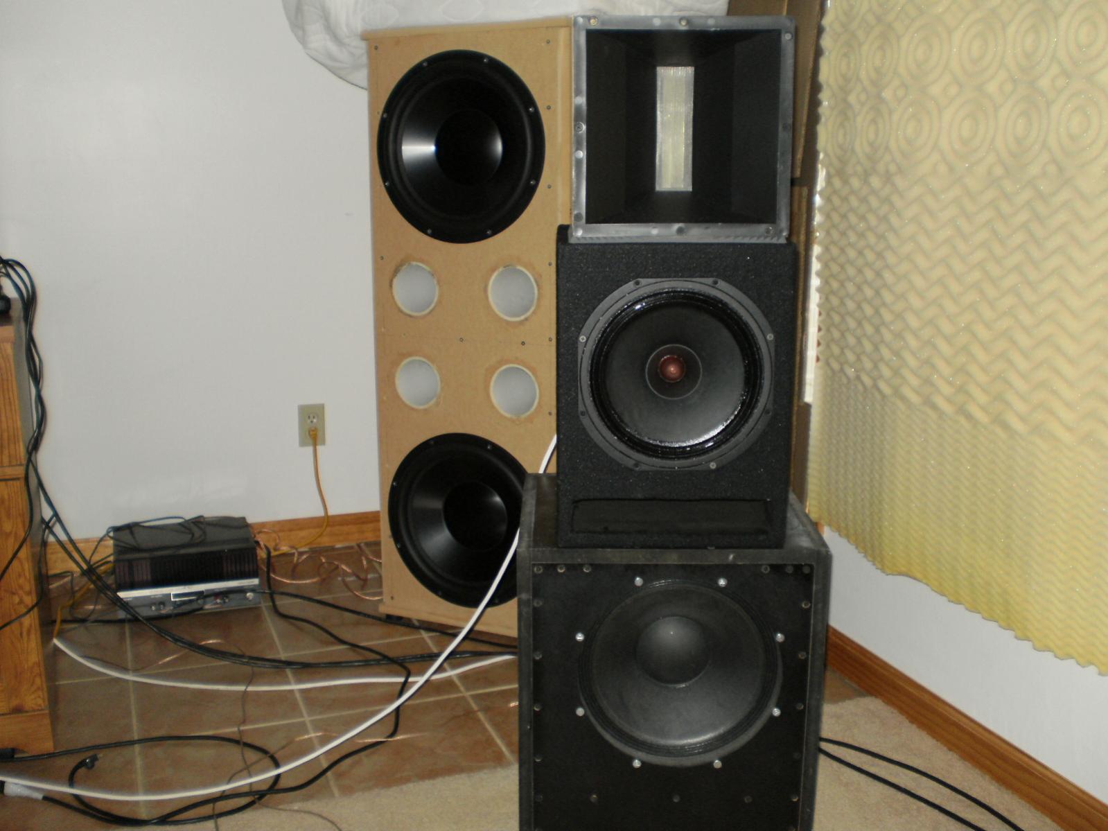

HO 15
My choice was a pair of HO-15's. I realize a pair is a bit higher than your budget, but if you build your own enclosure(s) maybe (?)
It's actually quite the amazing driver, especially at it's price. My bass reflex gets down to the mid 20's easily. I measured the fs of my pair and they were a tad bit lower than factory spec @ 21hz.
I think sometimes the bass reflex gets a bad rap, but to me, they always sound more relxed than a sealed box.

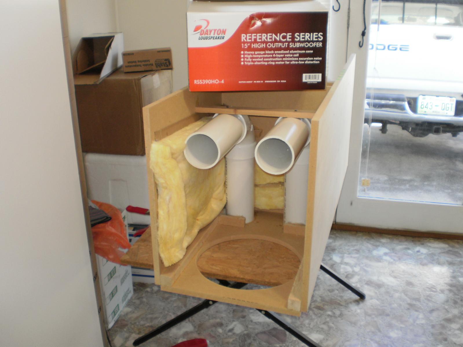

You've seen my ported ref HO 15 project?
http://www.diyaudio.com/forums/subwoofers/219923-ultra-compact-ported-15-dayton-ref-ho.html
I modeled dozens of drivers and various horns before deciding to go with the ported HO as the best combination of extension, sensitivity and output for a 4 ft^3 gross box size. The model shows about 73L net, 15.5L port volume. I think you'll be very happy with 100L net tuned to 25hz, as long as you size the port large enough and use enough power.
The HO uses a very heavy and stiff aluminum cone and is very low distortion. It is certainly "quick" enough for bass frequencies. I last ran them with the following eq/filters, they have no problem producing strong kick:
