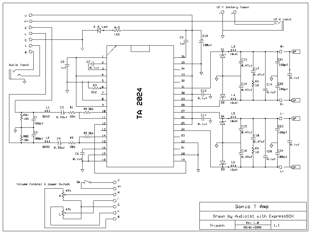

Marsfrogie said:
http://www.michael.mardis.com/sonic/start.html
That is a link to michael mardis's schematic.
C10 is originally 330 micro farad and is a power tank. Perhaps it is backwards. Can someone take a look at that schematic and tell me?
That link is to the basic T Amp and not the Super T..

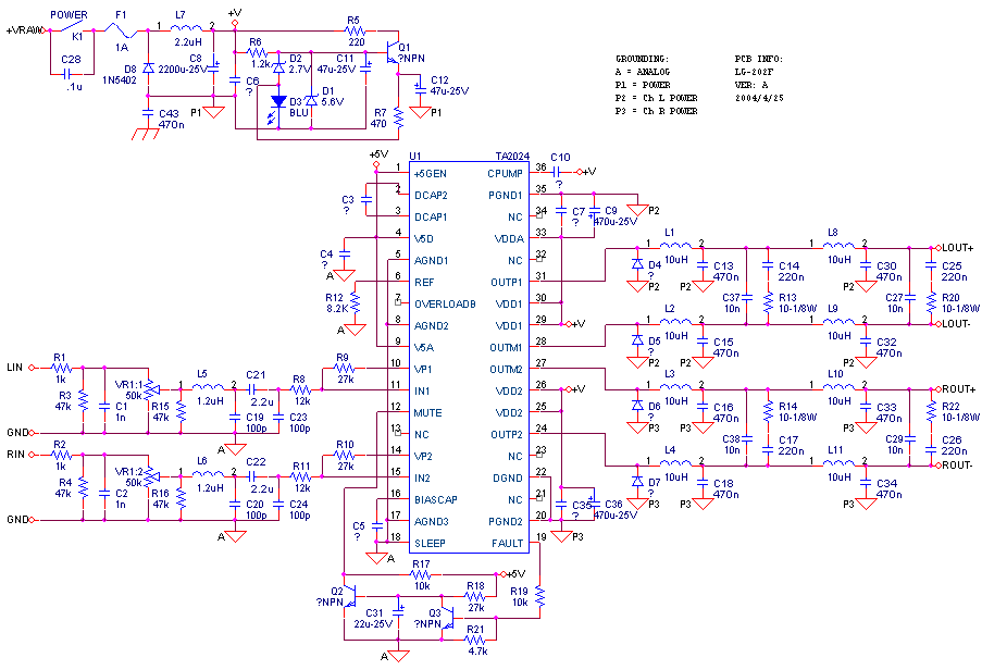

See here...
