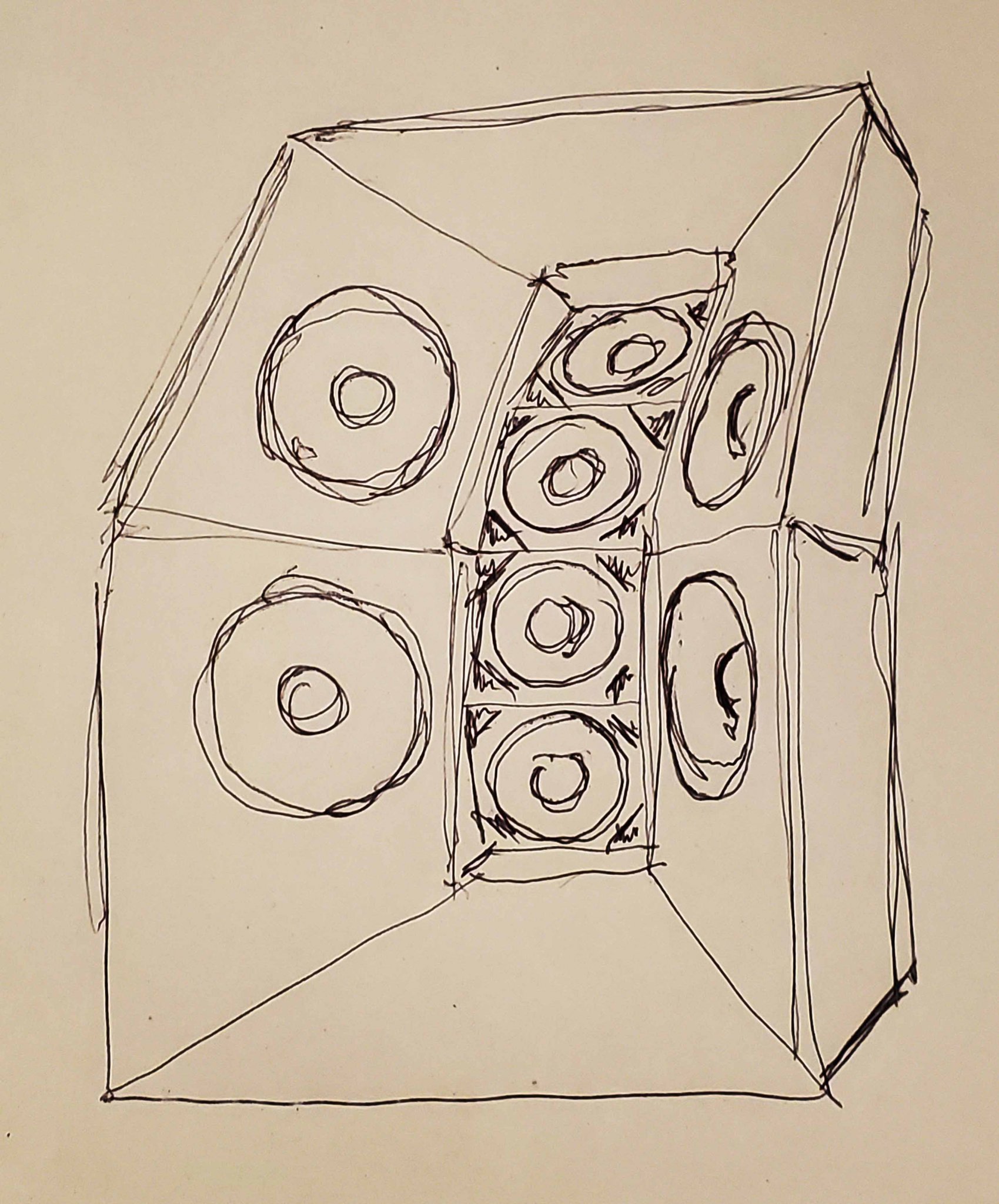

please criticize my design for a very large multi-way system
all right i'm attaching some sketches to help you visualize what i have in mind ...
this design has gone through a bunch of iterations and some aspects of it keep sort of vacillating which i will address later ...
for now i will just describe what the current iteration is, as depicted in the sketches ...
5-way system consisting of a center subwoofer stack that goes between the two main 4-way speakers ...
both speakers and subwoofer stack are 80" tall ( to fit in basements ) and the width is 32" for speakers because that's 1/3 of 96" that plywood comes in ... and 2 x 32" for the subwoofer stack. each subwoofer module is 25.5 x 32 x 40 inches, with a total of four modules. 25.5" is just 24" + 2 thicknesses of plywood. the main speakers would have approximately similar depth ( about 2 feet ) but since they curve towards the listener they don't have any hard number for their depth ...
in my sketches you can also see a 75" TV mounted on the subwoofer stack ... that is indeed where the TV will go but it doesn't have to be 75" ... although the width of 75" matches the width of the subwoofer stack exactly, which may or may not be a coincidence ...
total system width would be about 12 feet which is about as narrow as i could get it but it should allow it to fit in most living rooms outside of NYC and SF.

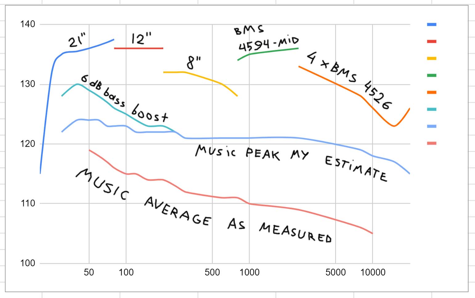

in the current iteration of the design the driver compliment is as follows
25 hz - 80 hz:
https://www.eighteensound.it/en/products/lf-driver/21-0/4/21ntlw5000-4350 liter net box, vented, tuned to 25 hz ...
four such boxes in the center behind the screen ...
80 hz - 200 hz:
https://www.parts-express.com/JBL-2262HPL-338312-004X-12-Neo-Woofer-294-45040 liter net box, vented, tuned to 70 hz
four 8 ohm drivers per side for a total 2 ohm load
200 hz - 800 hz:
https://www.eighteensound.it/en/products/lf-driver/8-0/8/8NTLW20005 liter net box, vented, tuned to 130 hz
four 8 ohm drivers per side for a total of 2 ohm load
800 hz - 3 khz:
https://www.bmsspeakers.com/index.php-62.html?id=bms_4594nd-midon the following horn:
https://www.bcspeakers.com/en/products/horn/1-4/0/ME4648 ohms ...
3 khz - 20 khz
https://www.bmsspeakers.com/index.php-48.html?id=4526nd2 x 2 array of 8 ohm drivers in series parallel for a 8 ohm load
the horn array will consist of four identical but not symmetrical horns that must be 3D printed
that is to say the arrangement of the four horns will be symmetrical but the horns themselves will be asymmetrical
the asymmetry will be used to bring the drivers as close to each other as possible, with magnets almost touching each other
all in all 8 identical horns will have to be 3D printed from a single file
main crossover will be MiniDSP 4X10 HD and it will plug in directly into the TV via optical Toslink ... i will throw some protection caps on the compression drivers to be safe as well ... the 80 hz crossover point will be realized internally to the 4-channel DSP amplifier that will power the woofers and subs
the TV will ultimately be the source, it will probably be a 2022 Mini-LED TV from either Samsung or Sony. i had a 2021 Samsung Mini-Led that i used as a source like this via optical output and it worked really well as the TV could do YouTube, Netflix and Spotify ... unfortunately it was a first generation Mini-LED and had a flicker so i sent it back to Costco ... in 2022 Samsung is coming out with 2nd generation Mini-LED and Sony is entering the Mini-LED market as well ... it will take time for prices on new models to drop but it will also take time for me to design and build this system ...
there will be a total of 3 amplifiers:
QSC PLX 2402 ( which i already own ) will power the 8" midbass array at 2 ohm, and will have a Noctua fan mod
QSC CX 404 ( four channel ) is $400 used on Ebay and will power all compression drivers, it will have the same Noctua fan mod
JBL Crown DSI 2.0 MA4 ( four channel ) will power both subwoofers and 12" woofers. this amp is expensive but it packs a lot of power and DSP and i may need those.
now for where the design keeps vacillating ...
i sometimes wonder if it's best to use 12" or 15" JBL woofers and whether it is best to use 8" or 6" Eighteen Sound tetracoil midbass ...
i sometimes wonder if the midbass should be vented or sealed ...
i sometimes wonder whether to use BMS 4592 mid, 4594 mid or 4599 mid ... the 1.4" throat versions can be used with B&C ME464 horn while the 2" versions would need either SEOS 30 horn or a DIY horn with 3D printed throat adapter and plywood mouth
i sometimes wonder if the system should be 5-way or 6-way ... in case of 6-way it would have an array of Six Beyma CP-12 Supertweeters crossed at 8 khz ...
i sometimes wonder if for tweeters i should go with BMS 4526 or Faital HF106 ... and in case of faital whether to use 1, 2, or 4 ... or if using Supertweeters perhaps a single Faital HF1440 ...
the reason i am using an array of tweeters like this is 2 fold:
- it lower distortion by quadrupling throat area thus lowering compression and distortion ...
- it doubles the coverage angle at the extreme high frequencies where horns begin to beam ...
yes i realize there is the issue of comb filtering and that's why i keep vacillating on what is the best solution in that area ...
The system you have envisioned is very complex. Most of the large studio control rooms and film sound stages do not have main monitors with as much complexity as you are envisioning. Designing, building, and measuring a system of this complexity, and getting a good result, is very difficult.
Are you planning a 5-way speaker because you do not believe that a 4-way will get the job done, or have you just decided you want a 5-way because you really want a 5-way? it is fine either way, but it helps us to know what your thoughts are.

You have to be happy with the system.
I would just not be interested in 2 ohm loads.
With multiple drivers I think thermal capability is more than enough.
Not necessary, likely to vent midrange.
It has been done before in live PA systems. The reflex/tuning point of the system is below the
crossover. So the smearing or poor effect a vented cabinet can have is not in the signal.
The cabinet is just simply vented for heat removal. Not needed for home system.
The ME464 is very nice horn, performance wise and visual as well.
2 ohm loads stress the amplifier and can cause higher distortion.
Many of us have designed, measured, simulated and built our own amplifiers.
I have no interest in 2 ohm loads. Not needed in home situation.
Controlling levels / and crossover for 5 way system is complicated.
I would likely look at measurement equipment and possibly DSP
or Digital Sound Processor to dial in and EQ your system.
If not, most of your concept is has realistic reasons.
But it could be overwhelming and little difficult.
I believe you could do a Vented 18" for bass
With crossover around 200/ 250 Hz which is were you will get a 6 dB drop.
So it will be easy to adjust bass levels.
Then use a sealed midrange.
Then the ME464.
I have used actual live sound towers in the house. 2x15 and Horn.
No where close to Hi Fi standards. Typical live PA crossover.
Just a simple stereo pair 2x15 and horn really rocked the house!! with maybe 20 to 40 watts.
With 18" and good midrange, and nice horn
Think you would be surprised what these live sound drivers can do.
Reactions: DblAA
Can you boil down your (user) requirements to a short list? Perhaps:
  • budget
  • +/- x dB on-axis? +/- x dB at 10, 20, 30 degrees off-axis? -3dB point in the treble at what frequency and off-axis angle?+/- dB power response?
  • What kind of radiation "shape" are you after? It seems you've already decided to use waveguides/horns, is there a reason for that?
  • Peak SPL at listening position? Average SPL?
  • Maximum/threshold for each order of harmonic distortion?
  • Minimal/moderate/limitless use of room treatment?
You've come up with a lot of "ways" to achieve what you want, but what is it you really want?
Reactions: DblAA

Can you describe the purpose and configuration of the four vertically stacked midbasses...
excellent question.
firstly i'm attaching two new images ...
my original sketch didn't show the fact that the four vertically stacked 8" midbass drivers are actually on an arc and not in a straight line ... so i'm uploading a "zoomed in" sketch that shows that detail ...
it will actually be two identical cabinets - top and bottom - with the top flipped upside down. together they will horn a sort of a waveguide for the arc array of 8" drivers. this will hopefully launch a cylindrical wavefront giving me the vertical coverage i need.

which brings us to my other uploaded graphic - the chart !
bottom reddish line is average music level as measured by a dude on another forum from his own collection of music by running headphone output to REW ... i have scaled his curve up to 110db @ 1 khz because that's the NIOSH 1 minute exposure level ... that is a level ( measured with "slow" setting on SPL meter which averages peaks over a second ) at which you can be exposed for at most 1 minute a day to keep hearing damage to "acceptable" levels. in other words this is as loud as you would ever want to listen for even just one minute. Actual rock concerts are regulated at 100db which is 10 db lower ... but of course they can last for hours and 110db is ONE MINUTE rating. I rarely listen to music for hours and sometimes i will crank it for just about a minute on a good part of a song so i went with the 1 minute rating.
second ( light blue ) line from the bottom is my estimated PEAK levels based on the above mentioned average levels. as best i could find out music has about 6db crest factor in bass and about 15db in high frequencies so i added that much to the average curve to get my peak curve.
the little cyan curve on the left is 6db of bass boost that i will almost certainly apply to spice things up.
the top five short curves are each individual frequency band of the 5-way system with output calculated for lower 3 bands using HornResp and for the upper 2 bands using some back of the napkin calculations based on published specs ...
as you can see the loudest frequency band is actually the compression midrange, which is the only frequency band covered by a single transducer. it is also the most critical frequency band occupying the center of the vocal range.
the most under-powered frequency band is the subwoofer, which is done to keep system size and cost down and also as previously explained because we tolerate very high distortion in subwoofers.
the tweeter runs out of steam a little above 8 khz or so but keep in mind that curve is the POWER RESPONSE not the on-axis response ! my system will have more output at 20 khz averaged over the 90 x 60 degree radiation angle than ANY single driver you can get and mount to any horn. and that's of course because i simply have four drivers there instead of one. and the reason i did it that way is because a single big driver will beam above 10 khz ... but a single small driver will get fried ... so i used four small drivers

yes i have. i already posted this above but i'll repost it for you here ( see attachment ). i have explained in one of the posts above what this chart means.

do not be quick to assume that i can't meet my requirements of inaudible distortion at hearing damage levels. hearing damage occurs sooner than people think. and distortion is not as audible as people think. i believe my system already meets the requirement.
25 hz - 80 hz:
80 hz - 200 hz:
200 hz - 800 hz:
800 hz - 3 khz:
3 khz - 20 khz

Hello, This sounds like a solid sound system, capable of delivering many loud service years. Know too little about PA driver and horns, even though i find them fascinating, luckily this is already very well covered above anyway, but i can comment from experience on some of the other parts of the system:
- If you can get QSC CX 404 for that price, that is a very solid choice I bought a QSC DCA 1644 back in 2001, and died just a few months ago, being on more about 20 years or I also have the DCA 2422Hmm.. criticism
If you are willing to take a step back look at all your options, try reading this thread
https://www.diyaudio.com/community/threads/asathor-a-jbl-4367-clone.367215/
Imagine this speaker, but with an active DSP crossover (which you are already planning to use). Imagine it with a pair of stereo subs based on that big 21" Eighteen sound driver, crossed at ~ 100 Hz. The Asathor is a well thought-out system, capable of high output and low distortion. It is worth consideration. With a pair of massive subs, it might meet your requirements. And even if not, it may broaden your options and give you some ideas.
j.
if you want a 15" 2-way why not just buy this box:
https://www.rcf.it/c/document_libra...93f-8e10-45cf-8714-cc2979a7ca6f&groupId=20195
it already does everything your Asathor does and its fully self contained and portable with amplification built in
breathing saw dust isn't my idea of fun. i am not interested in building a clone of something i can just buy.
frankly it wouldn't be a half bad idea to buy that RCF box and just build those 21" subs for it.
i think my reasoning for not doing that was that the RCF speaker has no digital inputs whereas both MiniDSP HD 4X10 and DBX DriveRack Venu 360 do have digital input ... which makes them a more "high end" solution while the RCF is a more "PA" solution ...
i also felt like the price maybe isn't justified ...
i mean yes you CAN build a 3-way system that works ... i just don't understand this obsession with simplicity.
you need to understand the reason companies like JBL and RCF stick with these simple designs is SO THEY CAN MAKE MORE MONEY.
if they can build the speaker for half the price and still sell it at the same price then they HAVE TO DO IT or they will be driven out of business by competition.
in DIY we don't face that pressure. we DON'T HAVE TO build the smallest, cheapest, simplest box possible. it doesn't matter !
