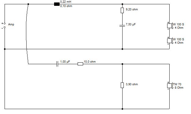

While on the subject though, The piggybacked cap & resistor network that i added (in series with the LeSon tweeter) to a sketch earlier in this discussion is sort of like a reverse tilt BSC because it favors the higher notes of a tweeter instead of BSC which favors the low notes of a woofer) , it can also actually flatten the impedance curve a bit by adding a few ohms of series resistance to the lower notes in the tweeter's spectrum .... The tilt effect which favors the high end is not unlike the "Constant Directivity" compensation in the world of PA ...

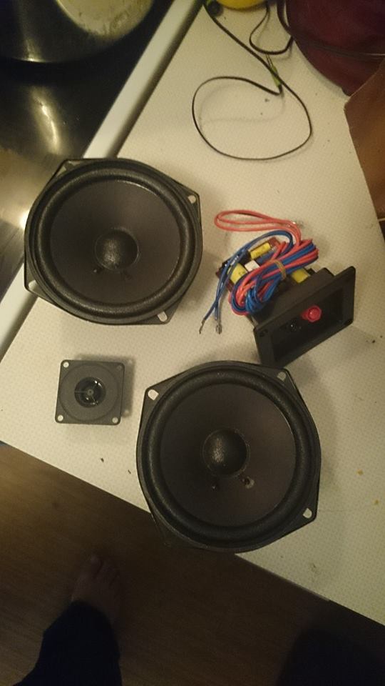

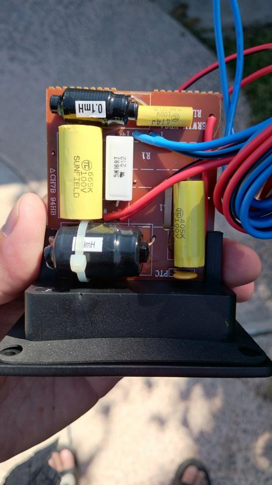

There is something you guys should check out! While im ranting on the subject of midbass drivers & QWPs i thought i might just throw this out there, I don't know if Mavin delivers to the UK or to Brazil but holy cow they have a good deal on this following MTM kit:Klipsch Foster 5 1/4 inch Center Channel Speaker Kit
22 dollars gets you a nice crossover , two midbass drivers and a tweeter! We are in the process of building two QWPs for these two MTM kits right now, they will be the "mains" in my friend Adam's home theater system. These kits can be used in a QWP almost the exact same size as the one required for the 8W4P .
We received the delivery a few days ago and i cannot believe how nice the crossovers are on these, heavy gauge chokes and all poly caps, the crossovers are worth 22 dollars all by themselves!
I will attach a few pictures that we took of what we received, this is a great deal !

The software I use is Visaton Boxsim. You can import projekte files straight into it for an easy introduction. http://boxsim-db.de/standcouplet-wg/
You gradually get the idea of what to do with different drivers. Flattish or even overly lively ones need more work with the filter. Ones that naturally rolloff are kinda easy. 😎
I get quite good at guessing what different drivers need these days. Just from the look of them, the Le and Re, and the Qts for the cabinet, and preferably seeing a frequency plot.

Here presumably all you need is an L-pad
on the tweeter and a 1st order series x/o,
no zobel on the bassmid, around 5KHz
is my best ~ guess, without simulation.

I'd like to sum up a couple of issues here. Firstly, bafflestep correction would be an unwanted layer of complexity here. The only sensible way to do it with a high crossover is like this:
Loudspeaker Diffraction Loss and Baffle Step Compensation Circuits
That approach needs a biggish 1.5mH BSC coil and the shunt capacitor in your 0.11mH plus Zobel circuit changes in size due to the 4.7R resistance from the bafflestep section. Hardly worth it.
The impedance problem is not a showstopper. You can convert to an 8 ohm MTM style easily enough and build a centre speaker. I give the conversion below. You double the coil and resistor, and halve the capacitor.
I did build a speaker with two 4 ohm car speakers wired in series many years ago, and it was really rather good. It had something. It's the PA sound. 🙂

System7, thanks.
I reconsidered.
Will start to put together the parts and do the soldering.
I am going to post pictures because that's the most entertaining part of DIY.
Will get a foam like this:
The only thing I am not sure is what type of glue I should use! Any suggestion?

That sort of foam will hold itself in place.

- Please check out my final circuit X/O with piezo
