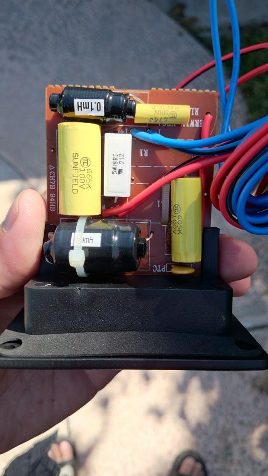

sreten,
How the right schematic would be in your opinion? A 8 ohm resistor in series to attenuate with the 4.7uF capacitor in the recommended place? Can you please paste a drawing.

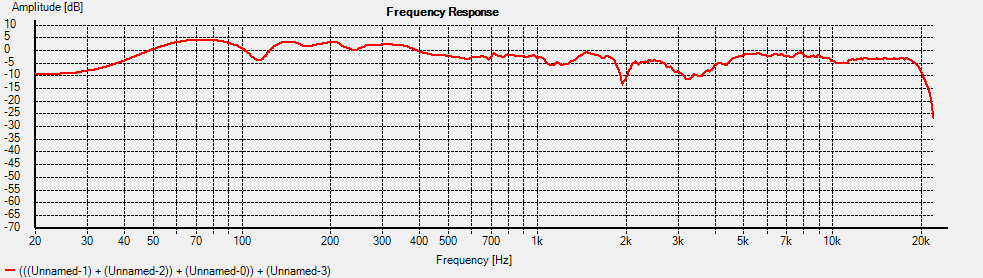

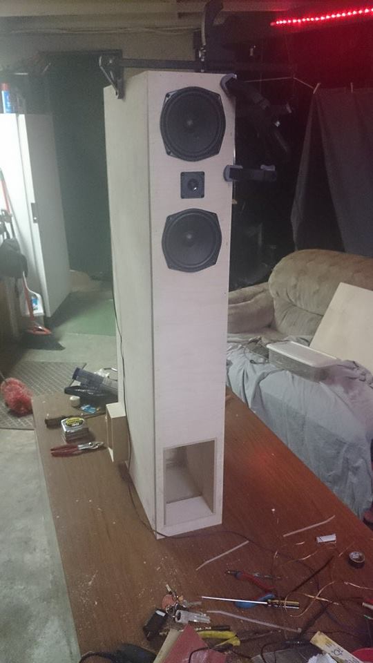

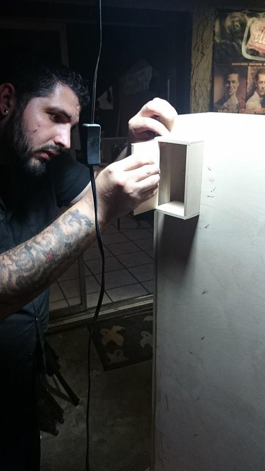

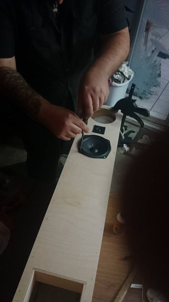

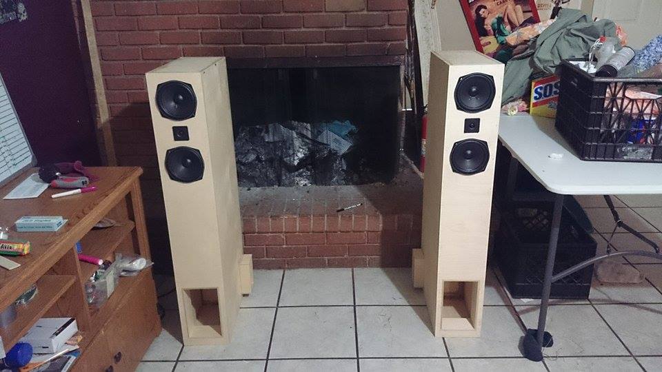

We have these TL cabinets finished..They are based on the $22 dollar (yet surprisingly high quality) Mavin MTM kit ... GREAT RESULTS!! , (much better bass than could be had with these same drivers in a ported cabinet) they are rather large though, so that's the compromise.... The footprint isn't too bad because of the slender tower format, but they are still much larger than a ported cabinet would be for these small drivers ..
I took some quick and rough measurements with a Dayton measurement microphone and HOLMimpulse software (which is AWESOME by the way and FREE !) .... I wasn't unable to get proper measurements outdoors that day because it was too windy here, and the next day Adam (the guy you see in one of the pics) took the cabinets home, so these measurements will have to do ...
