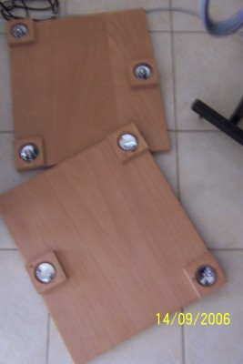

Phileas, great job!!
My base looks like yours but I will use a roller system instead.
You just need 6 concave door knobs pullers like these..
http://i6.ebayimg.com/03/i/04/1e/a7/76_1_b.JPG
or bigger from Amerock (BP 3414/3413). Those are going to be placed into the shelves in a triangular mirror image configuration. Them, put 3 metal ball bearings in between the knobs and you got what Symposium call a Double Stack Configuration for their RollerBlocks..in my case, a RollerBearingPlatform...
Jose.
