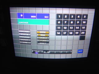

Hi, could you provide a screen shot if possible? Every model I know that released before the 101 don't have this kind of thing.

DragonMaster said:Hi, could you provide a screen shot if possible? Every model I know that released before the 101 don't have this kind of thing.
Happy to oblige. Nothing fancy I'm affraid as I don't have video capture on my PC. A good old photo of my TV screen ....

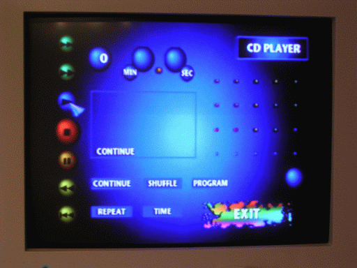

Well, that's the CD player interface that I have on my PSOne SCPH-101. The select button activates a visualization feature instead of stopping the CD.
On the old PSX SCPH-1001, it looks like in the attachement.
The pic. comes form my 15" PC screen with a poor quality composite to VGA adapter.
On mine the DSP buttons are the onces that have a yellow tint. They read 'DOME', 'CATHEDRAL',HALL, STUDIO,DIRECT, and appear to add progressively less echo.
