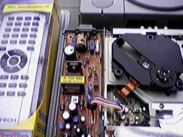

Hi
I have just got my third 1002 Playstation.
Seems it third time very lucky. It is more
articulate than numbers one and two. Certainly
my first PS1 was good but this number three seems
really good. Not one skip in 2 days CD or CDR!
Well this brings me back to my number two
Greystation. This one skips a lot and
I think we are looking at a short cable 11.4mv
adjustment to make it bit literate again !
I used to use CBM CD32 units with some success but
the detail is not in the Sony PS1 league.
Maybe this number 2 PS1 Playstation may end up as the best
sounding one when the bias and other voltages are fix up along
with other mods. All the playstations came with 3 month
warranties so I have to wait a while! Cost so far with Ir remotes
just US$80 for all three units. Remotes were only AUD$2.50ea.
Sweet!

Enclose Pic of said PS1 with bargain remote.

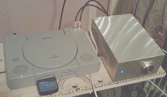

Hi guy's, just to give some feedback...
Did the complete bypass mod to the output as per Audio1st version and there is a substantial difference over stock through the RCA's. Whilst I was A/B testing with another unmoddified PS1 I hooked up the AV cable and A/B tested that against my bypassed one and it's really quite good, a lot better than the RCA connection and almost as good as the bypass mod.
Think I'll strip it down and put it in a nice case next.....
By the way, if anyone wants to put it on constant replay (I did it to run-in the DC blocking caps) you just need to start it playing and then press 'up' twice and then 'select' twice on the remote, or 'x' twice on the controller.
Thanks to everyone who helped along the way.
Lee

The PSX, a 40-yr-old tube amp and Mårten Design speakers are possibly the best combo I have ever heard. It might not be that after Sunday when somebody brings over a modern single-ended beast to hook up with the PSX and Mårten Designs. It's his. I will not buy it, only listen to it.
My point is that I can see this work. But then, I thought the Sonic Impact T amp would be a terrible match for the Mårten Designs. I couldn't be more wrong.
This is basically a linestage/buffer, as said on the page. Here's a minimalist buffer you could look into.
