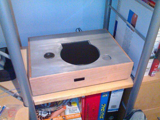

Hi at all,
@Greg
i can confirm all that you wrote about sounding of the PS. If you have a subwoofer there is also a deep and verry clean Bass without any contorsions.
All in one there is a sound like an analog player. This is it what i prefere.
On my homepage you can see some pictures of my modifications and new housing.
http://www.highend-info.de
Regards Dommi
@Greg
Regards Dommi
