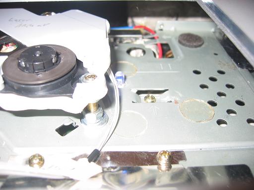

Re: Re: Re: mass damping
jives11 said:
Thanks Dommi,
What is the reason for the blue LED ? :scratch1:
I assume i't not like the Car or PC case modders ("pimp my playstation") 😀
I noticed that the transport is supported in 3 rubber tubes, but on one side this floating is damped by a plastic tab which rubs against a small rubber pad attached to the metal subchasis. I guess removing the tab and the rubber pad will allow the transport to 'float' better ?
the blue led is to minimize difuse reflection from the CD. The blue light absorb the lense light. In my config i can't determine any differences with or without blue led. But Michael Methe find out in his configuration that it sounds better with blue led. I let it inside. You have to check it out in your config.
For transport mount i can tell you that is verry much better to fix the transport with thread and nuts. You can see it if you play a CD. Look on the laserlense and you can see how it moves. Because of the movement of the complete unit the lense is steady moving back and forward to compensate the movement of the unit. With a fixed unit the movement of the lense is minimized.
Try it and hear !!
Regards Dommi
Try it and hear !!
Regards Dommi
Dommi, I am sure that the use of a blue led for absorption of stray light of the laser (or anything like that) is pure nonsense. I am a physicist and can judge this kind of statements.
It may be a powerful aid in psychoacoustics for some people, though 😉
I will try to fix the laser unit and see how it changes. It will certainly be worth a try.
