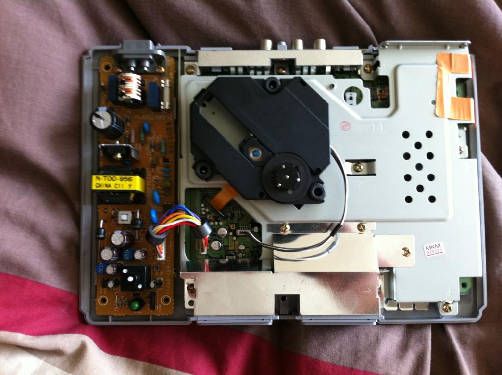

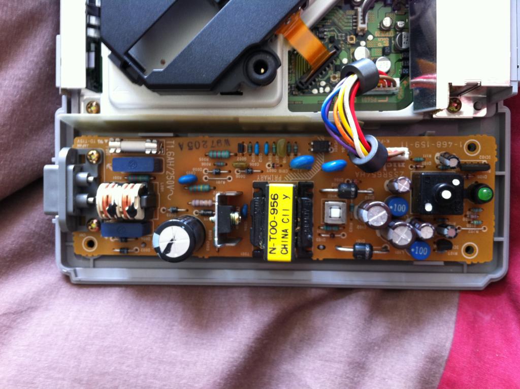

Okay i was able to bring my self to open her up. This thing is so easy to take apart, unlike a Xbox 360. Also no dust, it was totaly spotless in there.
Took some photos quickly, sorry im using my iPhone to do it as DSLR is on charge.
Not sure what version of the PSU i have but the PS is SPCH-1002. I didn't see a mod chip in there, i had a good roout around and took it down to nothing. Safe to say back togther it still works so it's past the Pete opens it and kills it test!
So mods. PSU is a dead easy and quick simple one which i might try if i can find some wires. Just to extend it so it's outside of the unit it's self. I can cut the currently cable in half and extend it.
Idealy i want a new PSU for it in it's own box but not got a clue on that!
I fancy modding the case, spray it is the number one thing thats going to be done but i seen a few people with there RCA on top and caps but no other info, anyone shead some light on it?
