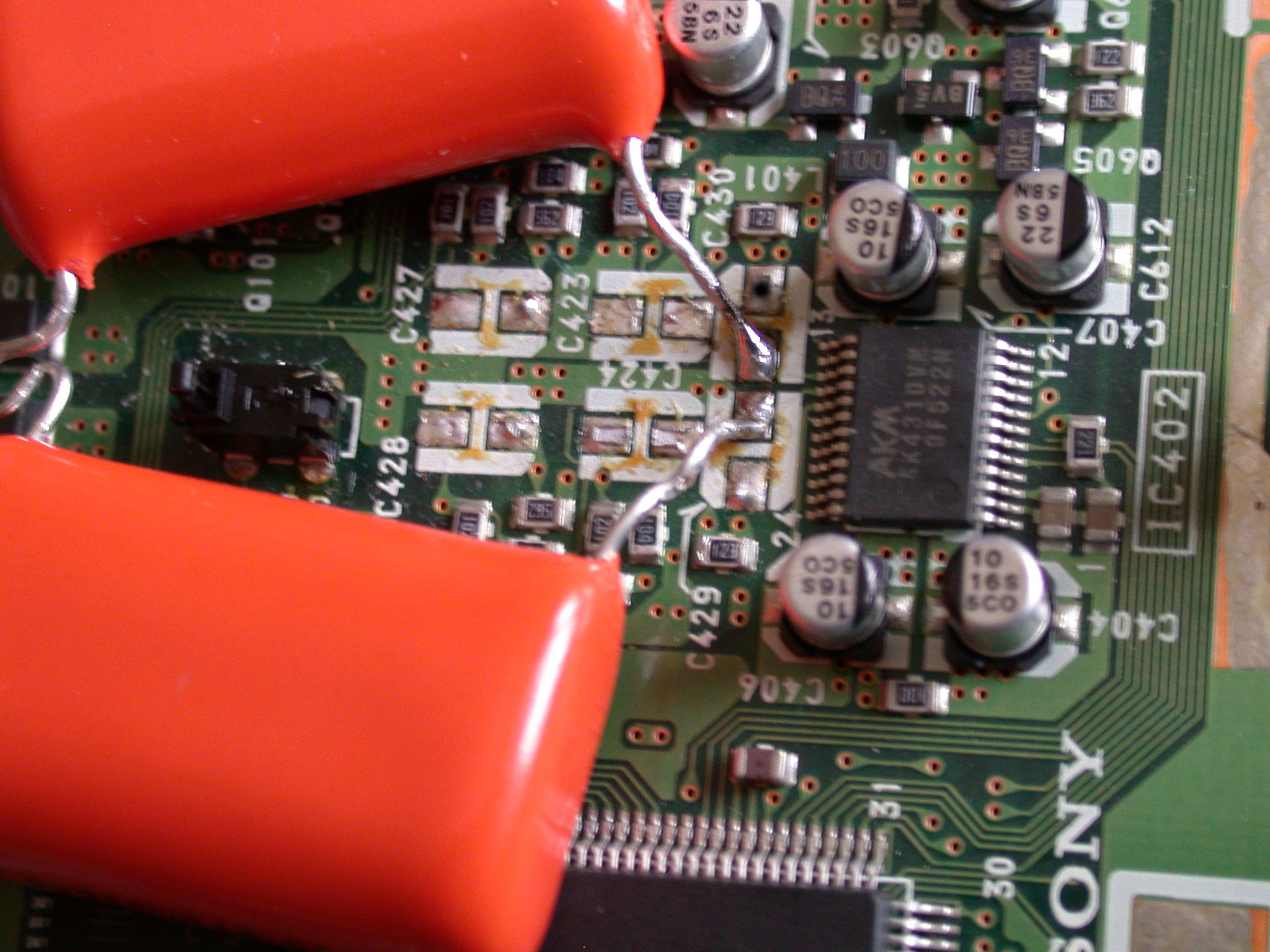

OK so I tried Mick's mods using 2.2uf caps specified at 100v but 250v actually written on them with 100k resistors.
The chip is the 4310.
The problem is distorted sound on the right channel only at a lowish volume.
I wonder if the caps should be a lower voltage and Mick says make 3 cuts but then only shows 2. Is there another cut somewhere or does he mean the removal of the smd cap is the 3rd cut?
