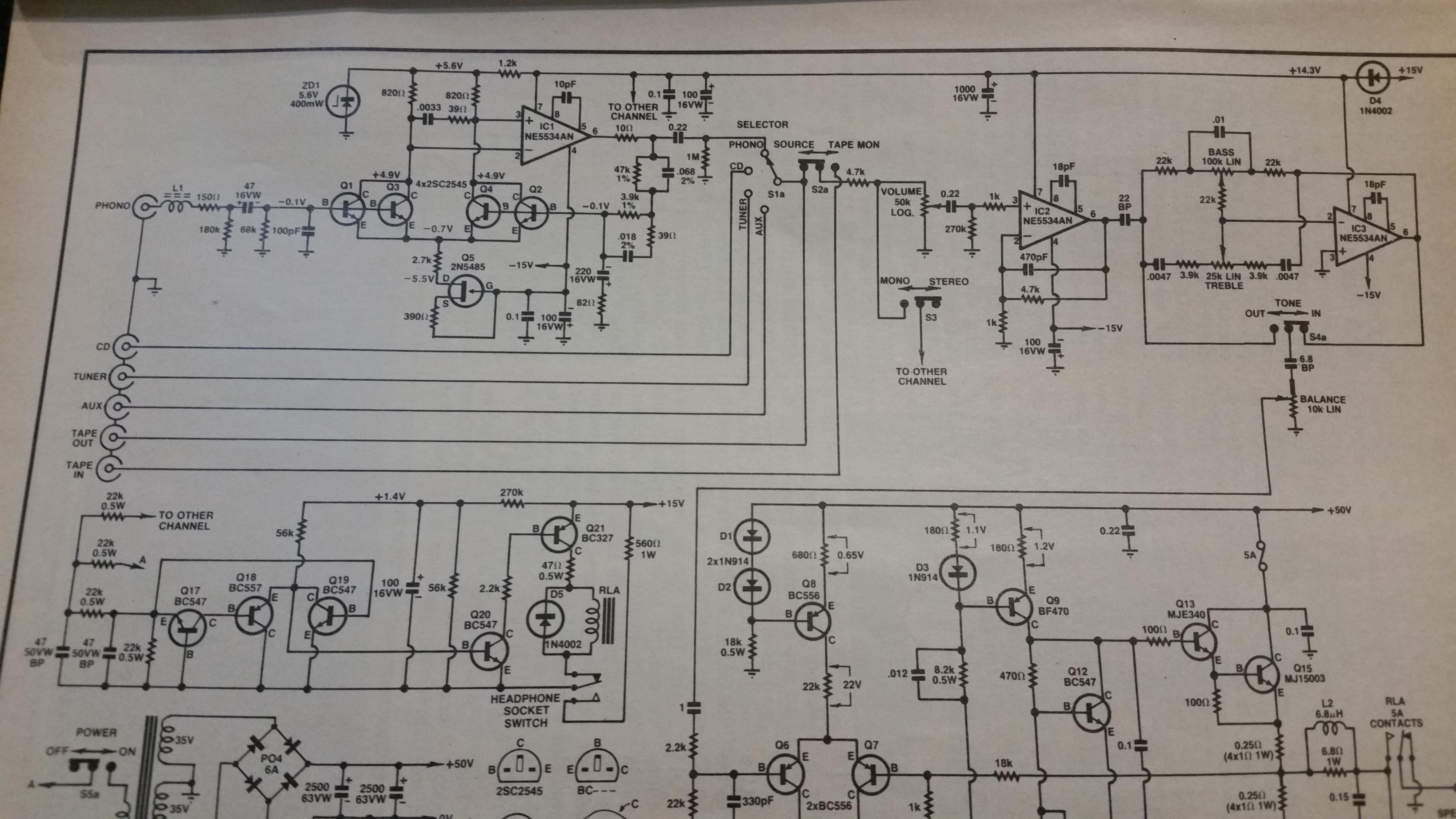

Hi glennb,
I'm Ken's son Graham doing some research for him on the Playmaster 60/60 "Blue Print limited edition" stereo amplifier. He says the tone circuits may have a fault and needs the schematics to fix it.

Was the "blue print edition" a re-do of the original design? I have the original schematic and have taken a photo of the preamp section if it is of help. It was in the June 1986 edition (part 2 of the article)
Since this is for a repair and this is only a partial of the full schematic I have attached.
Tony.
Tony.
