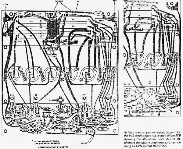

Hi Masood
I don't have artwork for those very old designs but you should be aware of the size of
Playmaster twin 25, 40/40 and 60/60 designs. They were integrated amplifiers. Their PCBs were quite large and laid out to include phono preamp. plus volume, balance and tone control circuits, in the basic style of ~ 40 years ago, using discrete, TL071 or later, NE5534A/AN OP-amps. The 60/60 for example, was a full rack case size, 42 x 24cm PCB IIRC, The others, about half the area but still substantial. Look at the pic. of the EA mosfet amp in Tiefbassuebertr's earlier post. That is the smallest board used by EA at the time.
If you are only seeking amplifier PCB designs, it would be better to do your own. Given the countless PCB designs you have been collecting on DIYaudio, this should be very simple for you and easy to improve on the originals at the same time.

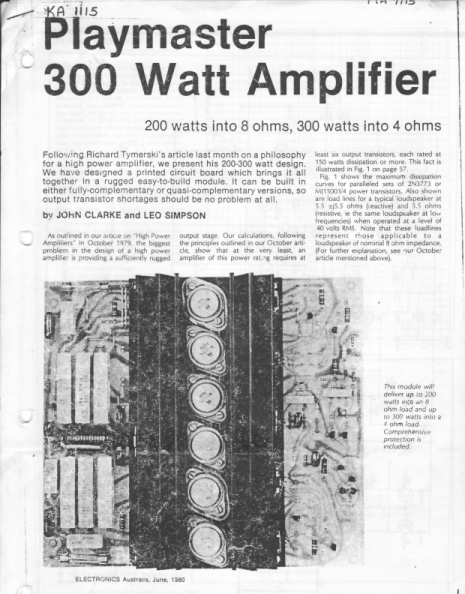

Hi guys. I have a Playmaster 60/60 that I built in about 1987. I recently got it out of the garage in order to hook up my old Thorens TD165 to trouble shoot a problem. I went looking for info on the web and came across this thread (yay internet!).
I found that the amp was making a huge amount of hash/noise when I powered it up. Then I recalled that the reason I put it away in the first place was that I had repeated failures with the NE5534AN op amps.
Initially I thought they might have damaged in the process of soldering them to the pcb, so I put sockets in all around. This did seem to solve the problem but the amp was still seemed to be prone to destroying the NE5534s. Is this something that anyone has come across before or could it be a fault with my amp? It seems that the op amps in the line level preamp and tone control circuit are the most prone to this issue, while the phono stage seems pretty bomb proof.
Thanks glennb for the EA scan, this will make any trouble shooting much easier!
By the way, my amp was a 'blueprint special edition' which means it has 1% metal film resistors, polyethylene and polyester caps, uprated philips output caps and an uprated transformer (raising output to around 70 watts into 8 ohms stereo I believe) and a swanky special edition silk screened front panel!
Anyway, I always thought the old girl sounded pretty good with my Thorens and a pair of Kef speakers.

Was the "blue print edition" a re-do of the original design? I have the original schematic and have taken a photo of the preamp section if it is of help. It was in the June 1986 edition (part 2 of the article)
Since this is for a repair and this is only a partial of the full schematic I have attached.
Tony.

Yes, Jaycar actually produced "blueprint" versions of a few EA and ETI magazine designs in the 1980s. The difference between these and standard versions of the 60-60 began as you say, in the supply of all 1/2W metal film resistors in lieu of 1/4W 5% carbon film types and the power supply caps which were Philips types - still working in my own amp, surprisingly.
I believe that the RIAA phono preamp resistors were also MF in the standard version which was supplied by a number of competing kit sellers. Other differences were in the supply of 'A' suffix opamps (guaranteed noise spec. versions of NE3334) which were otherwise skimped on to save a dollar, at the time. Oh yes, a thin blue surrounding line was also added to the front panel artwork. It looked OK if you then trimmed off the rack case ears to normal case dimensions for home use.
The transformer in blueprinted and also some standard kits, was a locally built "C core" type by Jones Transformers in Melbourne, I think. It was poorly assembled, had a strong enough stray magnetic field to cause the cover to sound like a screwdriver dropped on it when switched on and the bobbin required packing with shims to stop the vibrational hum/buzz on the several examples I either built or repaired over many years. I suspect that a standard EI type would have been a better choice, had there been a higher VA rated 35 +35VAC type available. Being imports, suitable toroids weren't competitive at the time.
A feature of the design is the simultaneous increase in dynamic range for transients and the SOA protection afforded by its poor transformer regulation. A stiff power supply would have meant SOA problems and this "sagging" supply rails technique was also exploited in a lot of Japanese products at the time. I think though, when a few niggles were ironed out of typical DIY kit builds, this probably stands as EA's best Hi-Fi production - noting its unusually good phono preamp, for the time. ;)
