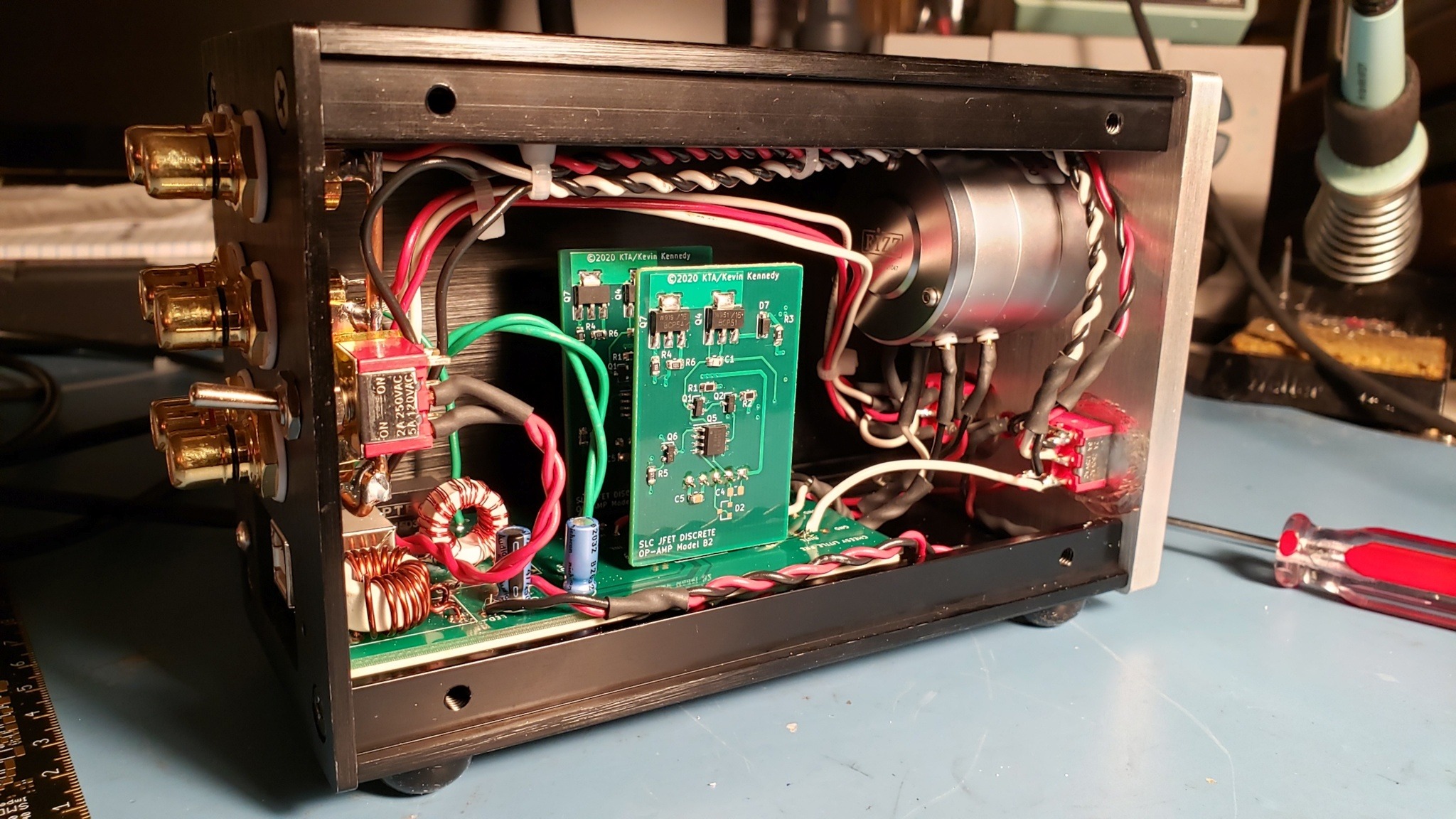

This is an example of one of my applications, this is a simple stereo line stage which is powered by a 100mA dc to dc converter 5V in and +/-15V out. Given the compact size a standard PSU would not have fit, and USB was convenient and available. DC power out is filtered by a common mode 3 wire choke, and the DC is pretty clean (a couple of mV at 25kHz), but there is a bit of radiation into surrounding wiring so I am going to try adding some shielding around the converter and chokes.

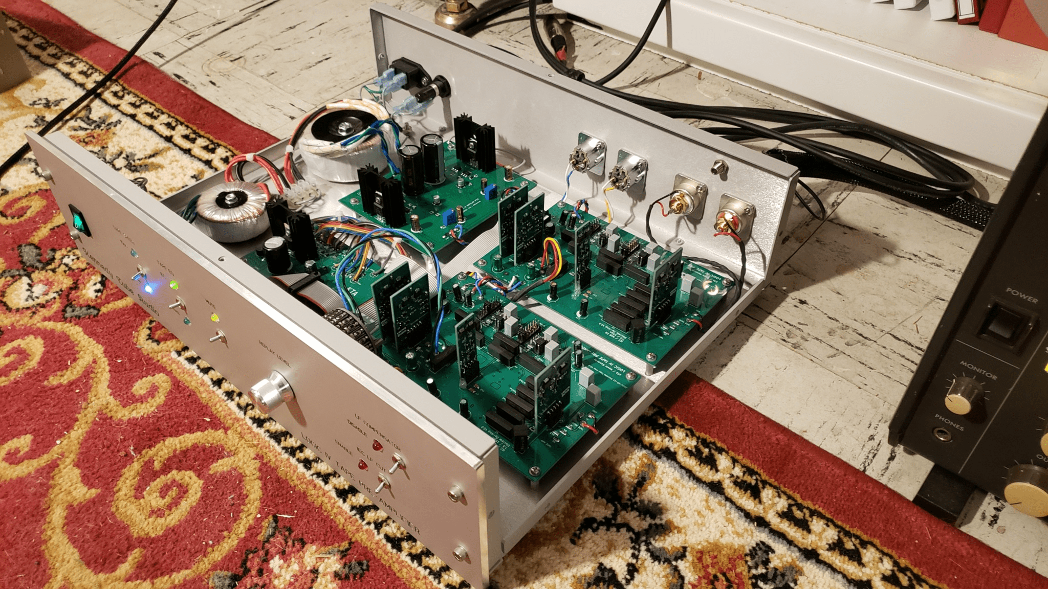

This is what all of these different op-amps were destined for use in. This is my last R2R tape amp project, supports NAB and IEC EQ at 7.5 and 15ips.
