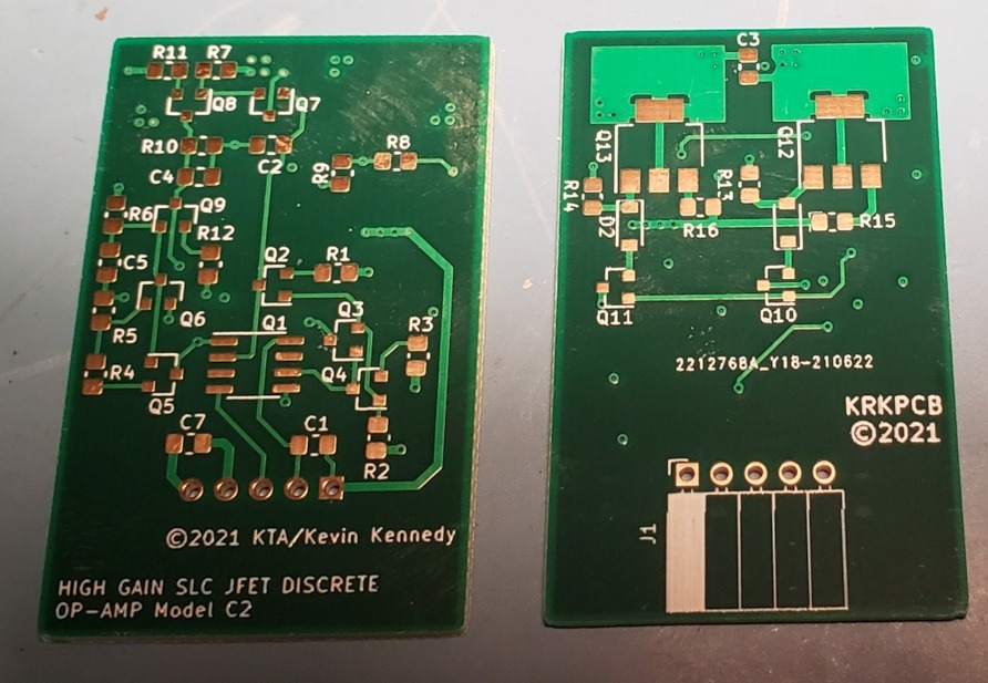

When I have a little bit of time over the holidays I will build up a pair of my TPC op-amp modules and do some measurements with my RTX-6001, I think Jens will enjoy this from several perspectives - it is the only device I have that is likely to meaningfully exceed the performance of these op-amps.
In the mean time I have a version I have not shared here because it's simply the transconductance output design with my take of the diamond buffer appended, as I recall open loop gain is around 90dB or so.. Versions 3 and 4 (both here) have substantially more loop gain, but V3 relies on miller compensation and has a cascode tail CCS on the jfet front end, the V4 ditches the cascode tail and adds TPC.
Thank you for all of the feedback and commentary, I'm learning - lots of good thoughts and suggestions for me to study. Talking of such what are people's thoughts on the cascode tail CCS - benefit or waste of a transistor? What benefits beyond common mode behavior, and is this worthwhile given the inherent imbalances in this matched pair, when is it enough?
I am happy to report I will be mailing a pair of blank boards to an interested member in a few days, and still have one more pair to hand out if anyone is interested.

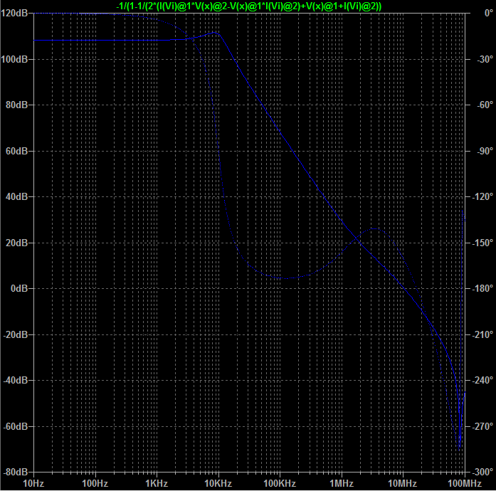

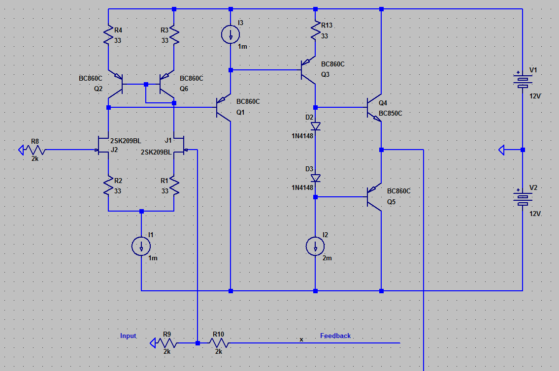

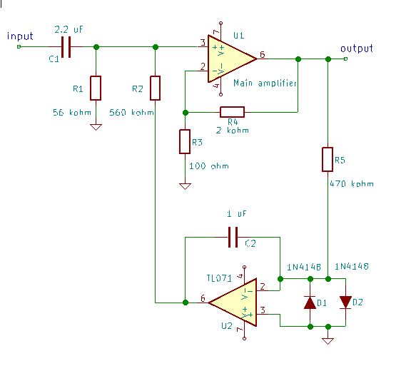

First image named "Simple" shows a schematic of a simple amplifier with a gain of 1. And second image, named "Without correction", shows its Bode plot. As you can understand it will be unstable.
First way to make it stable is Miller capacitance inserted around Q1+Q3 stage (usually named as Beta-enhanced VAS, but let's talk about later).

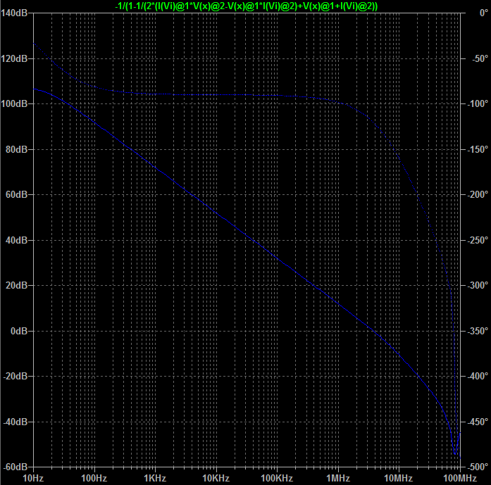

Let me doesn't show sch and go straight to Bode plot.
It's represented in the image named "100p" and it's ugly.
Doing this we just loose 60 dB of feedback depth at 20 kHz with tha same THD rise. This is exaxtly what is named "harsh transistor sounding".

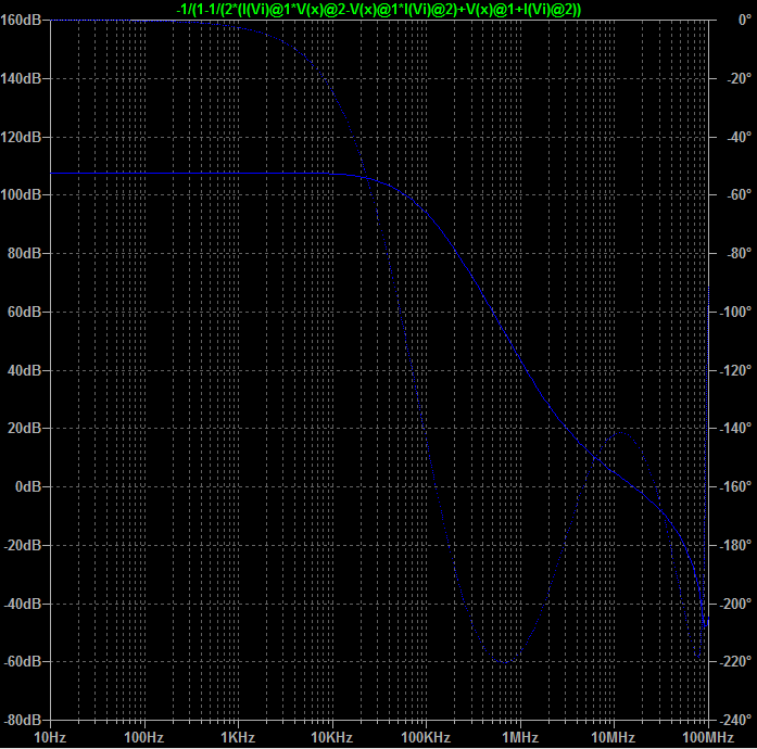

Ok, let's try second order around VAS.
Corresponding Bode plot image is named 47p-1k-47p. This is a CRC nominals settled around VAS.
Wow, we can keep mostly all feedback depth at 20 kHz. Perfect!
Some optimisation are needed, but it's a unity gain and must be coorrected at needed external gain.
But what exactly we do? Not only feedback around VAS. Really this circuit must be seen as four stage amplifier and just try to understand this as two high-impedance points. First high-impedance point are placed between Q2 collector and J2 drain while second are placed between Q3 collector and I2 current source.
47p-1k-47p circuit not only provide feedback path around Q1+Q3 VAS. It also shunts the impedance of the both high-impedance points.
And while first of the high impedance point are stable (because it's signal them amplified around 1000x times in the second point) the last point have not only shunted. It's also loaded at changing capacitance of the last follower stage.

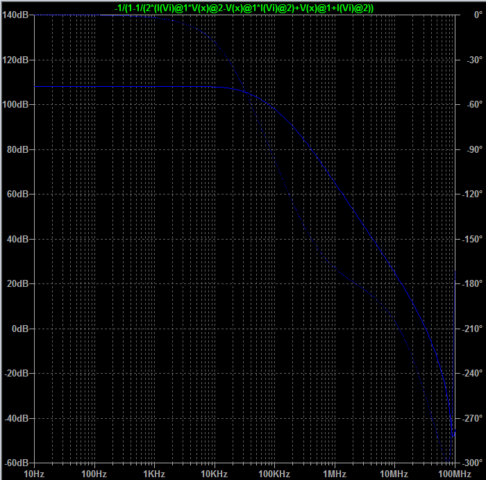

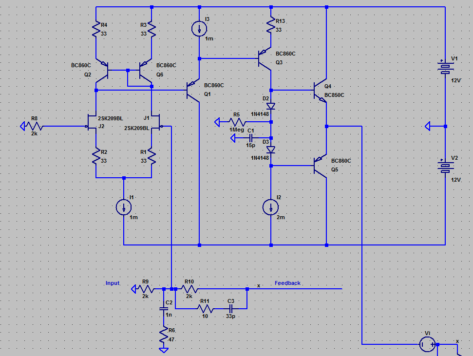

Let's try not to shunt VAS.
Schematic are shown in the image named "higher order_SCH" and corrsponding Bode plot in the image "higher order".
What do we see here. Firstly - much more HF gain, at least 20 dB feedback depth at 200 kHz which result mainly in a way less intermodulation distortion.
Second - a way better stability margins at a comparable unity-gain frequency.
Third - VAS load impedance dominated by known and intrinsically stable values (IPS output can also be stabilized, yes)
Fourth - OPS distortion are also accounted and corrected because all feedback are taken from the output.
That is i vote for.

Your last Bode plot goes deep into the zone of conditional stability. Nyquist is perfectly happy, but as I mentioned above, what are the real-world consequences under large-signal conditions? Is there some mysterious subjective impact of radical shifts in group delay across the frequency spectrum? I know of a fellow who would be happy to show you many, many graphs purporting to prove there is, LOL.

I have PCBs on the way for a composite headphone amplifier with THS4021 and a follower OPS with CCS load, so I will be evaluating this approach that you mentioned quite a few times. I am interested to see how it will go. In the same order are PCBs for hpasternack's headphone amplifier and that PCB also seems spacious enough for some modifications should I feel any desire to investigate the compensation aspect further.
I was also thinking about designing a discrete or hybrid OPA with JFET input transistors (but mainly for measurement purposes) so I will keep an eye on this thread as well. I can't open the .asc file in "attachment(2).zip" on my Mac, but I will try on my Windows machine.
Ah, yes, this is a common thoughts.
Bode graph shows openloop behaviour while being closed there are virtually no any phase impact.
Ok, let me know.
There are nothing special and even "Tian probe" from LTspice tutorial files directory can be modified for this.

Hi Greg and Ken, I have packed a pair of blank boards for each of you, included the schematic and a bill of materials with some notes and my off forum contact information if you have questions. I am hoping to mail them this week from the local post office, but will definitely do it after Christmas. Sorry that I am taking so long to get them out to you guys, it's been a busy and bumpy couple of months for us.
These are the last version with two pole compensation.
I appreciate your curiosity and look forward to your feedback, comments and suggestions if I decide to do another iteration.
I'll be building up a pair myself for use in the tape amplifier they were originally designed for.
I use some of the earlier ones as a buffers for older cassette decks that need about 10dB additional gain to match my system design levels (CD red book) and in a simplistic line stage.
This is the PCB for the latest version with two pole compensation. I think I need to wipe down my work surface.. LOL
The left photo is of the input and VAS stages, the diamond buffer output is on the other side as shown on the right. The op-amps are on 4 layer PCB.
