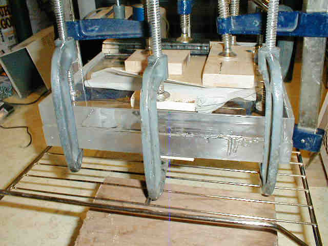

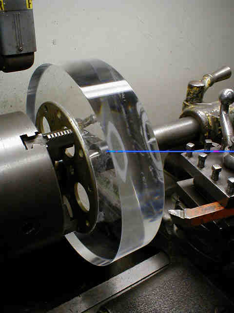

I started a DIY turntable project a few years ago and it hasn`t gotten any farther along yet. I began by fabricating a 2-1/2 inch thick platter out of two pieces of water clear 1-1/4 inch thick bullet proof plastic called Lexguard. These three images show lamination process using 2-part resin-hardner product called Behr `Super-Built 50`. Then the piece was cut in a circle on the bandsaw and mounted in the lathe secured with non-scratching double sided carpet tape between a plate and a small disc with live center. A 1/4 inch pin in the center of the chuck plate inserted slightly into a shallow centering hole drilled in the platter kept the whole thing securely centered. I had to face the right side and re-polish as the thickness of the Lexguard was far from uniform. I was really surprised by this actually! The finished platter runs absolutely true and is shown dropped onto the direct drive motor I was going to try to use which is currently part of my Technics TT.

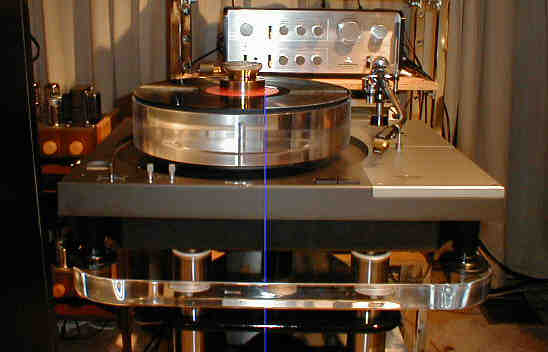

Yeah I made the brass center weight as well, and that turntable stand underneath that you just see the top of.

This is the norm with acrylic, polycarbonate, or any cast or extruded sheet. You must machine all surfaces to prove parallelism as well as perpendicularity with the bore of the platter.

rcavictim said:I had to face the right side and re-polish as the thickness of the Lexguard was far from uniform. I was really surprised by this actually!

I was going to use the controller as well as motor and bearing that is a package out of my Technics turntable shown, the SL-110A. I bought that unit new way back when.

No boss to worry about here. Actually I was fortunate to get the opportunity to dismantle and remove the front safety wall of a bank kiosk about 7 years ago in Toronto. It had been built no more than a year before and the institution was moving out of the building. I got maybe half a ton of this fine plastic in some pieces as large as 2x4 and 3x4 feet. I use it sparingly and only for those really special projects because at the price it costs, for my own projects I could never afford to go and buy any. I may make a subwoofer coffee table like the hi-fi version of Steve Deckert`s Wicked One, and use a large piece as the clear top.
This stuff is incredibly heavy and sonically dead. It would make awesome(ly expensive) speaker cabinets. It wouid make outstanding open baffles.

I've never had any problem achieving a good finish on Delrin - a slightly radiused cutter (rather than a point) makes it a lot easier though (as does exactly the right speed and feed).
I have also used the method used by Bob P. to mount items in the lathe - always worked well.
My experience of cast acrylic is also that it thickness across sheet varies significantly and all surfaces must be machined true.
