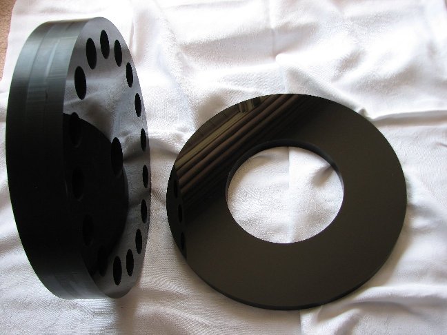

Platter in progress
Just though to take a few 'in progress' pictures of a platter made for the Teres bearing (Diagram posted earlier).
Photos show the two sub assemblies first part with 16 holes and second part is simple plate to cover after filling. Outside diameter will be finished after filling and assembly.
The dimensions are 12.25 OD and ID's to fit bearing. Depth at the moment is 4 layers of 0.75" acrylic ~3" which is slightly deeper than Teres bearig designed for, but I will adjust plinth height accordingly. Weight before filling 13lbs.
I'm still experimenting with how to make these in the easiest way. Next time I will make as one piece and will find a different way to add the fill into the cavities.
This time I'm using a DC motor without speed sensing so did not apply the Teres radial sensor markings.

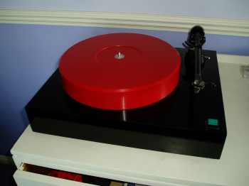

Hi.
Can anyone tell me were I can purchase a thick acrylic platter to work with the Teres bearing? Chris at Teres has none available.
Nice work Paul.I have been trying to source a platter with no success. I guess you made yours yourself.
Are their any plans available for this design?
Thanks for the kind words.
The motor was liberated from a deafunct dot-matrix printer many years ago. I have two of them and they are high quality and silent. No makers name though.
Its a "make it up as you go along" design, all done myself, bearing, platter, the lot.
Paul
Paul
Please tell us more. I'm facing the platter dilemma myself, though I've about decided to buy the Teres bearing.
Aengus
I would love to tell you more but there's not much more to tell! I found the vinyl slab in the workshop where I worked many years ago at the same time as deciding I could make my own TT. I "eyeball" engineered the lot, no drawings at all. The bearing was lapped to size and is an inverted design with a ball bearing and hardened insert in the shaft.
Its no work of art but it works great and I have the satisfaction of having done it myself.
Paul
Edit: forgot to say its based on more mass is better and is very heavy!
Paul
