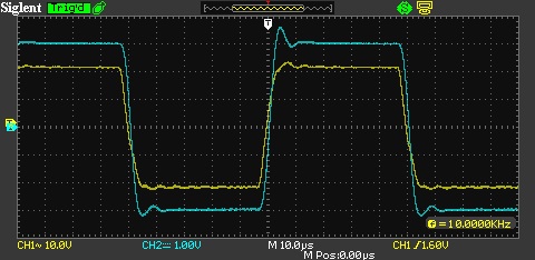

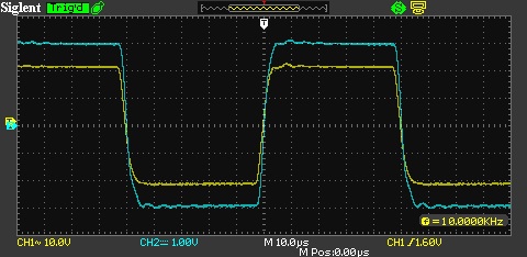

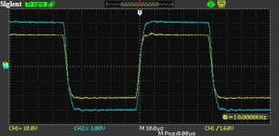

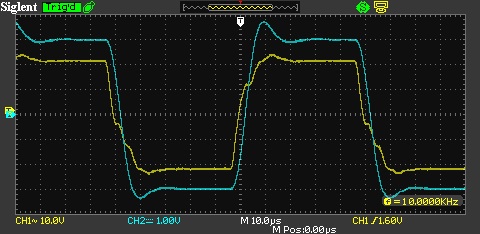

I wasn't able to provoke any instability in the amplifier. I tried everything I could think of including high frequency square waves, low frequencies down to like 8Hz, and various capacitive loads in parallel with the 8 Ohm dummy load. I left it with no beads installed.
I have attached some of the 10 kHz square wave testing results. Yellow is the waveform on the primary, blue is the waveform on the secondary. Overall bandwidth of the amp is set by the Jensen input transformer, so I can't easily make the edges any sharper. The input transformer is essential to the phase splitting in this amp. Kinda blows my mind that these edges could be sharper. This Plitron transformer has absurd bandwidth.
First is 8 Ohm resistive load only, second is 0.1uF in parallel, third is 0.47uF in parallel, and fourth is 2uF in parallel. The output stage seems to take some pretty nasty loads like a champ.
