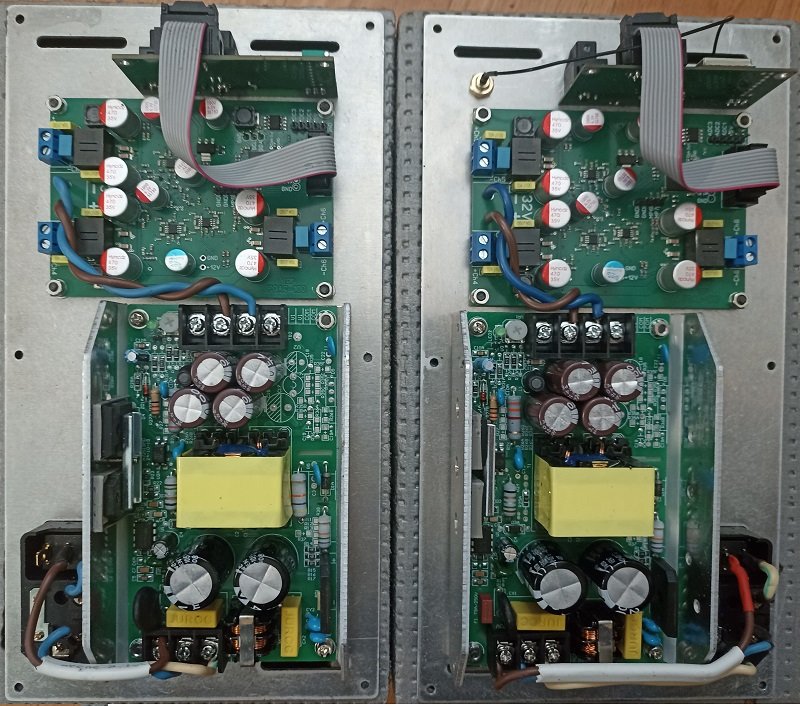

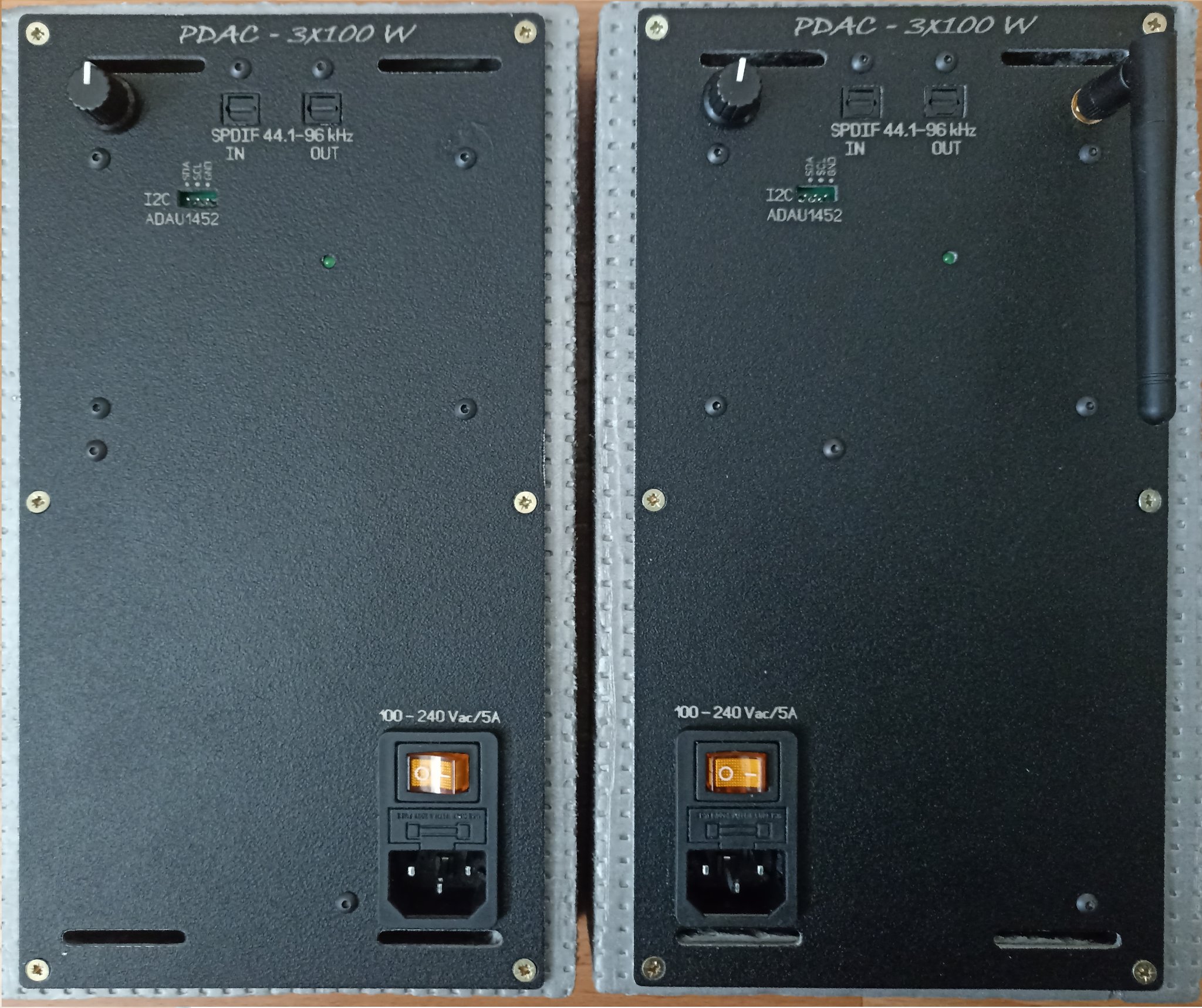

Two plates available.
I have assembled two more plates.
I don't plan to collect any more of these plates in the next two months.

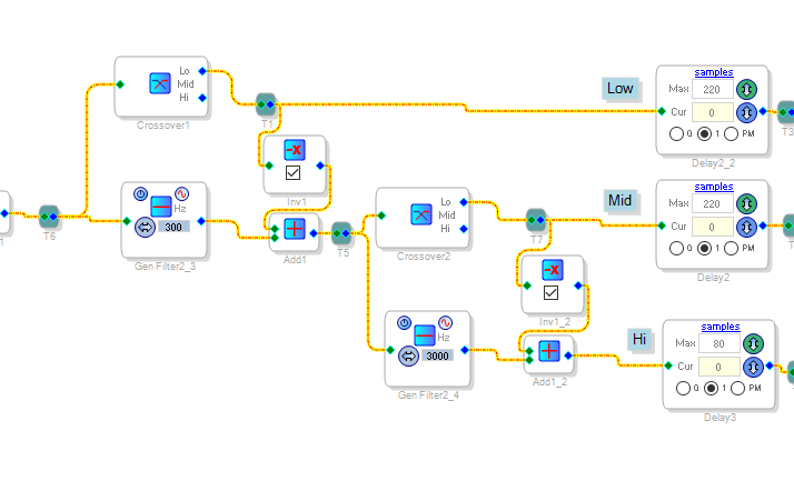

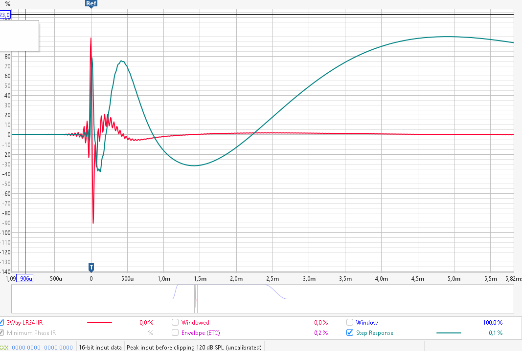

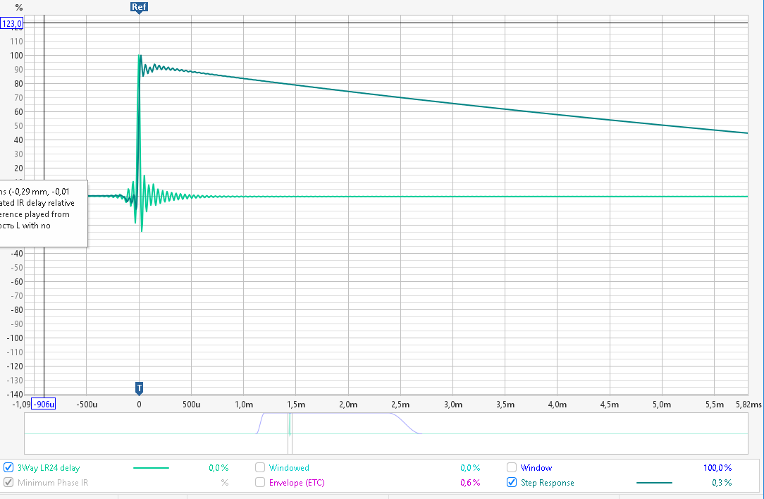

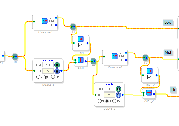

I implemented your proposal in Sigma Studio and it is more rational than the delay line.
It turned out that using the All Pass filter to compensate for the LR24 phase does not allow you to get a phase-linear filter.
Below is the result of measuring the impulse and the step response of the sum of three bands of the subtractive crossover LR24 with All Pass filter.
To obtain a linear phase of the sum of all three bands of the subtractive crossover, it is still necessary to compensate the phase using a delay line, this is the only way I was able to obtain a phase-linear crossover.
I updated the projects for Sigma Studio in the first post, now there are two types of subtractive crossovers with linear phase and non-linear phase.
