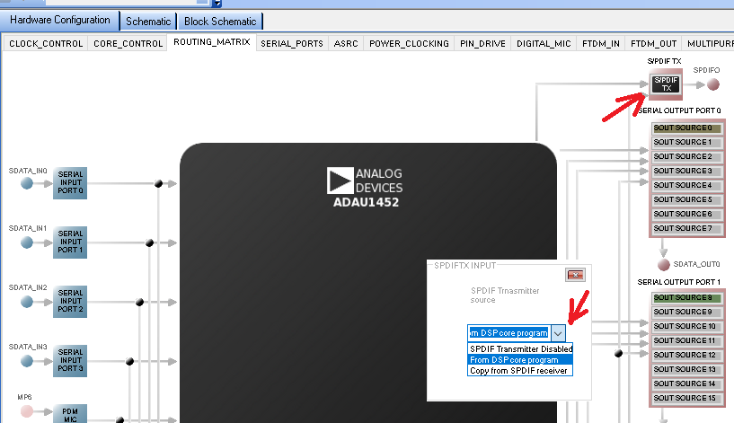

- I will try to find out what delay is needed for through-core SPDIF at 192kHz.

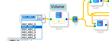

If you do not need volume control using an external potentiometer, then this block can be removed from the project.- When I simulate filters with slew, I get more phase distortion. Is slew needed on (not controlled) filters?
I believe less use of computing power would give less noise. The ADAU1452 has more power than I will need for a long time.
Slew in volume should stay, but I dont think slew in filters are necessary

Today I tested the plates and found a delay for 192 kHz. It turned out to be 54 samples.- I will try to find out what delay is needed for through-core SPDIF at 192kHz.
I updated the folder with files for Sigma Studio in the first post, a project at 192 kHz with the correct delay was added to the folder.

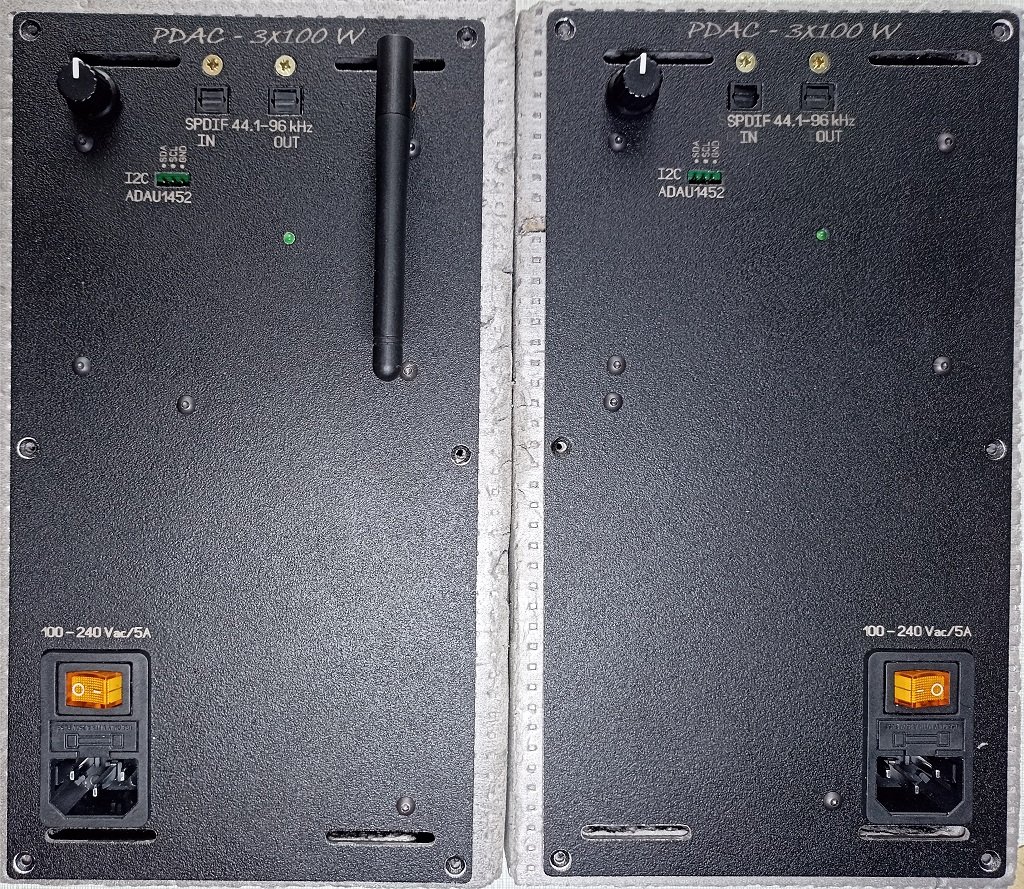

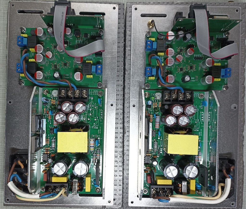

Two plates available.
I have assembled two more plates.
I don't plan to collect any more of these plates in the next two months.
Performance parameter:
• Output power: 100 W per channel, R load = 4 Ohms.
• Speaker impedance: 4 - 8 Ohm (2Ohm – max 50W)
• Frequency response: 20Hz - 20kHz
• THD -3dB: less than 0.005% on 8Ohm load, and less than 0.01% on 4Ohm load
• SNR: 108dB(A)
• Spdif Input: 16-32bit 44.1-96kHz
• Spdif Output: 16-32bit 44.1-96kHz
• I2S Input: 16-32bit 44.1-192kHz
• Power supply: 100V-240V, 32V/11A
• Consumption power: Idle mode 15W, sleeping mode 4.5W
• Efficiency - 80%
The ADAU1452 are flashed with a starter program - 3Way FIR 48kHz. The folder with files for Sigma Studio is attached to the first message of this topic.

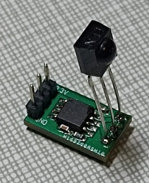

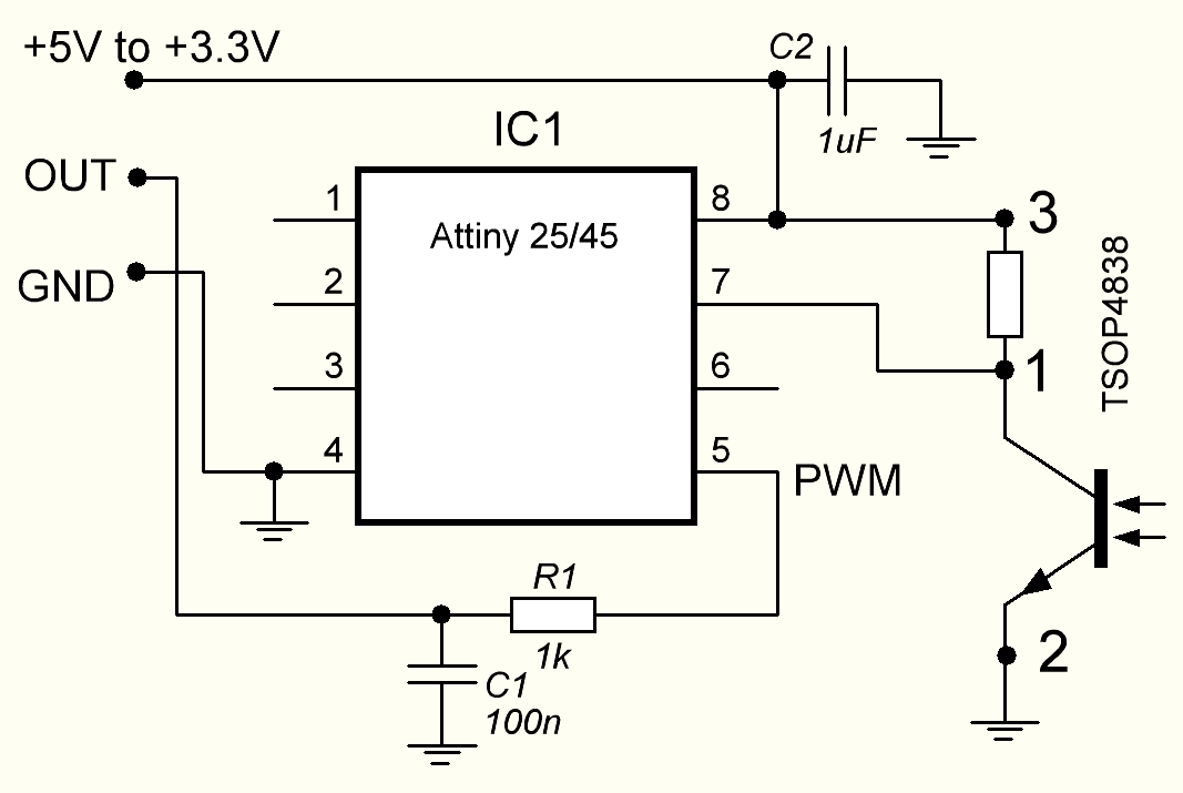

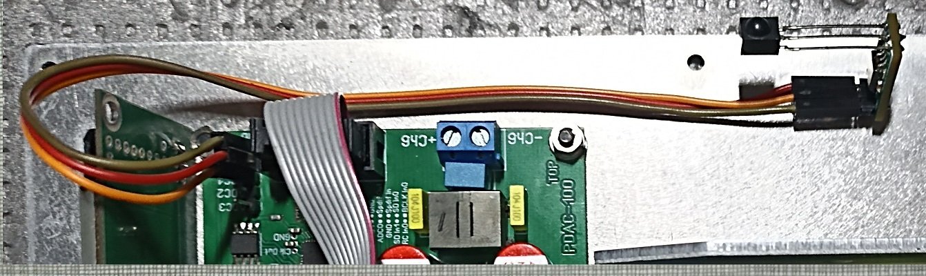

The plates come with a programmer on the CYC68013A chip and an optical receiver for remote volume control.
Those wishing to purchase such plates, write in private messages.
The price of the entire set is 390 US dollars.
Delivery to Europe and America is at my expense. Delivery to islands or other distant places is negotiated separately.
Payment via Payoneer.

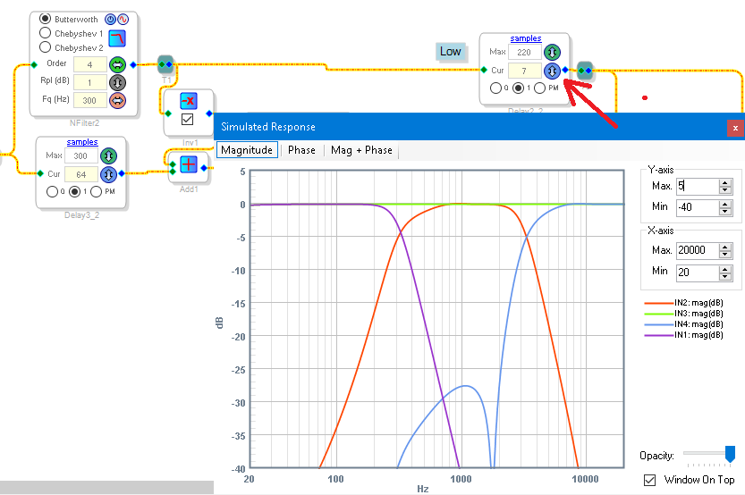

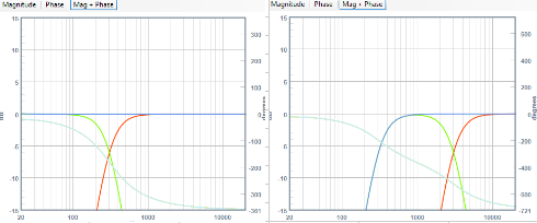

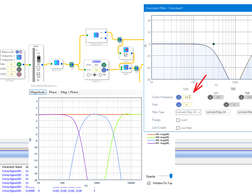

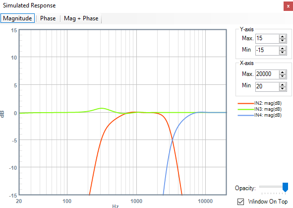

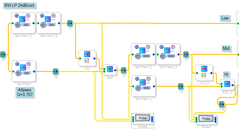

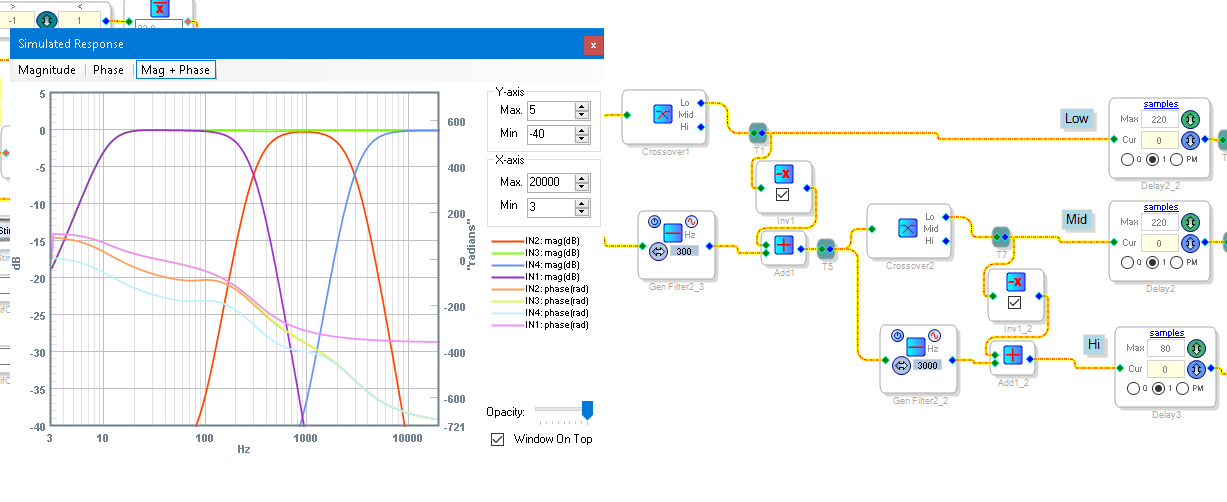

It turned out that using the All Pass filter to compensate for the LR24 phase does not allow you to get a phase-linear filter.I implemented your proposal in Sigma Studio and it is more rational than the delay line.
Below is the result of measuring the impulse and the step response of the sum of three bands of the subtractive crossover LR24 with All Pass filter.
To obtain a linear phase of the sum of all three bands of the subtractive crossover, it is still necessary to compensate the phase using a delay line, this is the only way I was able to obtain a phase-linear crossover.
I updated the projects for Sigma Studio in the first post, now there are two types of subtractive crossovers with linear phase and non-linear phase.
