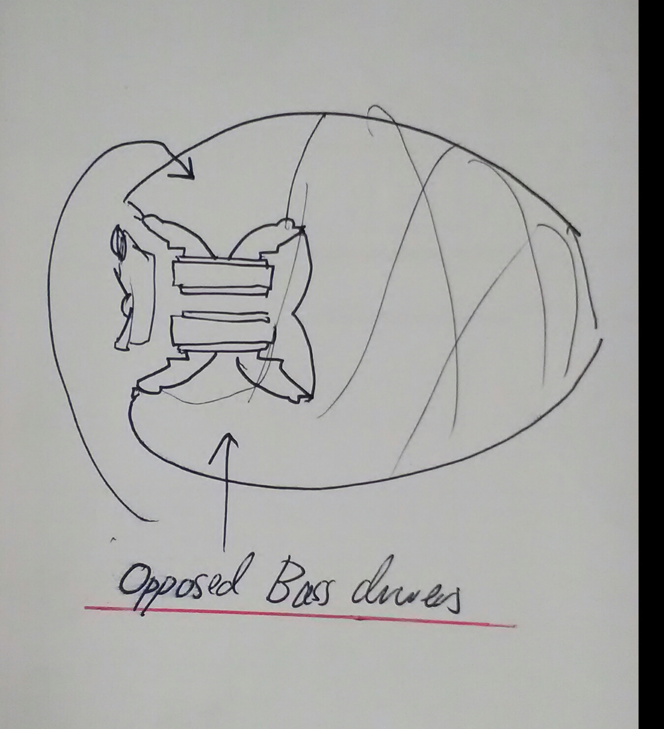

By coincidence, the Briggs polystyrene enclosure was 50 cm in diameter. The polystyrene walls were, understandably, 5 cm thick.The loudspeaker should get a spherical plastic housing (approx. 50cm diameter).

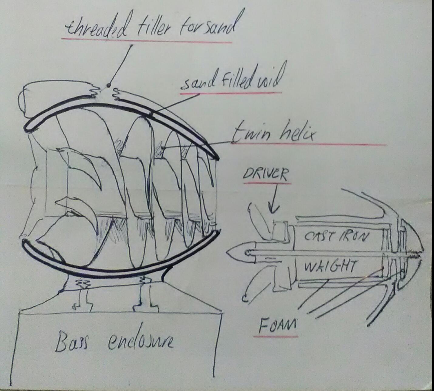

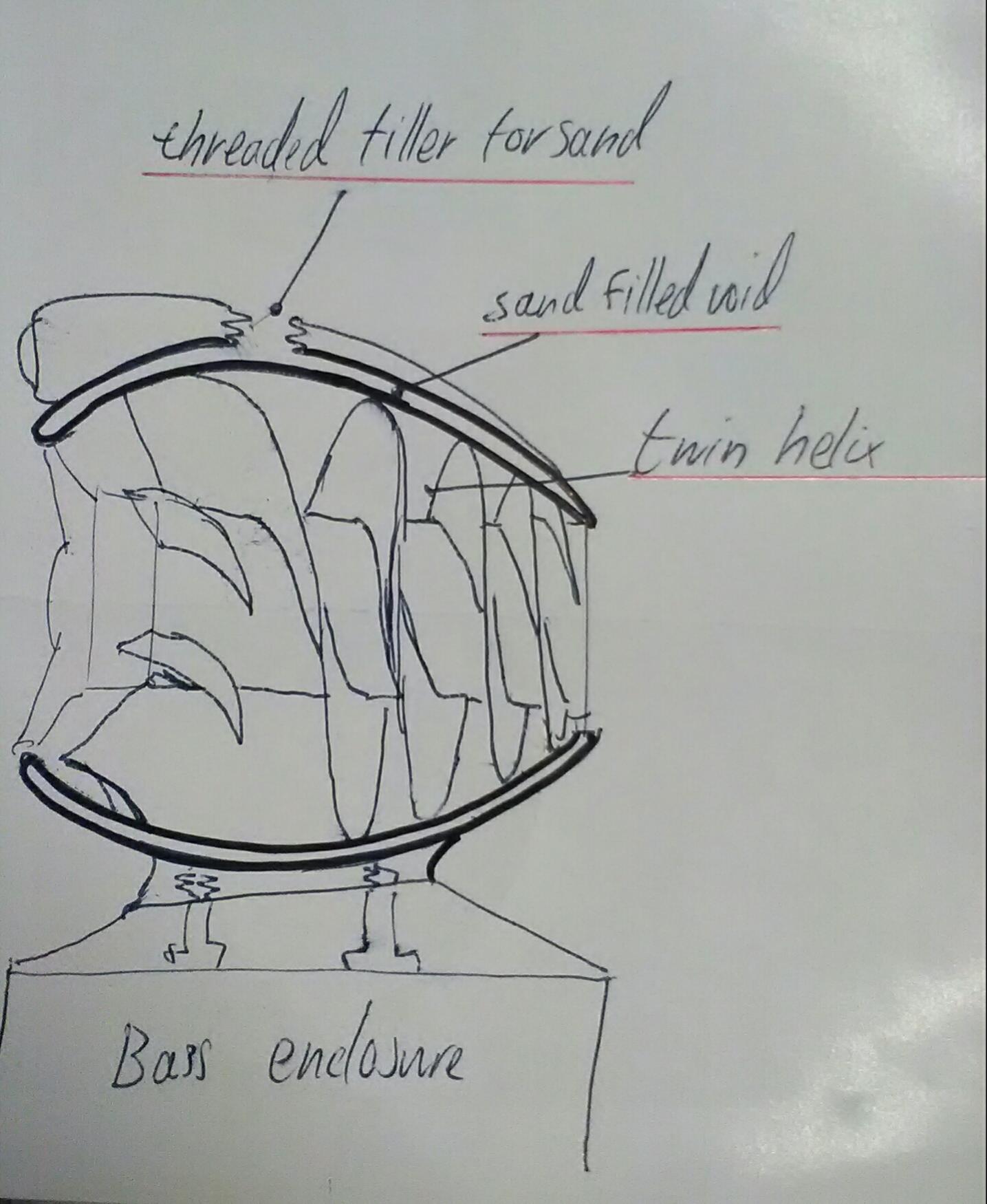

Here's an idea of a helix in a egg/sphere shape, the surface would have a double wall, the void in between filled with sand ( or possibly sand mixed with a rubber compound ), the helix would reduce internal echoes and also stiffen the structure. If you're going to 3d print something, you might as well let your imagination rip.
Here's a slightly better picture, if the driver used was a car coaxial, the tweeter could be removed, and the resulting hole through the pole piece/ magnet could be used to have a piece of studding going from a phase plug, through a cast iron weight ( that would be supported on foam for isolation ) and a hemispherical " nut " on the outside of the enclosure that would hold the assembly in place.

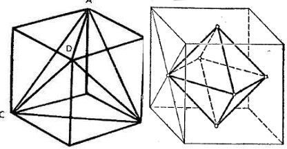

What shape will the yolk be in a square egg? It is important. Thinking about it is distracting and interferes with life.. 🙄 Is a tetrahedral or octahedral yolk better for a cubic egg?.. I wouldn´t be surprised at all them growing square eggs too.

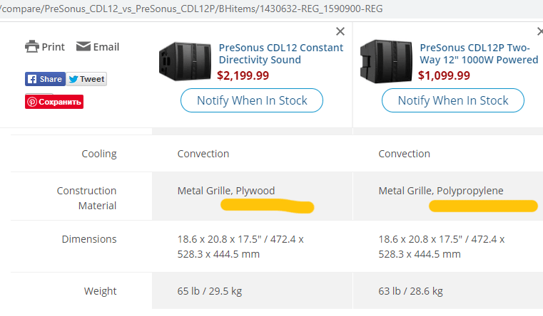

they don't specify the frequency range for the PP version
it would be very interesting to see some distortion measurements
they just mention a very similar peak SPL but not at which Hz an distortion
the price difference is huge
The price difference mostly is due to DSP and Dante networking, not to the enclosure material.
