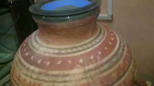

Old earthenware pot (the pores get filled up, so every year everybody buys a new one, and these get scrapped). Used as water storage here in India.
So yes your idea may work.
You can even use this as a former or shell if you want to make one in fiberglass.
New ones are $2 max. here..
Have fun.

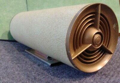

I also experimented with that in my teenage years!I did this once with 3" speakers on the open side of a cardboard tube left over from sticky tape. Put speaker on tube, and put it firing up on table...
In fact, commercial versions of the loudspeaker in tube idea were sold to connect to the earphone socket of small transistor radios to boost their volume.
Antique looking thing...how old is it?
And yes, big speakers sound nice if connected to lower rated amps, like in this case the pocket transistor would be low powered for the bigger speaker.
