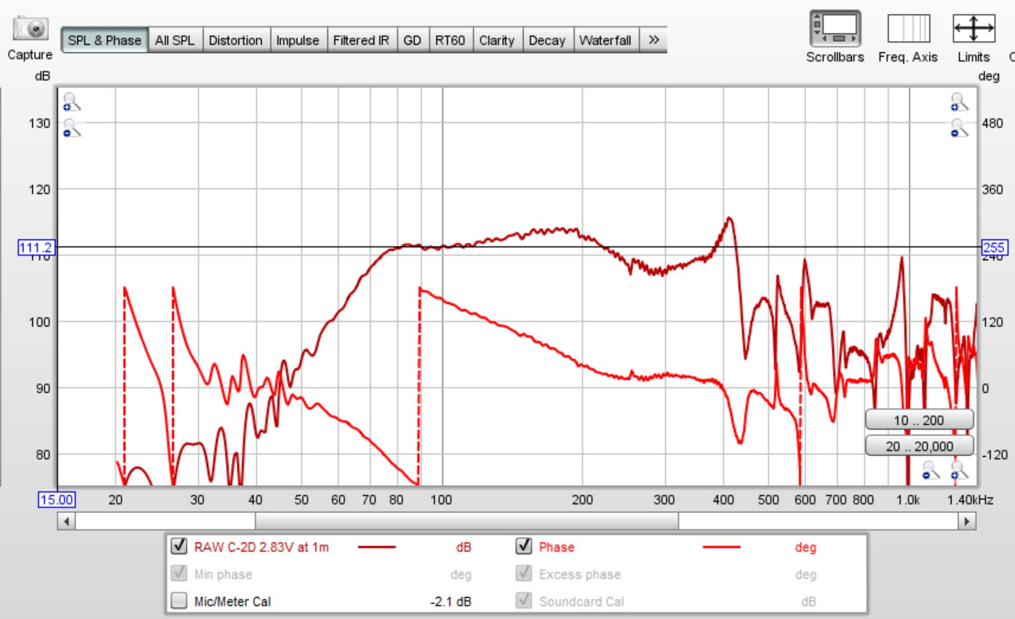

Compound loading 6th order quarterwave "Super Planar" horns and pipes concepts/builds
Here is a great thread about a parallel line of development with great results. Many great kickbins being built along these lines. Check out their facebook page for many more builds and results. Lots of measurements and reviews.
I checked this out and in my previous post (top of 3d page now) I linked 3x photos of their cab designs.
Do you have any input on these designs? The crappy drawing you produced (no offense) reminds me of their newest design (that I linked a picture of in my previous post) however the other two cab designs are both double 12 or double 15 designs, in particular, the one with side ports, one on each side with dual 15 looks pretty legitimate.. however from looking at things, it seems like the dual 12 would give more of a punch in the range I want plus would have cheaper drivers cuz its harder to find a high qms sub with low qes/qts in order to fit this type of cab design for a decent price.
So I'm more leaning towards that dual 12 or dual 15 design.. but they are trying to design these to be full range cabs? Ugh!

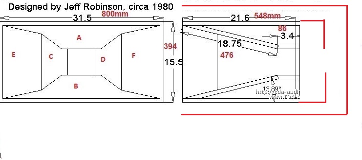

What you guys think about some kind of hybrid based on front loaded horn with rear LF chamber of Paraflex for Altec 416 and RCF L10? Something like new single Paraflex in 21 post.
I'm thinking to add rear chambers to Jeff Robinson midbass horn or to Altec 816A. Is it too crazy?

I'm thinking to add rear chambers to Jeff Robinson midbass horn. Is it too crazy?
You could add more volume to your rear chamber to make the cab utilize weaker motor force drivers.. thats the entire concept of the altec 816's, they have a large back chamber and large front chamber with horn path so they can utilize extremely weak motor force drivers... But why design a huge bin around the concept of using weak drivers when you could buy real drivers for the same price?

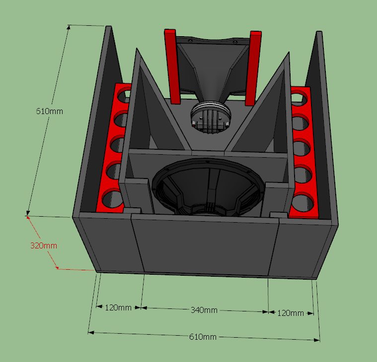

Martinsson's Blog - ROAR12
Here is a link to the original ROAR12 with a single B&C12PS100. This is just an example to show the overall layout.
The picture below is my first BIC+A4 "CAD" sketch of the design seen from above.
I am using the metric system but the 210 MBROAR would be 24 inch wide, 22 inch deep and 23 inch tall - if roughly translated to inch (610 mm wide, 550 mm deep, 590 mm height if built of 15 mm plywood).

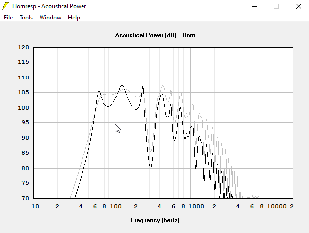

I guess loading this cabinet with two FPro 10HP1020 will have greater kick results and with some small tweakings, it can be a Dual purpose cab, stand-alone bass for small parties and Kick for larger setups. Having that 24" cube dimension and built in 15mm ply with proper handles can also be possible for a one man lift cab. 🙂
Black curve is with Faital Pro 10HP1020 and grey curve is with RCF L10-750YK.
I would prefer the RCF L10-750YK for a pure midbass application. If tuned a few Hz lower and with a slightly smaller cross section area then a pair of 10HP1020 would be quite formidable. There is always the risk of turbulence in the pipe sections with very high power density drivers like the 10HP1020. I would recommend substantial radiuses on all the edges within the ROAR box.

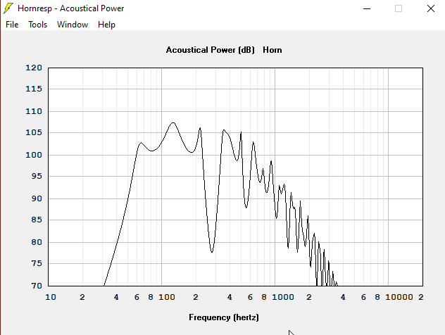

Oops, my assumption was wrong.
However, based on this HR driver comparison, can I say that modern cabinet designs doesn't necessarily have to be loaded with modern powerful drivers.
Here, I found another 10" driver which might be a good candidate for this KICK ROAR cab.
Note: Sorry, I'm using macbook so can't do hornresp.

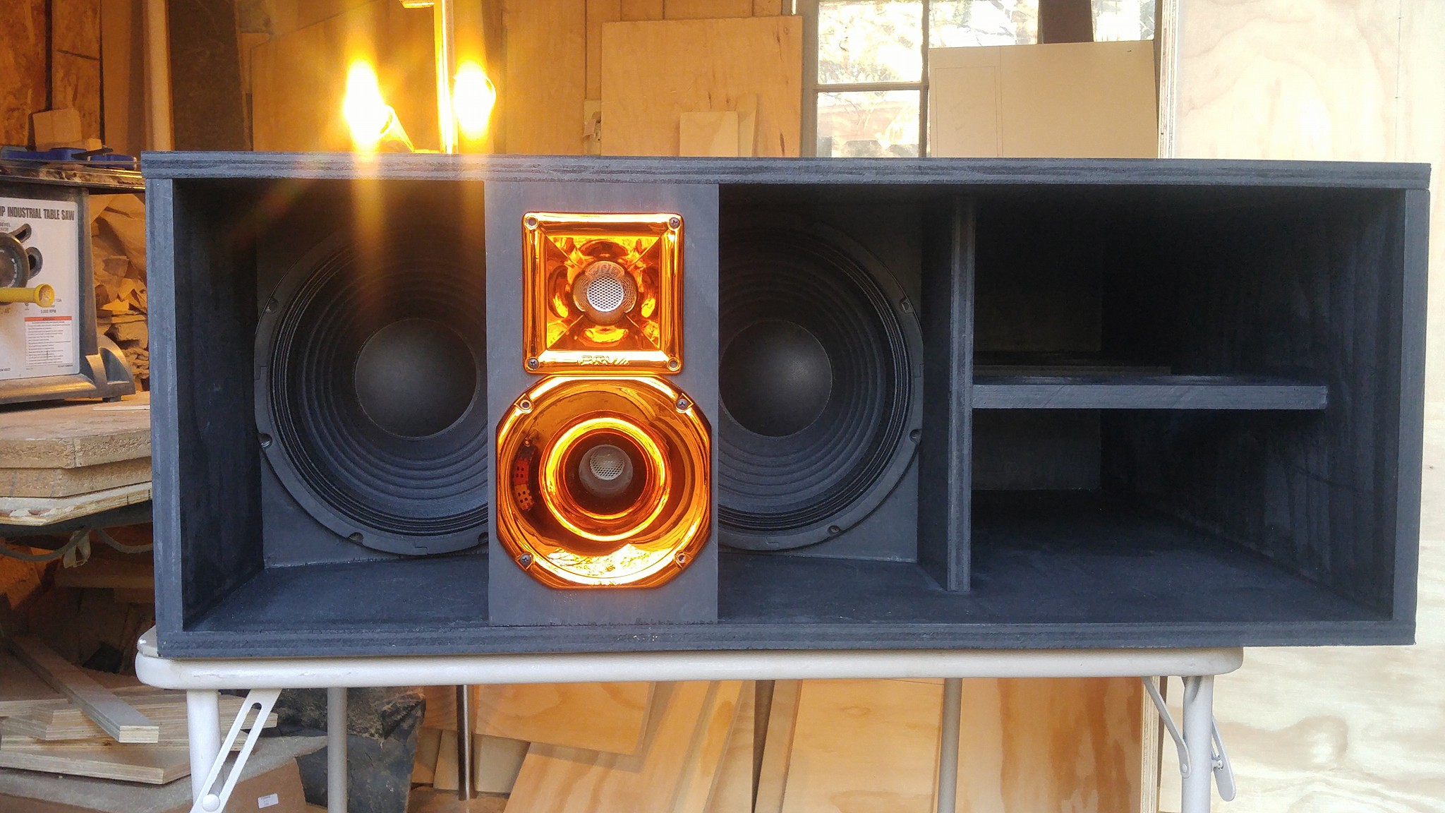

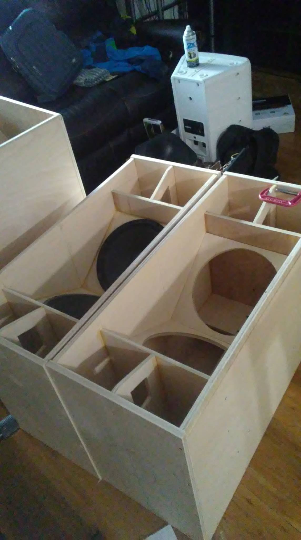

I'm building paraflex c-2d bins.
Bought 8x drivers for them.
Wow, hefty kicks there you building.
What kind of drivers have got there?
16F wide wall of kicks with 8x bins of those, sounds like it'll fit nicely ontop of my 18.3F wide wall of subs giving me a total of 66 inch tall between the two cabinets.
Using 8x Eminence 114489 15" drivers that have over 6 times the motor force of my previous kick bins drivers.
if your build is done, try to send in some pics of those 16F wide C-2D kicks and 18.3F wide subs. 🙂
