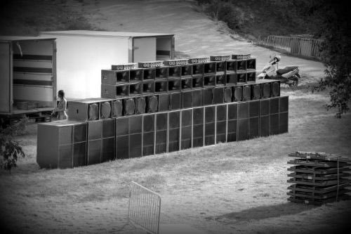

My source is certainly not only speakerplans. I'm a soundsystem veteran since 1996, played dancehall for about 15 years (i quiet the dancehall arround 2011) on different local sounds and i know the european scene inside out. Now i do a rootsreggae radioshow and still play roots and dub from time to time as guest selector. I also worked as sound engineer in the commercial circuit for years before my back killed that carreer.
And roots is not a small niche today, it's actually much bigger than dancehall soundsystems in Europe and the UK. A single stack (wich is 4 scoops + the asociated kicks, mids and tops) is considered a small sound, big sounds bring at least 2 stacks, and often 4 of more. When the real big names in continental roots & dub (like Blackboard Jungle or OBF or King Shiloh) come out full power then it's more like 4 or 5 stacks that are set, not 1. And with the big names in the UK it's often the same.
Dancehallsounds, but luv injection and some other older (like Saxon) don't have an own sound anymore, as they are mostly playing in clubs today. Robbo Ranx or David Rodigan, the 2 biggest names in dancehall in the UK next to Luv Injection and Saxon don't have a hardware sound. And the big names in continental Europe neighter. I worked for both David Rodigan and Robo Ranx in the past as sound engineer while they were performing in Europe, and they do know the basics about audio, but that's it. The real hardware part of soundsystem culture is a bit lost in the dancehall scene outside Jamaica.
But let's get back on topic. A straight kick horn will be to big or to high tuned for what the OP want. So i would use or vented or sealed boxes for those drivers. Sealed will be more punchy, vented will go lower. The choice is yours.
As illustration i added a picture of a big part of the stack of Blackboard Jungle, who are from Rouen (FR) but play all over Europe...
Edit: pic upload failed but it's fixed

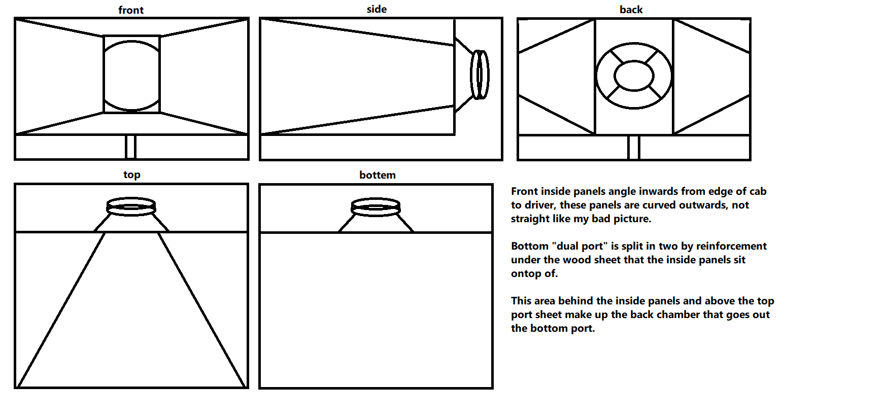

This is more or less what I was thinking about shape wise ... but... Is that a horn in the middle of it? I guess I could try to slim down that middle horn section since its not used as a back chamber, so I mean this could possibly work but more ideally I'd want a design I didn't need to remove large chunks of the cab in order to make work with dead unused space in the middle... I feel like theres a design that prob could make use of it through a center ported back chamber ether combined both coming out together or cut in half by putting a seperation board down the middle of it.
I already got what I would call "overkill" for my highs and mids so the horn is both unwanted and not required.
I purely need this as a kick bin, I don't need or want a design with a horn in it since I'm looking for kicks in peoples faces, not horns, lets be clear here, I don't need a full range cab but rather one that strictly is for kicks, not low mid vocals from 1k-3.5k or 3.5k to 20k for horn above it, I have all this sorted out already.
This is the right direction tho if you guys know of anything else like this but more kick focused.

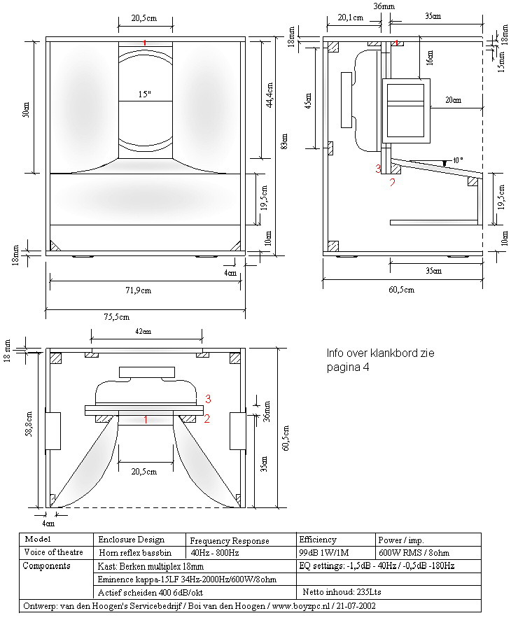

So I looked through the speaker plans a bit more and came cross this voice of theatre cab...
It looks pretty dang close to the altec 816's I already have, so it should be a close sound.
They are designed to use the kappa drivers I already have, they are 60mm deep by 72mm wide so they would fit perfectly ontop of my 18s.
So far this seems like the best design however I'd still really like to find a dual-12 or dual-15 design that fits across two subs instead of having to make one for one.

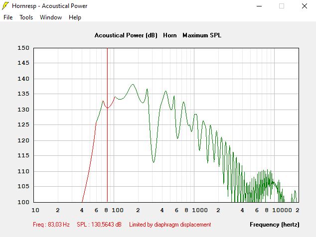

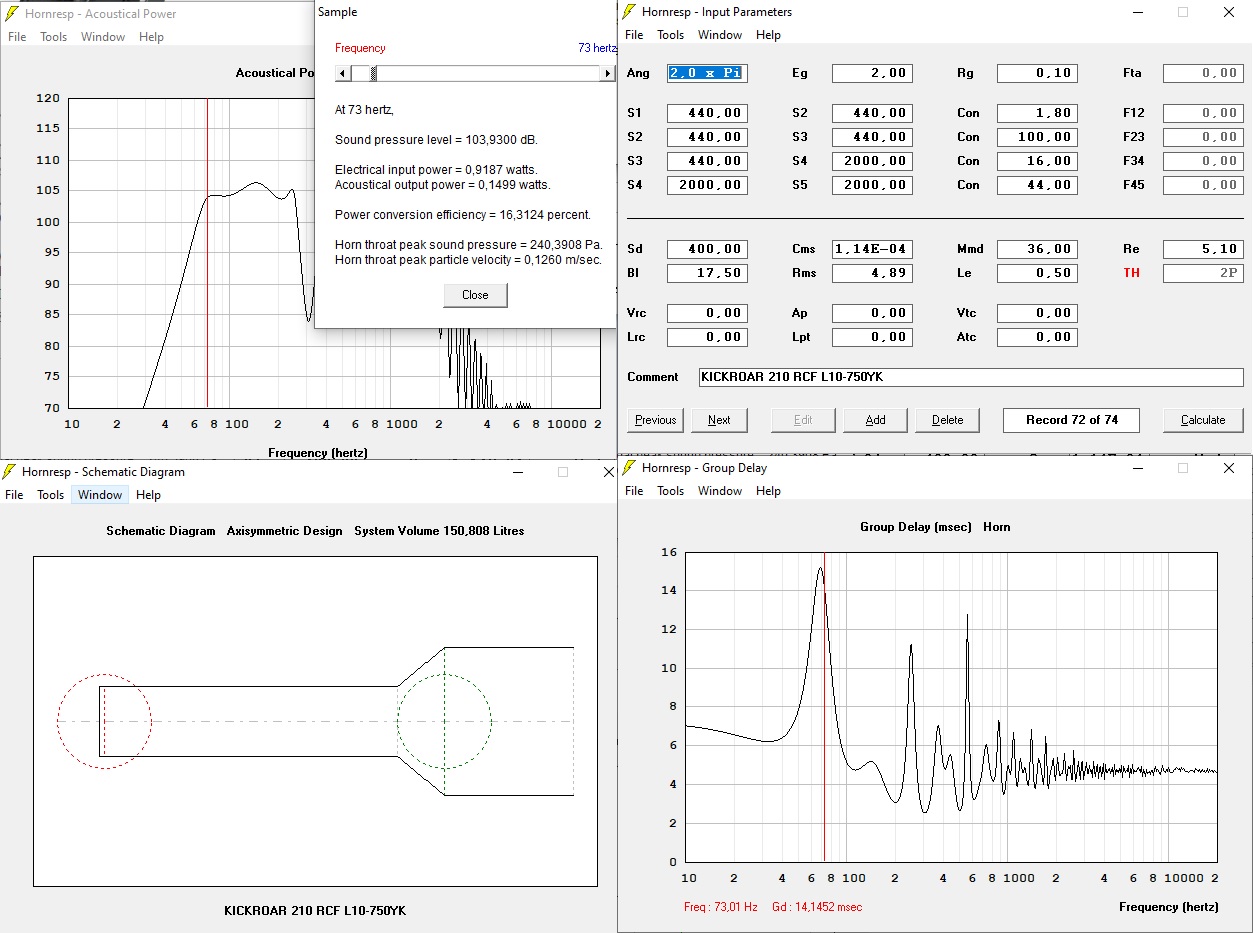

Here is a small midbass ROAR-like design based on two RCF L10-750YK drivers per channel.
I have "cheated" a little when simulated the max spl based on my experience with several ROAR builds.
We have never managed to push any driver in any ROAR-design to exceed xmax yet - and we have tried! So I calculated this max spl with 5 mm xmax despite the drivers 3,0 xmax rating.
Hornresp does not seem to calculate cone excursion correct in this type of enclosure at high power levels. I could not get my B&C 12PS100 to exceed 8 mm cone excursion with a single channel from a Powersoft K10 amp (2000 watts) despite my best try, bass heavy EDM and no subsonic/HP filter.

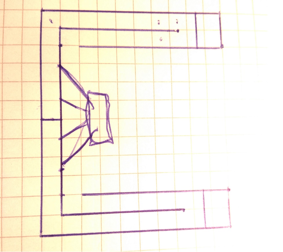

The picture below is my first BIC+A4 "CAD" sketch of the design seen from above.
I am using the metric system but the 210 MBROAR would be 24 inch wide, 22 inch deep and 23 inch tall - if roughly translated to inch (610 mm wide, 550 mm deep, 590 mm height if built of 15 mm plywood).

I donno man, I'm not sold on this, maybe show me some pictures of one? I'm not seeing the benefits of this design over the theater of sound design. Also not a huge fan of looking into a cab to see the back of the driver tbh.
And thats a HUGE dip at 300ish hz tbh I'm looking at the altec a7's, the theator of sound cabs and they are pretty flat till 800hz with no big dips like that... currently I'm running the altec 816's from 80-1k but I've also ran them 50-200 as more of a sub cab, they have options..... those roar12 cabs seem to only be good from 80-200.
That is as expected. Since this is a rather radical departure from normal (dogmatic) loudspeaker design practice and not many people understand the underlying principles behind this design - I can´t blame you in any way.
I just wanted to throw this idea out there in the off chance that you wanted to test the leading edge forefront of loudspeaker development regardless of what some Forum Knights of the Status Quo (I don´t mean you) say is a reasonable and sound design.
What you could do is eliminate the cavity of the compression horn which, will make the box smaller in height. Or, eliminate the cavity of the compression horn and make the mouths of the kick bin longer. The second option will allow the kick to play even louder. The bigger the mouth, the louder the sound. Thats how all horns work.
GreenSpade said:I already got what I would call "overkill" for my highs and mids so the horn is both unwanted and not required.
