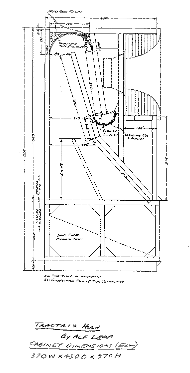

Hello,
I found a few comments on the "Alfredo" horn, a back-loaded Tractrix horn designed by Alf Lepp from Australia.
But I wasn't able to find the plans for it or to find conact dates or homepage fof Alf Lepp.
can anybody help me
many thnaks and regards
Thomas

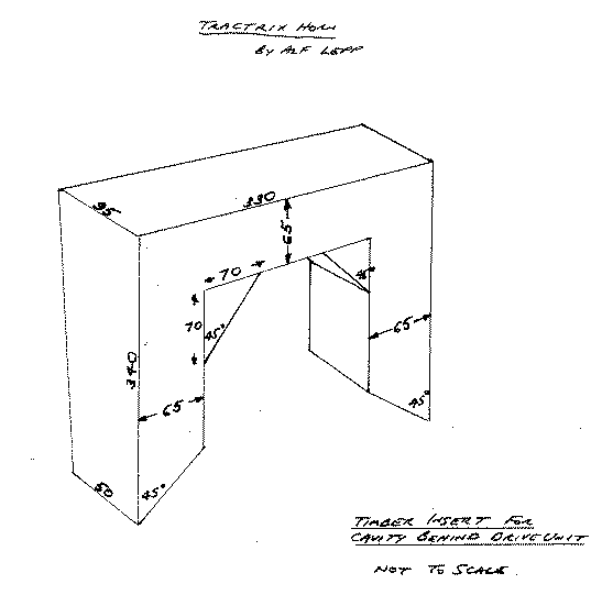

Not the best resolution, maybe somebody has something better.
Oliver, many thanks
it gives me an idea of the speaker; maybe somebody has ab better plan to be able to build it.

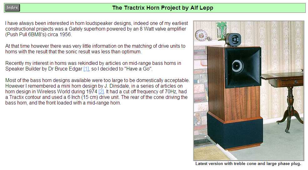

Well, this is where I got it from, but I have not been able to find the website again. Maybe there is more than one Alf Lepp? Maybe he build more than one speaker? 🙂

Hello Oliver,
Your design is an Alf Lepp design.
The Alfredo horn is another design.
According to Bert Doppenberg : one of the best for lowther dx3.

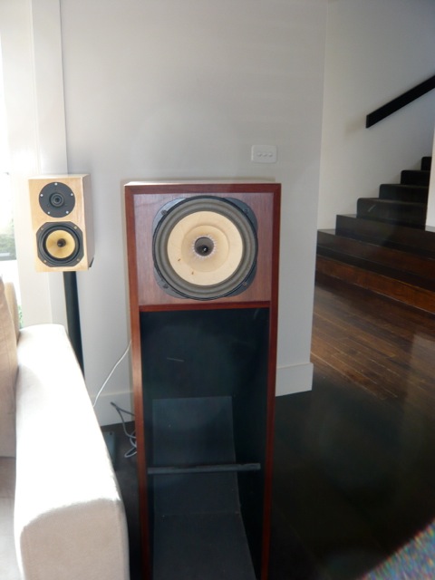

Hi everyone, I just noticed these posts and that there have been a number of comments about the Alfredo Horn and trying to contact Alf Lepp. I note that they are a year old, so you may not pick this up.
First the bad news, Alf passed away around 5 years ago. He lived a long life and was a brilliant engineer and craftsman. One of the greatest. I had the pleasure of growing up across the street from him and build loudspeakers with him for over 20 years. I have no doubt that Alf would be absolutely thrilled to hear that some of his designs are being discussed long after he was gone.
Now the news about the Alfredo Horns. I don't have any additional plans, however, they are currently sitting slightly wounded in my garage. As tends to happen with Lowther's one of the foam surrounds has decayed and cracked in one place. I can confirm that they average around 96 - 97db @1w/1m and like any other lowther that I have seen measured they were pretty bumpy above 5 kHz. While the measuring system we used wasn't the best below 100Hz, they were pretty useful down to about 50Hz. They used a Lowther PM6A Silver Speech coil unit.
I have attached a photo. Hope it is of interest to you.
Regards
Peter

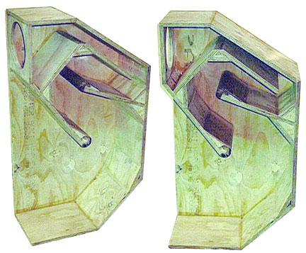

Certainly of interest. I have print-outs of the "wrong" alfredo horn, the one with both front and rear loading and they're about 12 years old. It helped feed my interest in horns. Good to hear some background about the designer.
The "right" alfredo horn looks great. The front is mostly mouth, like it should be. Doesn't look too complicated to build, either.

I have no more than i have posted already. Someone will need to redraw the plans from the picture, keeping the known dimensions the same and deriving the rest.
