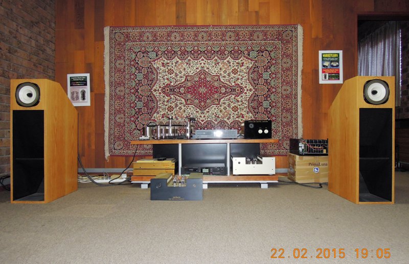

Here is the Alfredo Horn at my factory. The listening room is 6m x 5.5m (19.6ft x 18ft). This is the second and the last cabinet hand made and veneered by Alf Lepp who is sadly no longer with us.
Dave's Photo (Post 13) is the very first build of the Alfredo Horn. This photograph was taken by Alf in his garage which had tinted glass windows.
Alf brought the cabinets to my factory and together we experimented over a period of 3-4 months with diiferent chamber volumes and throat areas. The plans that Dave (Post 13) included in his post is the final version of the design. It is my handwriting "September, 1999" at the top right hand side of the plan. I had posted this on Bert's Forum.
Alf told me that the brains behind the design was Chris Powers, a brilliant and very clever engineer who has an interest in horns. Alf had obtained permission from Chris to use and develop this design. I tried to contact Chris who was busy downing Sasimi and Sushi.

The cabinet is made from 22mm thick soft plywood. I need to search for the plan showing the varying thicknesses and dimensions of the internal reflectors (numbered parts).
