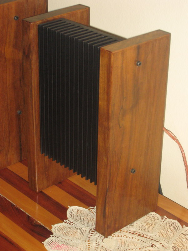

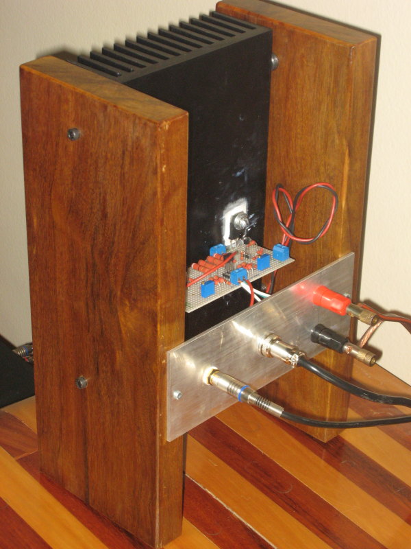

I thought I'd post an update. I have been listening to the F5 for several days now, without altering the bias, and it sounds great. I have decided that 56C is OK at least for the time being. As is visible in the photos I am attaching below, there is space to put more heatsinks in, once I can decide on how to do without spoiling the look of the amps, so I may do this at some later date - we will see.
I am considering a couple of tweaks: a thermistor between signal and safety earth (discussed earlier inthe thread but not done yet), and caps on the rectifier bridges to bring the noise floor (even further) down. (Anyone have a recommended value for the caps? I understand I can use one for each bridge across the AC inputs (right?) and I read somewhere on these forums that about 1 nF should be OK - I presume ceramic?) None of this is a major priority, though, as the sound is already excellent. I think this is by far the best of the projects I've done so far - many thanks to everyone who helped out, and of course special thanks to Nelson for making such a great design available to us.

njepitt said:One last one. This shows the space available for future heatsink addition. Some conencting wires need to be reduced a bit....

you can put on the back a black metal grid...
Thanks. I was thinking of something like that, yes, only I haven't found the "right" type of thing yet... No hurry really - there is no high voltage in the amps since the PSU is separate, so there is no real dangere to leaving them open for the time being.

On my F4, I used some small CPU heatsinks glued on with artic silver thermal epoxy.
I actually wondered about buying two shorter lengths of the same heatsink and gluing those on the back. This would still leave a smaller space to be covered with a grid or screen of some sort. It would guarantee a nice visual look, unfortunately it's not cheap....
I'll have to look and see if Mouser sell the epoxy you mention.
