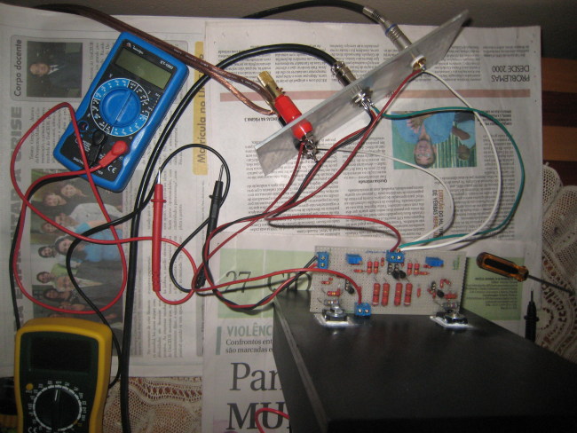

Yes, I use one for looking at output offset and the other for looking
at the DC across one of the Source resistors. When the offset is 0,
the other side will have the same current. This is particularly useful
if you have adjusted one of the Source resistors for lowest thd.

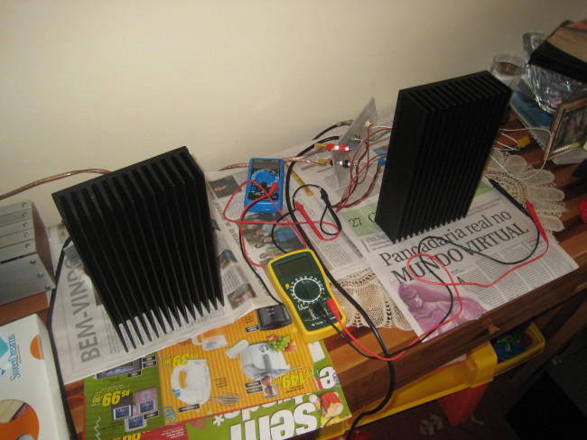

IT WORKS!
The title says it all, doesn't it? I took the afternoon off work and did the adjustment again, with the thermistors still in the circuit as before. I slowly raised the bias (with two multimeters, as everyone suggested) to about 0.54V across R11 and R12, over about an hour, at which point the heatsinks appeared to be more or less stable at 50 degrees C, and DC offset was less than 5mV (Seemed to fluctuate a bit, which I gather is normal. Ambient temp was about 25-26 degrees). I then hooked up speakers and so forth to see how the sound was. Initial reaction v. positive. I tried some piano, a little Marilyn Horne, and some string quartet beofre switching to Charles Mingus. After a while I started getting complaints about volume from - well, from just about everyone, really, so I turned everything off to let things cool down - I would like to check the bias with the amp cold next, and follow it as things warm up without any further adjustment.

This is how I did it (following suggestions o Babowana and Tea-Bag above), except I have not " adjusted one of the Source resistors for lowest thd". In fact, once the DC offset is at zero the multimeter gives slightly different voltages across the two resistors, presumably due to slight difference in resistor values. I suppose I could tweak this without too much trouble - I am thinking of testing a pile of resistors to match values. Is it worth it? I also don't know how to test for thd, and I don't have a scope. Is it possible without one?

Nelson Pass said:Yes, I use one for looking at output offset and the other for looking

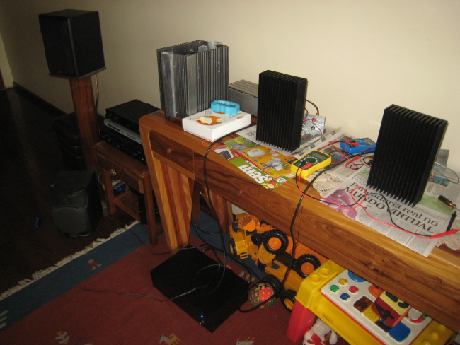

I'm posting a photo below of the test setup.
I'm guessing that's an expensive piece of kit my wife won't let me have. (On a slightly off-topic note, does anyone know of any linux software that would measure thd using line-in on the soundcard? I realise it probably wouldn't be fantastic, but at least interesting to play with?)

njepitt said:on the side
Very pretty side-TABLE.
And very bad manners to use it for other than flowers and table lamps, your spouse must be the forgiving breed.

Well, forgiving enough to look at it temporarily.... Permanently is another matter altogether..... 🙂

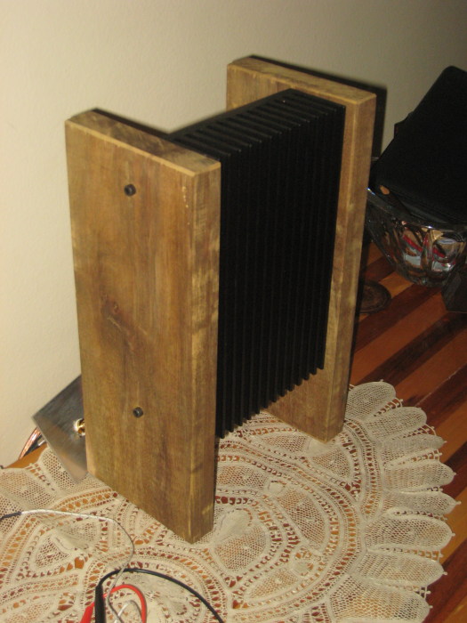

Here is a progress report, for those who are interested. Overall I am very pleased.
Each heatsink has been mounted between two vertical hardwood supports as shown in the photo below. The wood is "ipe", a brazilian tropical hardwood a good deal denser than water, which is perhaps not important in an amplifier except to counterbalance the weight of the heatsink. I have made no attempt to sand and finish the wood yet, so please don't think of the photo as showing a final version - it's there to illustrate some of the remarks I'll make below. Since the heatsinks are held four inches off the table there is ample space for air to enter below. They are held away from the wood by washers, which minimises contact betwen hot metal and wood. (Possibly I will change these for something a bit thicker to try to raise ventilation further still. I have spent a good deal of time today adjusting bias (still with the thermistors in the circuit) and listening to music - here are some remarks and a few questions.

4. I am little disappointed that the heatsinks reach 56 degrees C (with ambient at 27 or so, and bias at 0.56v across R11 and R12, which is just a little lower than the 0.6v recommended in the article). I am measuring this with a probe connected to the multimeter, pushed up between the fins on the heatsink so that it is directly behind one of the mosfets. I had hoped to have a temp at 50 or so. In the long F5 thread a temp of 50 is mentioned several times - is this measured in an equivalent way to what I am doing? Obviously a hand on the heatsink (as suggested) is going to sense the temp at the tips of the fins, which is probably a little less. On the other hand 56 degrees isn't too bad - am I worrying about nothing? (An extreme solution would be to rebuild the amps, cutting the heatsinks in two and remounting horizontally somehow. Not too keen on this, for obvious reasons...)

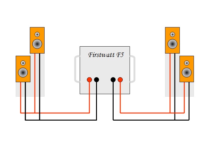

You know? These days I let my F5 drive four speakers (see the sketch). F5 doesn't feel any burden, and drives them very well. They are power hungry babies, 8ohms 84dB each.
Wow. I'm impressed. It never occurred to me to hook up more than two speakers. Do I understand correctly that you have simply wired them two each into the F5 outputs? And these are not separated by crossovers or something?

56C is not too bad, considering your heatsinks are too tall to be efficient.
....and 56C is nothing to worry about. I personally like to keep my heatsinks below 45C, but that's just for the very long term stability.
Your biggest issue would be that small children would go "ouch, maaaamyyyy", which really isn't an issue, as it keeps those little vandals from exploring the possibilities of messing with your amp 😀

Well, 56C is what it'll have to be. I read on another thread just now that 56C *close* to the mosfets is lower than Nelson accepts on one of the zens, so it can't be all that bad. Long term stability worries me a little, but there you go....
Small children are quite an issue in a house with four of them, but the one that is most trouble has already learned what "don't touch - hot!" means...
Yes, two are just paralled at each channel simply by wires.
Am I mad . . . ?
Am I mad . . . ?
Not if it works... 😎
